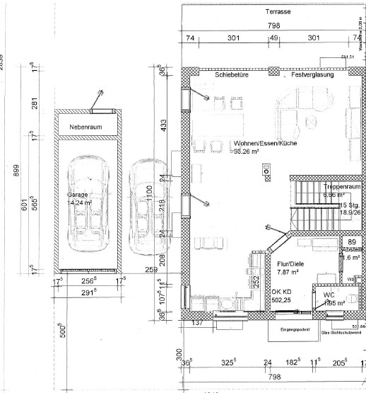

Hello fellow home builders,
I have been looking forward to this moment for a long time. The floor plan is about 90% finished, and I’m excited to share it here. I’m really curious about your opinions. You tend to keep tweaking things on your own, and since we don’t have many home builders among our friends, we really appreciate the feedback from this forum. Thanks in advance!
Two parking spaces in a garage are required. The other half of the semi-detached house is already built.
Plot Size
383 m² (4120 ft²)
Location
No slope, quiet new residential area
Number of Floors
2.5
Roof Type
Gable roof
Builder Requirements
Style, Roof Type, Building Type
Open, modern, semi-detached house
Basement, Floors
Basement (KG), ground floor (EG), upper floor (OG), attic (DG)
Number of Occupants, Age
3 people
Ages 35, 31, with baby
Room Requirements on Ground Floor and Upper Floor
Ground floor: living room, dining room, open kitchen, storage room, guest toilet
Upper floor: master bedroom, 2 children’s bedrooms, bathroom
Overnight Guests per Year
Often for longer periods, as the family lives far away
Architecture
+ Bright rooms with plenty of natural light, view of an undeveloped field
+ Modern, simple design
+ Open kitchen with kitchen island
Fireplace
No
Music/Stereo Wall
No
Balcony, Roof Terrace
No
Garage
Single garage with carport and an adjoining storage room for tools and bicycles. The building description requires two parking spaces/garages.
Utility Garden, Greenhouse
No
Other Wishes / Special Features / Daily Routine
KfW 55 energy standard, underfloor heating, air-source heat pump
The fireplace will still be removed from the floor plan.
Who designed the plan?
Civil engineer
What do you not like?
- Garage: Two garages are required. We have a Tiguan and find the garage too small. A double garage would be a pity as it would block daylight entering the living room. Therefore, we decided on a garage with a carport. Any other ideas?
- Kitchen windows are unclear. We are considering either a corner window or keeping it as is but making the window on the right between the kitchen island and the kitchen units floor-to-ceiling. The downside is the visibility from outside (pedestrians, etc.).
- Attic: Should it be an open space or two rooms – guest room and office?
Note: I slightly modified the doors on the upper floor with my modest Photoshop skills (angles). We plan to pass this change request to the designer. The exact angles are approximate. I hope it’s clear what we mean.
We look forward to your feedback.
THANK YOU ALL! 🙂

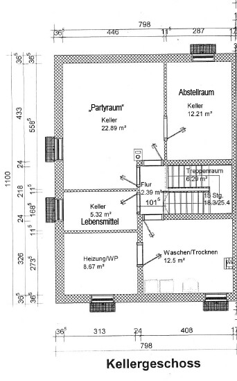

Basement floor plan with party room, storage room, laundry/drying room, and heating system
House floor plan with garage, terrace, living area, and staircase

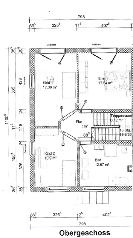

2D upper floor plan with master and children’s bedrooms, corridor and bathroom

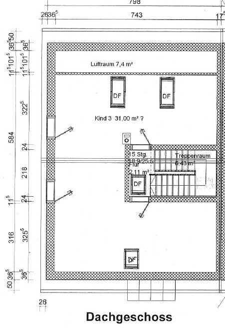

Attic floor plan with stairwell and rooms, architect’s drawing

We are still working on the preliminary floor plan. @ypg definitely gave us some valuable insights. Thanks! Quick question: Should we go with your left floor plan, and if we decide to have a door in the shower, it could be tricky with the pre-wall installation (or whatever it’s called) where the laundry chute is located. Are there any solutions for that? We’re visiting the show home exhibition again tomorrow.

I share a similar view to the others here. People often shower in the evening or early morning (at least we do), so there is usually no natural daylight anyway, especially not in winter. I would generally place the toilet closer to the door as well.

I would go with the one on the right!!!
The one on the left was my first thought, but then the right one grew on me.
Overall, I really like it.
I would find it very good for myself. Many people have issues with the toilet next to the bathtub, but I see a toilet seat and a cozy corner for bathing 😉
Cheers
