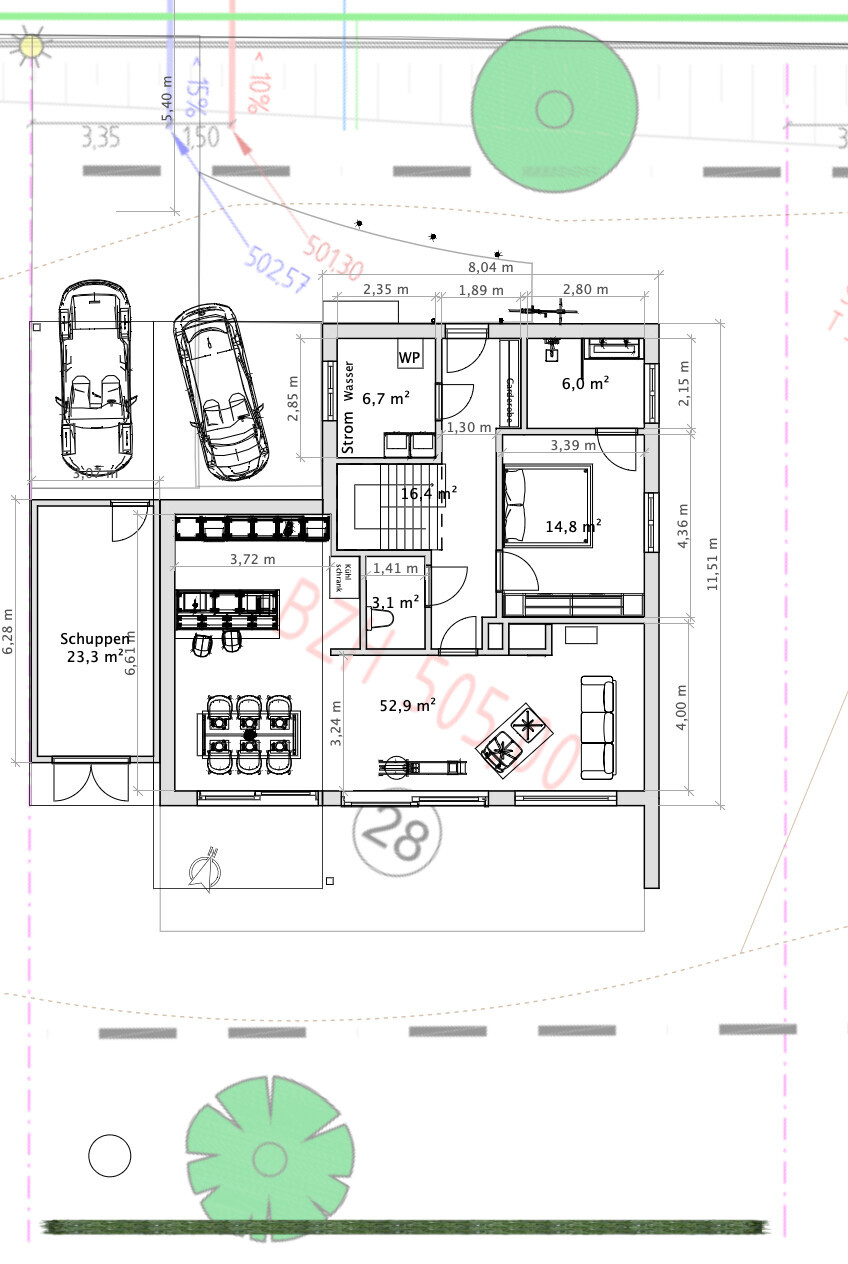

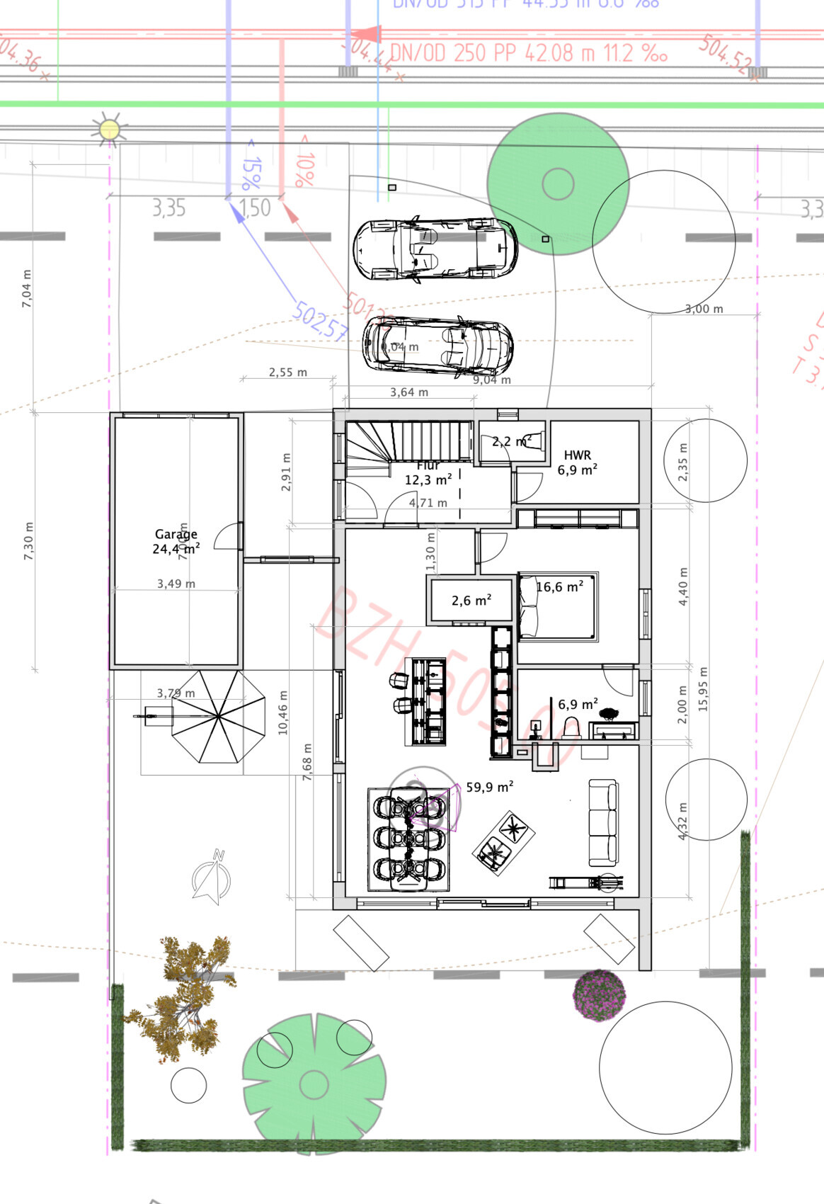

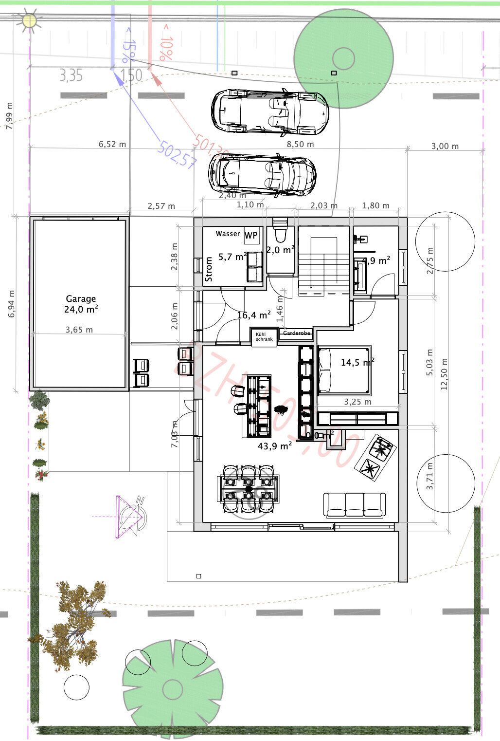

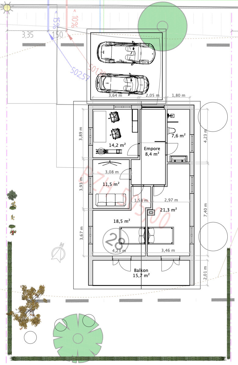

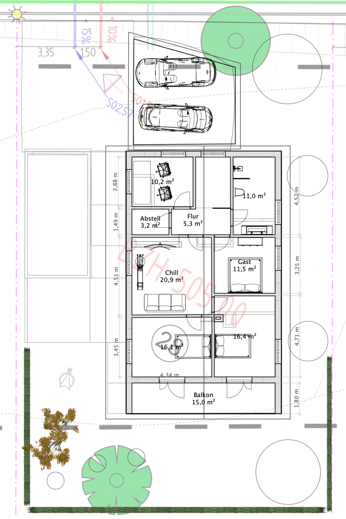

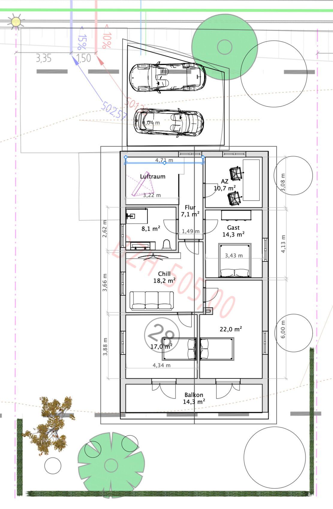

I really like the basic concept and the exterior of the house. However, I’m struggling with the apparent disorganization inside. It somehow feels cluttered to me. At first glance, I also noticed that the distance from the car to the refrigerator feels like a long journey. Consider adding a second access to the kitchen. You probably don’t want to carry your weekly groceries and trash all the way through the house.
Have you increased your budget again? Or is there a reliable calculation showing that everything fits within 600 K all-in?
os24laenger schrieb:Good that you
Garage is not really intended for the car
os24laenger schrieb:otherwise there would still be issues with the garage regulations
crossed out the garage
I just can't warm up to it either.
- Ground floor hallway is long, narrow, and dark.
- Entrance to the kitchen is very long.
- Kitchen feels like a dark cave (does it really have no window?).
- Dining room looks cramped. On one side, the balcony folding door can’t open; on the other side, bar stools and dining chairs seem cramped together.
- Living room is an oversized, narrow corridor.
- Kitchen is not connected to the terrace.
- I wouldn’t put the toilet against the dining room wall (noise issues).

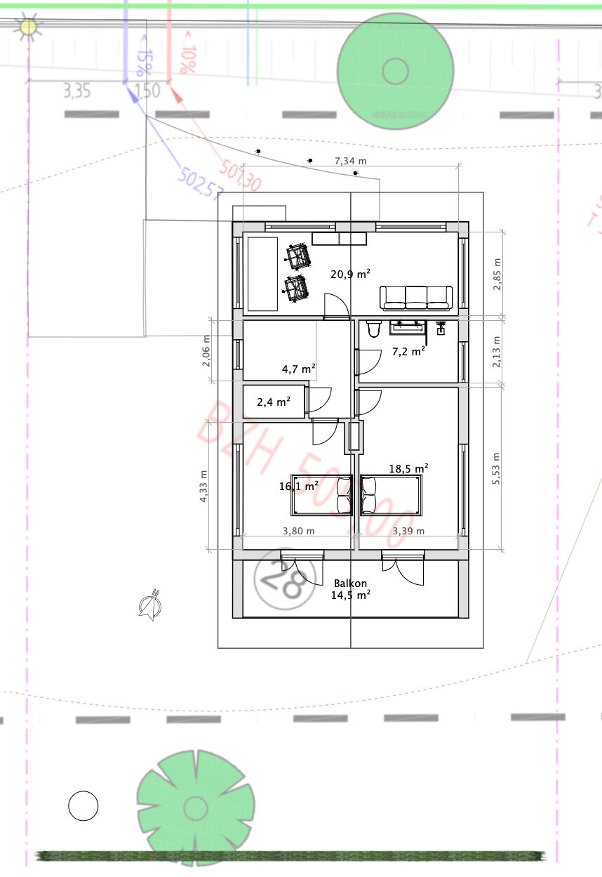

- Upstairs room measuring 7.35 x 2.85 meters (24.1 x 9.35 feet) has a disastrous proportion.
Too many compromises for my taste.
O
os24laenger31 Jan 2022 23:30PhiIipp schrieb:
At first glance, it seems like quite a long journey from the car to the fridge. Consider adding a second access to the kitchen. You probably don’t want to carry your weekly groceries and the trash all the way through the house. Yes, the long corridor is certainly not an advantage. However, it allows for a "dirty zone" at the cloakroom, and the stairs are upstairs while the toilet downstairs can be reached with clean feet. The distance from the lower bedroom to the toilet is short. I don’t see a need for an additional door at the moment.
K1300S schrieb:
Have you increased your budget? Or is there a reliable calculation confirming that everything fits within $600K all-in? The floor area is about the same as the last design, around 170 m2 (1,830 sq ft). A reliable cost estimate will only be available once the floorplan is finalized—I have to start somewhere. What else could I base calculations on without a plan? There are still plenty of options to cut costs in the finishes.
face26 schrieb:
- Ground floor corridor is long, narrow, and dark.
- Entrance to the kitchen is very long. Agreed, that’s not a plus. However, there is a window by the staircase, so it shouldn’t be too dark. And 1.30 m (4 ft 3 in) isn’t that narrow.
face26 schrieb:
- Kitchen is a dark hole (does it really have no window?) You’re right, I noticed that myself before and have now planned a skylight.
face26 schrieb:
- Dining room looks cramped. The balcony folding door can’t open on one side, and there seems to be very little space between the bar stools and dining chairs.
- Living room is an oversized narrow space.
- Kitchen is not next to the terrace. That may be, but the balcony door can open outward. The middle area is a good spot for a sideboard or an exercise machine, which also frees up some space overall. We like it that way 🙂 Having the kitchen not adjacent to the terrace is worse than before but it’s still not too far. Plus, it stays cooler there with less direct sun exposure.
face26 schrieb:
- I wouldn’t put the toilet on the wall next to the dining room (noise).
- Upstairs room measuring 7.35 x 2.85 m (24 ft 1 in x 9 ft 4 in) has a terrible proportion. If it’s not just a 12 mm (1/2 inch) drywall, the noise should be limited. The shape of the upstairs room is unusual, but I don’t see why it couldn’t work as an office or guest room. Not every room has to be a boring square.
Thanks for your input, I will reconsider some of these points again.
