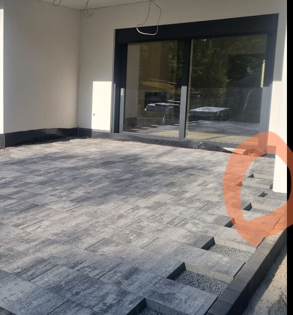

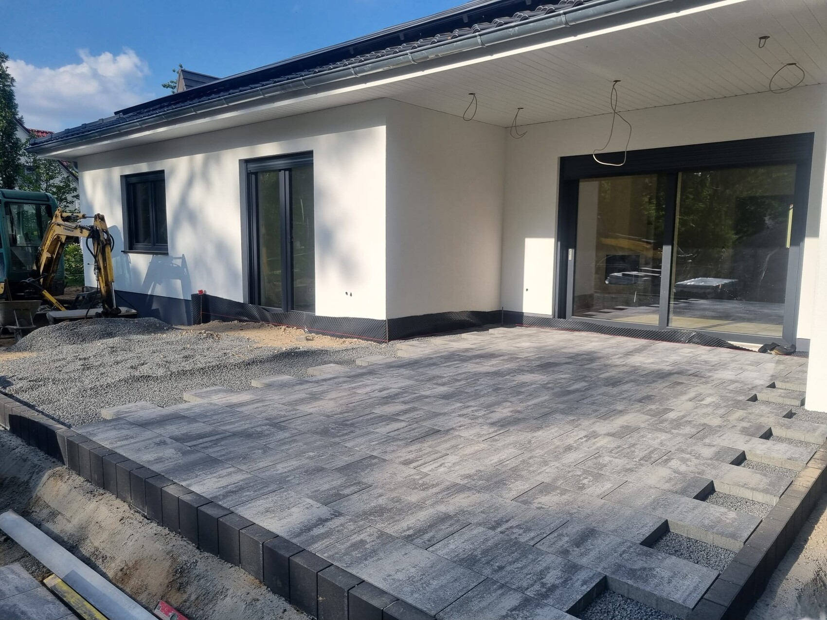

That's how it was installed... you can clearly see it in the last photo.Then you must be seeing something different from me. I mainly see just a few centimeters (inches) of offset, only one spot has a bit more. Floorboards would be laid out very differently—sometimes up to half a plank, sometimes just a few centimeters (inches), sometimes a quarter, etc. Not like with "stair treads."
Neubau202225 Aug 2022 17:44B
Benutzer 100125 Aug 2022 18:42N
Neubau202225 Aug 2022 19:04Offtopic schrieb:
The installation is okay; it might have been arranged in a more creative way, but this is how it is now.
However, the problem will be the terrace.
Why is the gravel touching the plaster directly there? Or what is that?How should this be done correctly? It could be gravel, yes.
