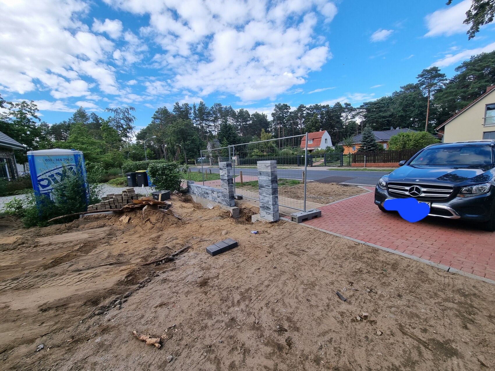

Floor plan attached.

Benutzer 100125 Aug 2022 20:10If there is moisture present, the plaster will deteriorate. A waterproofing layer is necessary here, but at least a membrane should be installed under the foundation.
Neubau202225 Aug 2022 20:14Offtopic schrieb:
If there is moisture present, your plaster will deteriorate. There needs to be waterproofing, or at least a membrane installed beneath the foundation.How likely is moisture here if:
- the terrace has a slope
- the column is covered.
I will pass this on and they should at least waterproof it.
PS. I spoke with the landscaping contractor. They will protect it against moisture. Thanks :-)
Benutzer 100125 Aug 2022 20:26He also did it at the back by the patio door.
Are you still at the construction site?
Are you still at the construction site?Yes. He secured everything everywhere. No, but the landscaping contractor is almost available 24/7 :-) Always on call, really :-) Even though I don't expect him to respond in the evenings.
Neubau202230 Aug 2022 06:03Offtopic schrieb:
If there is moisture, it will eventually cause your plaster to come off. A waterproofing layer belongs there, but at the very least a membrane should be placed underneath the foundation. I spoke with the external construction supervisor yesterday, and then with the landscape gardener. He will apply bitumen or mineral slurry to the column, just like on the walls.
