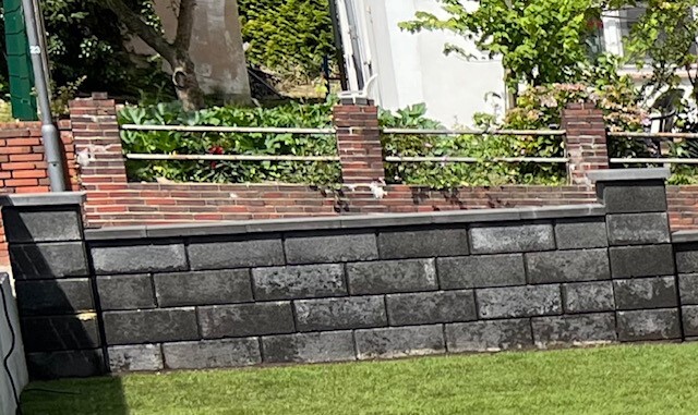

Benutzer 100131 Aug 2022 13:13The bricks without staggering? Somehow that looks wrong to me.
Neubau202231 Aug 2022 14:07Offtopic schrieb:
The wall bricks without stagger? Somehow that looks wrong to me.How else are you going to build the pillars? Otherwise, you would probably need 20-40% more bricks. Also, there is no roof on it, so no weight except for the bricks themselves. Here in my village, I haven’t seen any fence walls with stagger so far.

How else do you plan to build the pillars?I think he means the stones between the pillars.
But I've seen similar stones like yours on someone else's wall, and they were laid without staggering.
My stone wall had separate pillar elements for the pillars, which were, I believe, about 40cm by 40cm (16 inches by 16 inches), and then the wall stones themselves were 50cm by 25cm (20 inches by 10 inches). The wall stones in my case were laid with staggered joints.
Benutzer 100131 Aug 2022 14:49Neubau2022 schrieb:
How else do you plan to build the pillars? You would probably need 20-40% more bricks. Also, there’s no roof on it yet, so no weight except for the bricks themselves. In my village, I haven’t seen any fence walls built with staggering so far.There are special half bricks for this, but do they at least have continuous reinforcement?I’m familiar with the app—today it’s rainy and cold, with 8.2 kW generated; the day before yesterday it was still 66 kW.
However, I have seen similar stones like yours on someone else's wall, and they were also laid without offset.
My stone wall had separate pillar elements for the pillars, which I believe were about 40cm (16 inches) by 40cm (16 inches), and then the wall stones themselves were 50cm (20 inches) by 25cm (10 inches). Our wall stones were laid with an offset.We have the same wall, and those white spots are annoying me.
