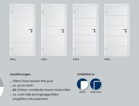

I have another question.
We want to replace the doors in our prefabricated house. However, the wall thickness is only about 6.5cm (2.6 inches), so finding suitable door frames is difficult. I have a contact who installs parquet flooring and also fits doors. Unfortunately, the local manufacturer he works with does not offer door frames that narrow. I did find some options online. Since I would prefer to get the doors themselves through my contact, my question is whether it is possible to simply buy the door frames from a different shop and then source the doors locally? They should be standardized in some way, right? I made sure that the color tone matches (frame: CPL RAL 9016, door according to the catalog: lacquered RAL 9016).
Can these be combined like this, or what else should I consider? If it’s possible, I would order the frames online and have my contact source the doors.
Thanks!

tomtom7913 Mar 2020 20:48
It would be lucky if the colors match, especially since the surfaces are already different.
Buy everything from one source and that’s it.

I would like to, but the local supplier doesn’t offer the narrow door frame. That’s why I’m considering this option. However, if it becomes an issue, I will probably order everything online. Let’s hope everything works out then. Thanks.

Better to get everything from a single source. Don’t rely solely on RAL colors. The fine print usually says something like “similar to RAL XXXX.”
Moreover, even if the color matches exactly, differences in substrates, textures, and materials will still cause variations – as tom already mentioned.
That won’t work out.
Get sample pieces of both the door frame and the door leaf to compare them directly.
I’m also not recommending for the first time to start a construction project by obtaining a RAL color fan deck. It’s a well-invested ~50€ (~50 USD) that you can later resell through classifieds.
