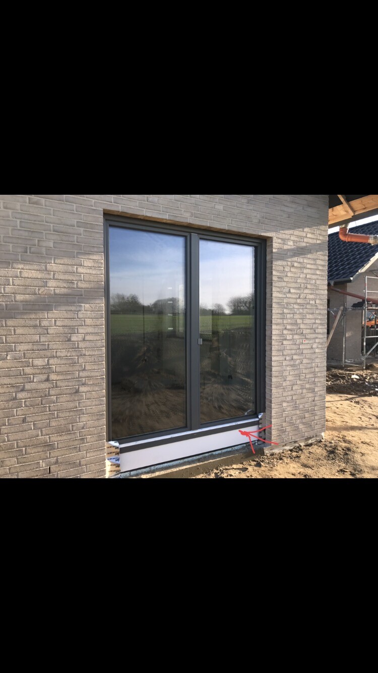

Hello, we are currently considering whether to have our terrace paved flush with the ground level.
The deep blue person said it would be okay since a slope away from the house would be made, and a grate/drain directly in front of the doors.
I'm just worried that it won’t be waterproof, which is why I originally leaned towards a (less attractive) step solution.

At what height are the ventilation openings located in the brick facade?
Are the connections for the drainage channels near the patio doors?
The connections – at least with Aco – for 100mm (4 inch) PVC pipes run vertically downward, so they may need to be routed around the corner using corner elements before reaching the base slab. The corner elements from Aco are only available as plastic components rather than polymer concrete.
Sealing should be possible to create very well and durable with EPDM membranes and EPDM adhesive, or it may already be in place.
