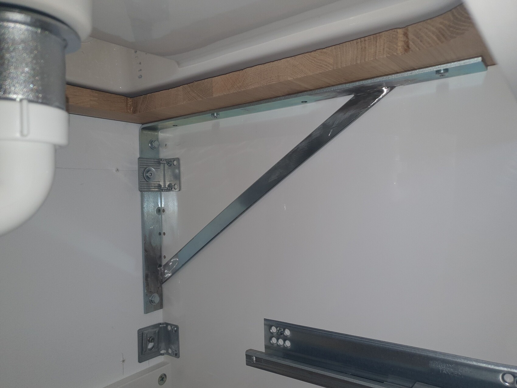

Maybe this helps you. So, I installed heavy-duty corner brackets from the hardware store on both sides inside. However, I modified them so the drawers could still fit. The diagonal braces of the heavy-duty brackets were positioned in the center. I moved them outward. I’m not sure if it was necessary, but it makes the structure feel very stable. I also had to remove a bit from the back panel to accommodate the siphon. In our case, it’s a drywall partition with an OSB board built in.

10 Jul 2020 10:08
world-e schrieb:
[ATTACH alt="außen.jpg"]49130[/ATTACH]
We are planning something very similar, except that we will have a single sink and the countertop will be only 1.36 meters long (4.5 feet).
I can’t see clearly in the picture—did you install an additional wooden strip as support under the countertop on the right and at the back?
Scout mentioned that 10 mm (0.4 inch) screws with expansion anchors and support brackets should be sufficient. I was actually considering threaded rods because they provide a very secure hold.

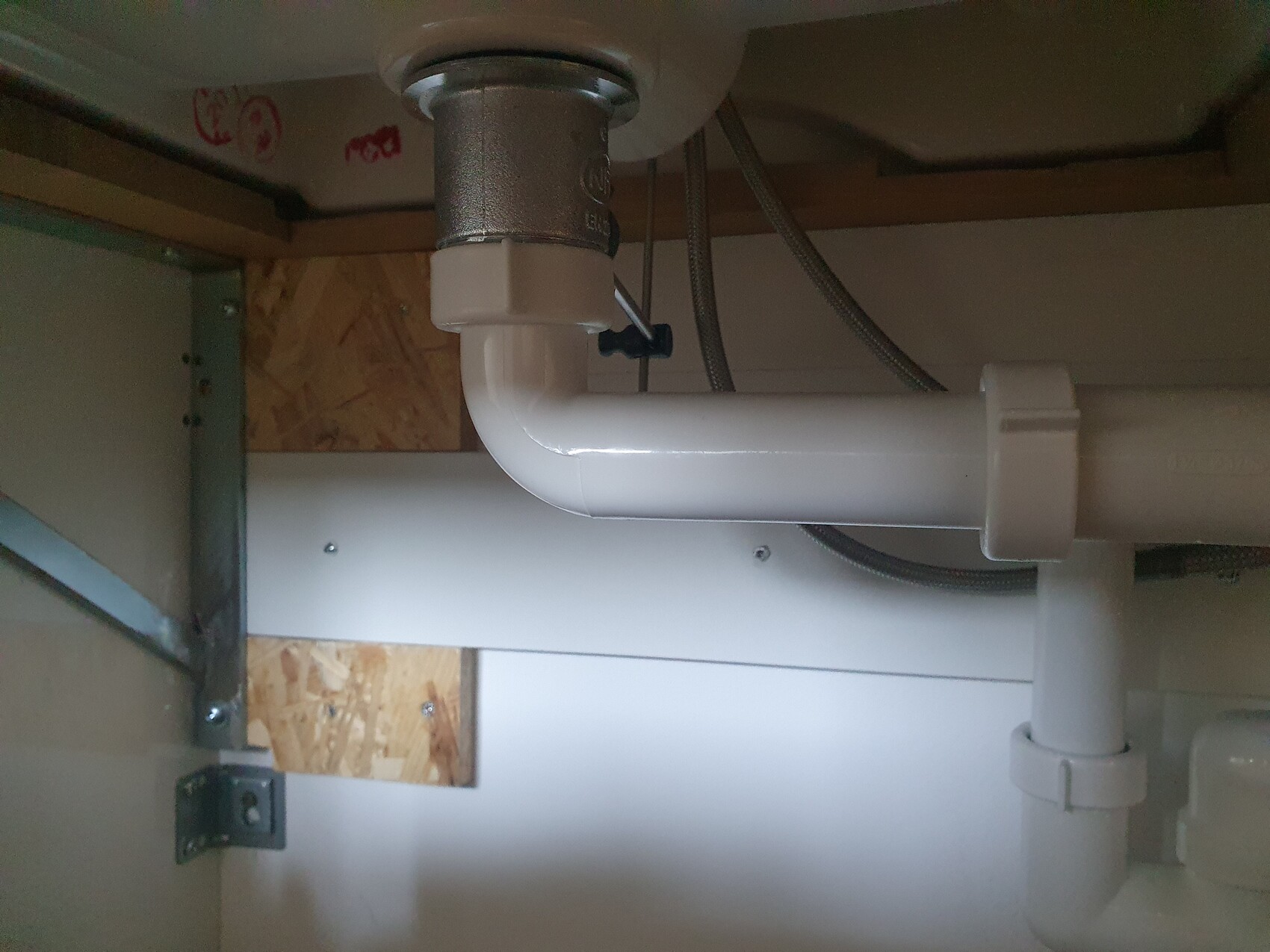

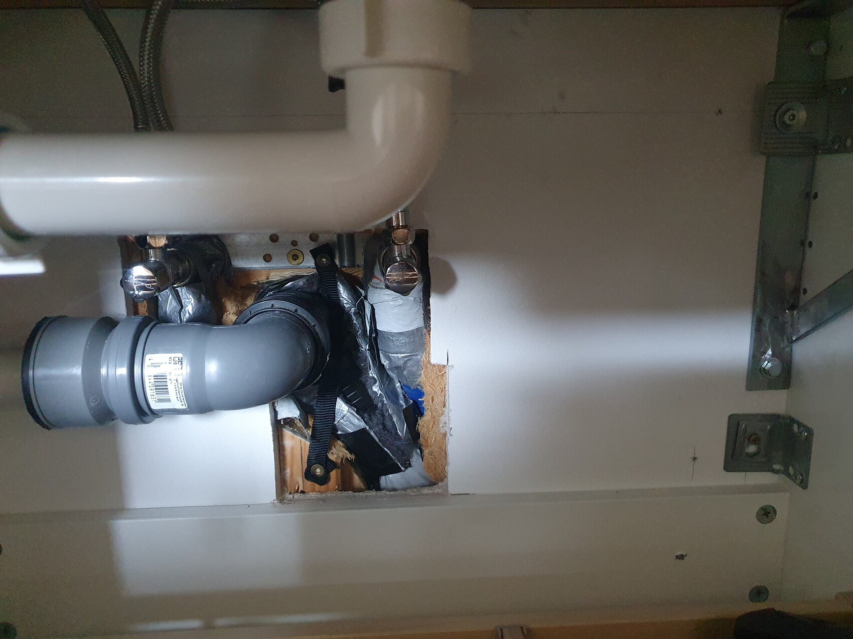

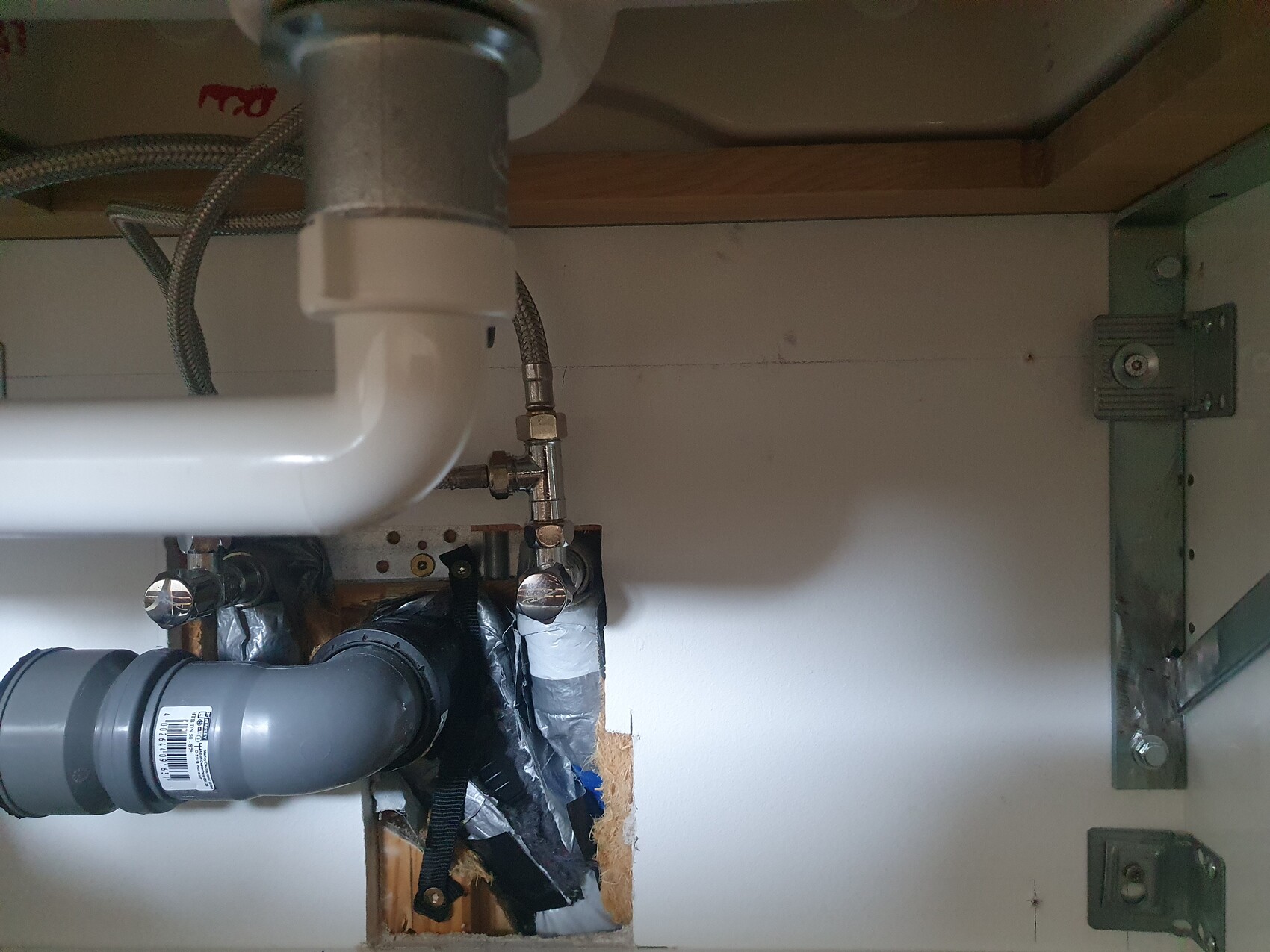

10 Jul 2020 11:00
So, the wooden board rests on the base cabinet and the heavy-duty brackets. The overhangs on the left and right are no longer supported. We have an overhang of 29cm (11.5 inches).
This is how it looks inside.
Right side
PVC drain pipes with S-shaped connection and hole in the wall visible under the sink.
Left side:
White PVC drain pipe with bend (P-trap) and metal fitting under the sink.
It was quite a bit of fiddling to make room for the double trap, but you don’t have that. On the right side (top image), I had to move the crosspiece because of the drain pipe. On the left, I placed OSB underneath to be flush with the crosspiece so I could screw in the heavy-duty bracket.
