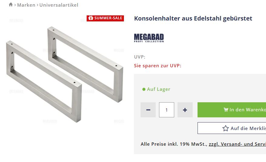

We bought these here back then at Bauhaus (but they have to be ordered).
They each support up to 120 kg (265 lbs).
Our Godmorgen, but the smaller one, is installed on the side underneath a 160cm (63 inch) countertop.
The sink itself is mounted on the wall frame and recessed into the countertop.
The brackets with the washbasin were anchored by the craftsman for 50€.
