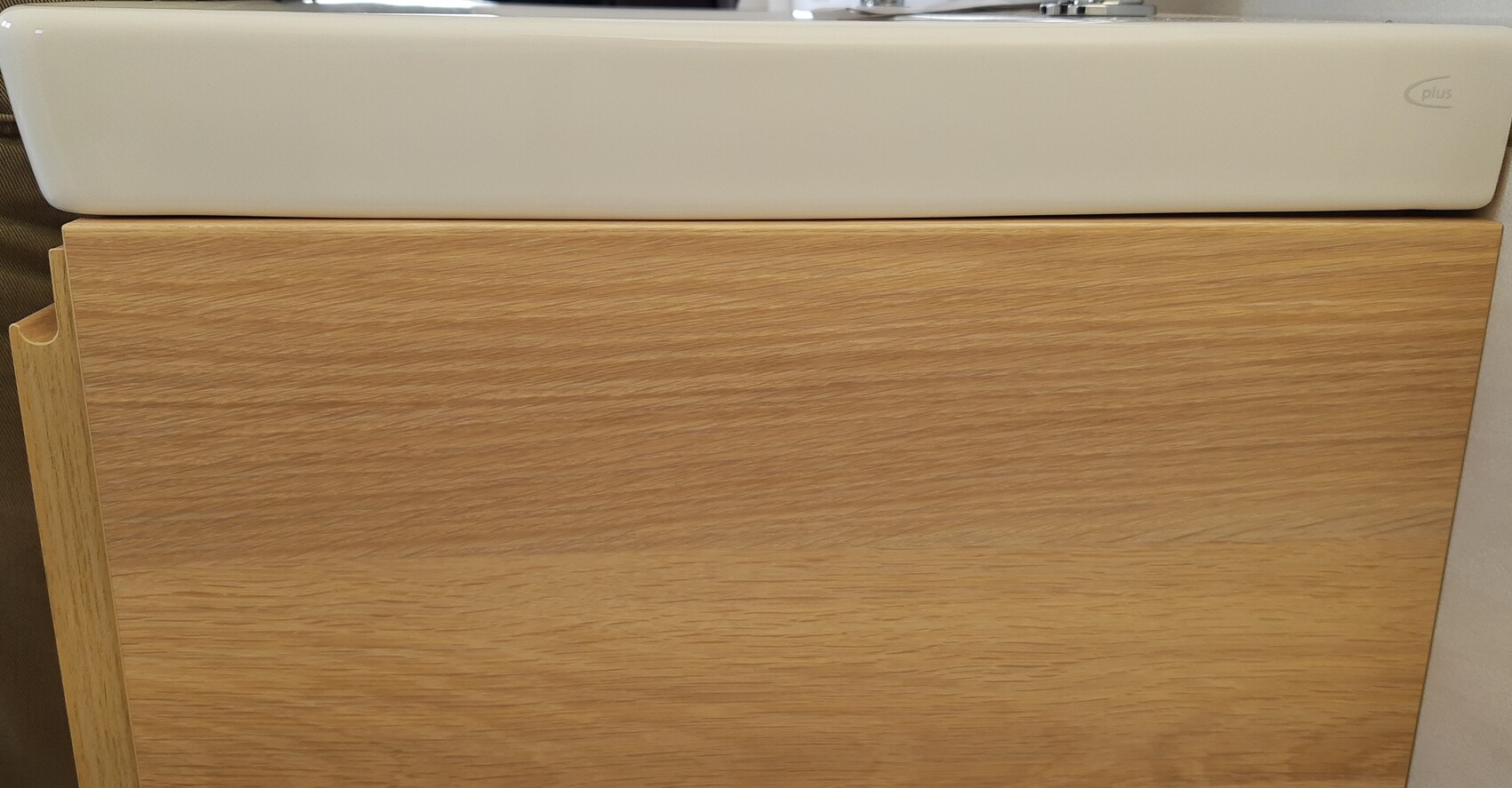

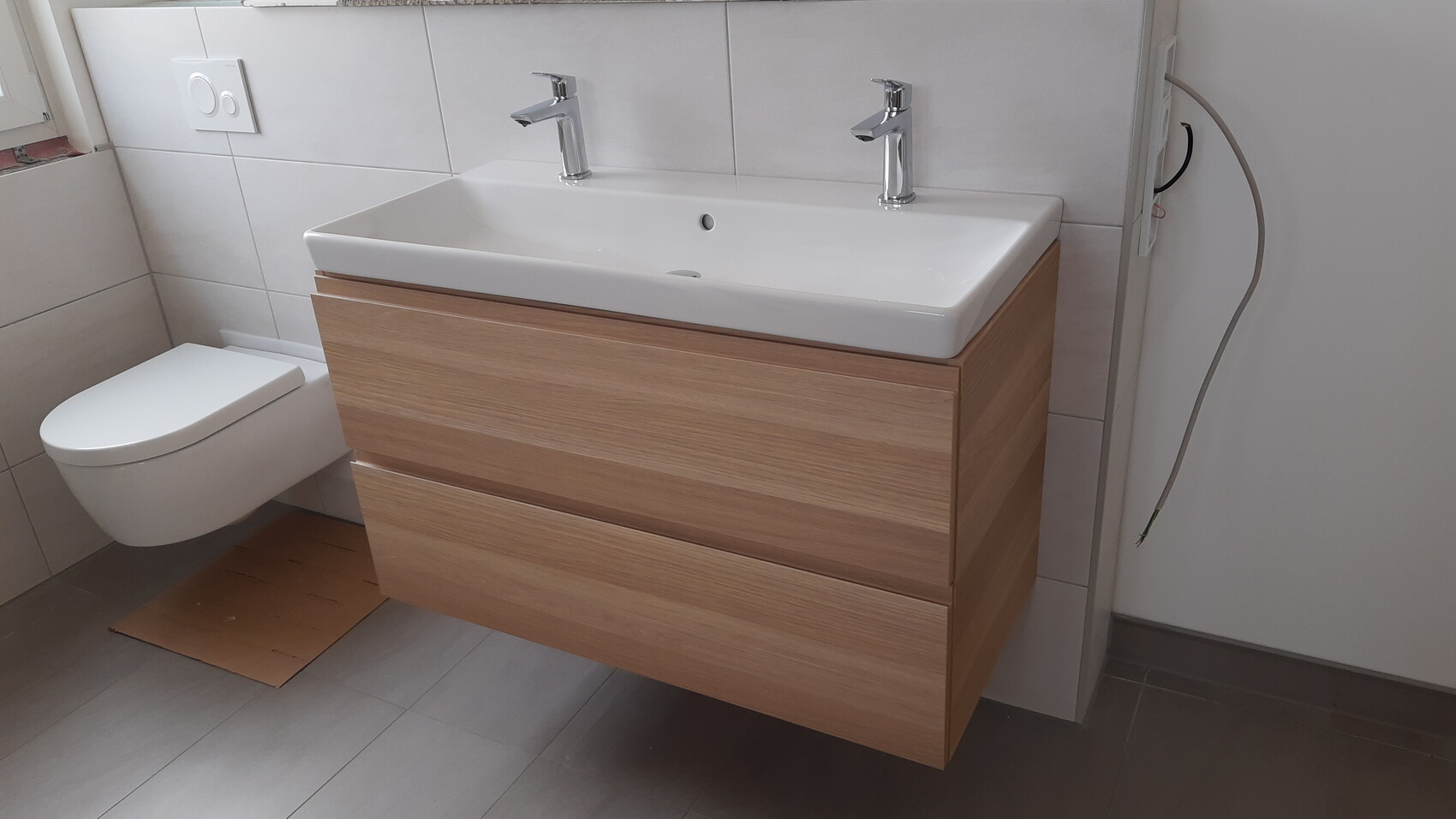

So, almost live from the construction site: The washbasin and cabinet are installed.
Villeroy & Boch Avento 100 cm (39 inches)
Ikea God Morgon 100 cm (39 inches).

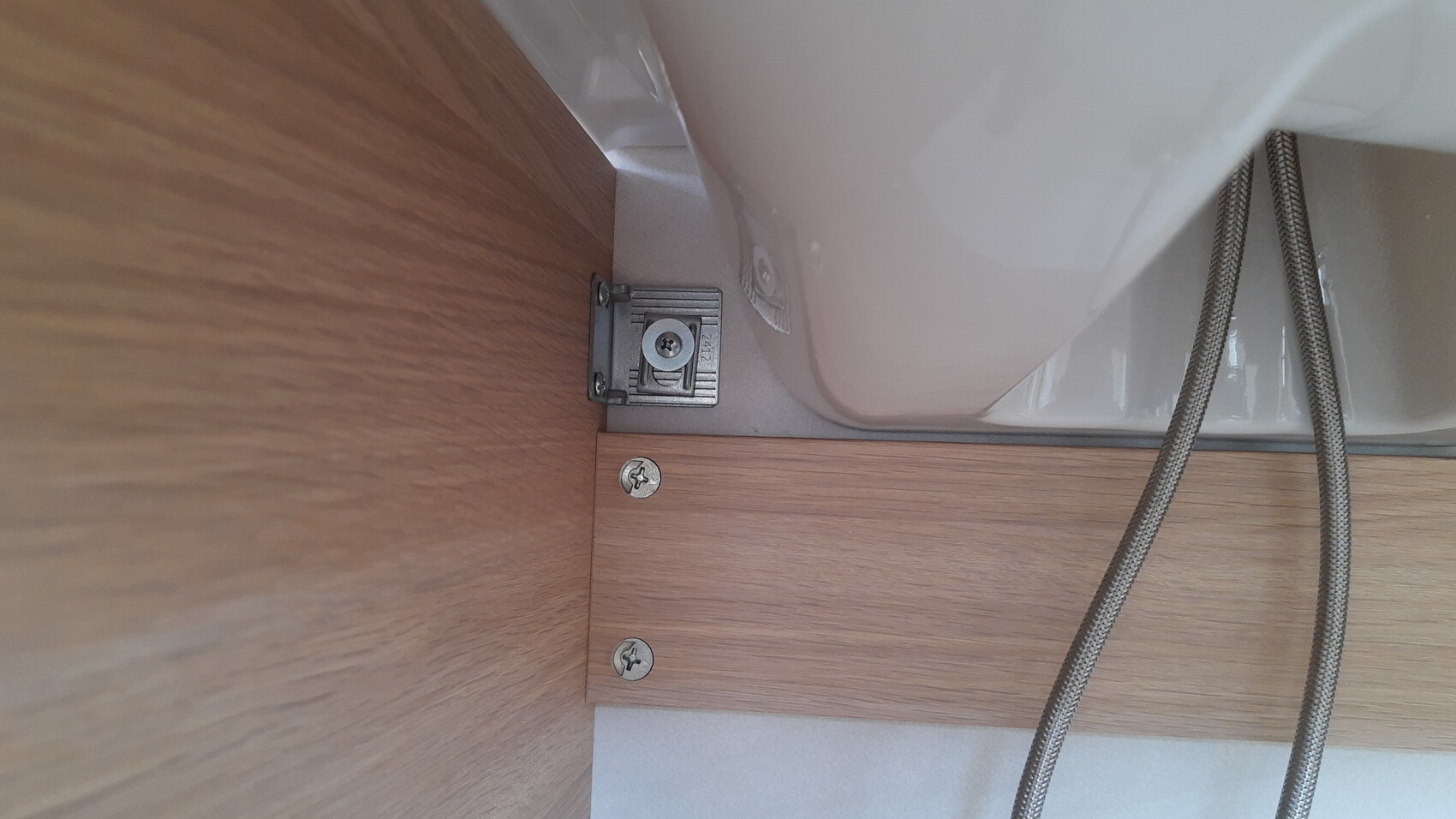

Both fit well together in terms of mounting; the crossbar and brackets clear the back of the sink.

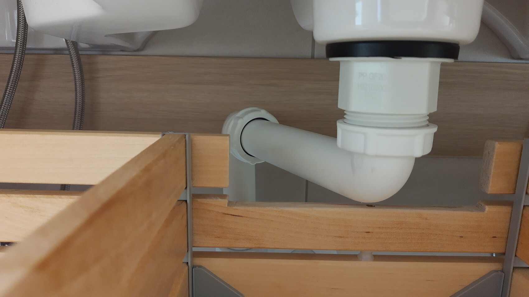

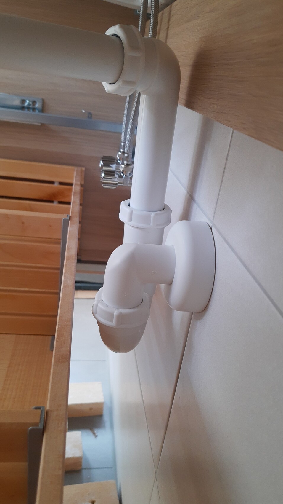

We only needed to cut out a small section of the Pax wardrobe back panel of the upper drawer to create space for the space-saving siphon. The siphon is a standard one from the hardware store.

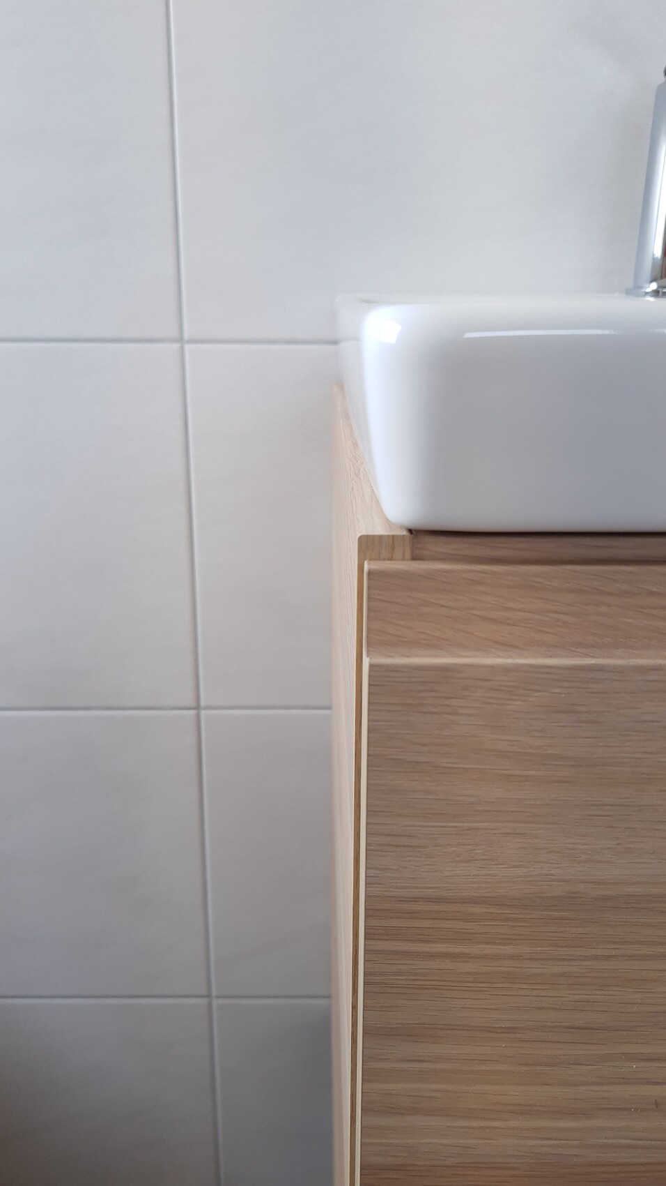

Note: The washbasin is tapered, 100 cm (39 inches) wide at the top, 98 cm (38.5 inches) at the bottom. The cabinet is 100 cm (39 inches) wide, so it overhangs by 2 cm (0.8 inches). We were aware of this but still wanted to combine it with the God Morgon instead of paying more than twice as much for a matching Villeroy & Boch cabinet.
Also, the bottom of the basin isn’t flat, even though it’s marketed as a cabinet washbasin. Checking pictures in bathroom stores, you can also see a gap when combined with Villeroy & Boch cabinets.

Addition: The sink is mounted separately on the wall, so the cabinet is simply hung underneath.
The push-open valve that came with the faucet also fits without any issues with the siphon.

Can two people really work on that at the same time?
wp.seeker12 Mar 2023 21:18
Steffi33 schrieb:
Can two people really use it at the same time?
Of course. As long as everyone has their own faucet, everything is fine.
We didn’t want a giant washbasin, nor two separate sinks. Having two faucets was important.
