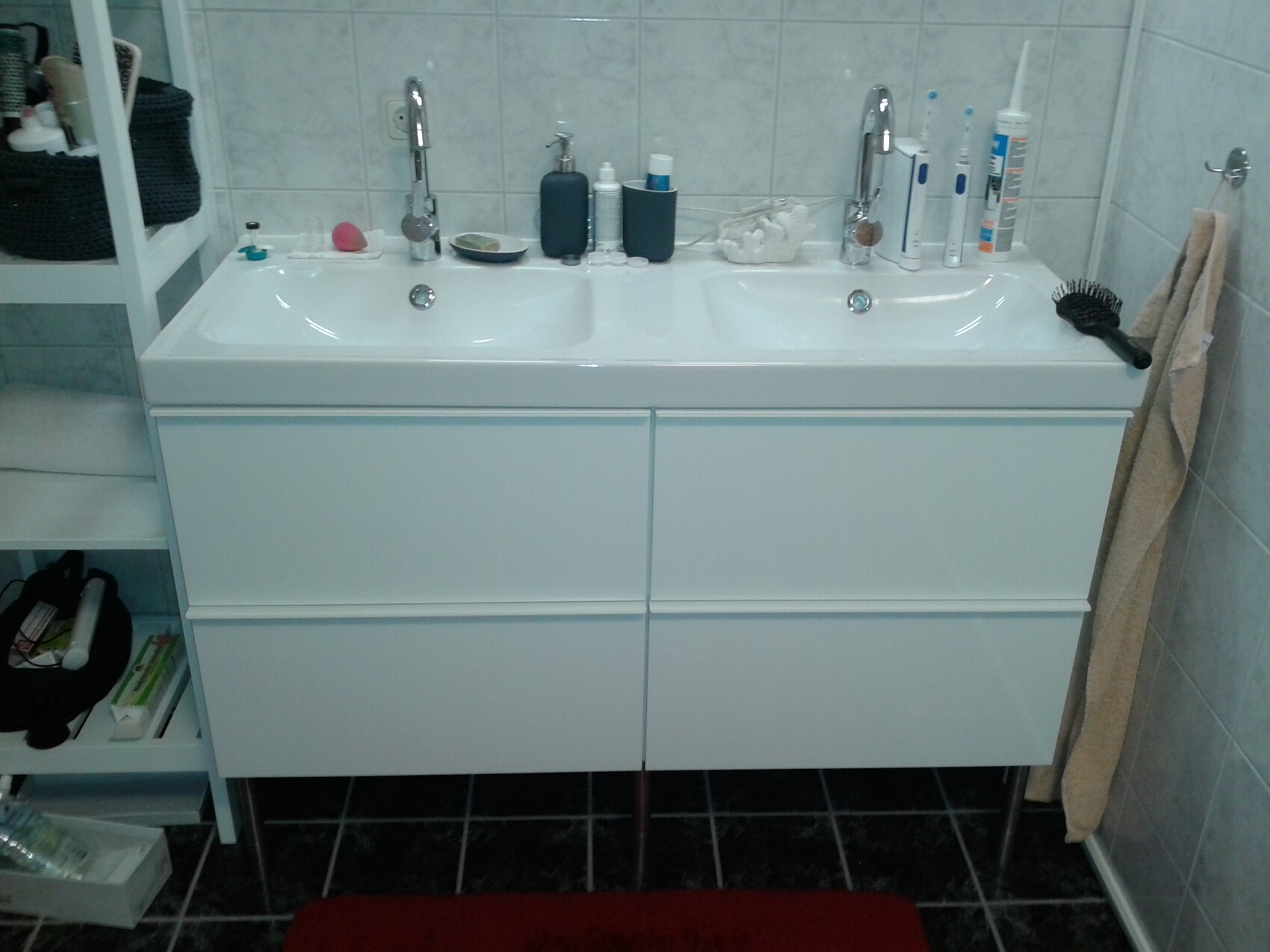

So, the move is done and the Godmorgon is installed... I’d like to share my experience with it, but didn’t want to start a separate thread. I hope anyone looking for information on this topic will find it here. I’ve read a few times that the question comes up whether it’s possible to install it without any wall fixing.
We have the Godmorgon in a width of 1.20 m (4 feet) with the Odensvik double sink. Aesthetically, I would have preferred the vanity completely "floating" without any legs at all. Unfortunately, this wasn’t possible—for one, because it’s a rental apartment and the tiles shouldn’t be drilled into (with so many angles on the back, it would have been hard to avoid), and secondly because all the walls are made of drywall. We decided not only to attach the three recommended legs at the front but also to add three more at the back, six in total. This gives the Godmorgon a very stable base. We then only fixed it to the wall with two screws into wooden cross beams, to prevent any movement since the sink just sits on top. This worked perfectly; everything is firmly in place and, thanks to this solution, it can be completely removed again without damage when moving out. For the faucets, we eventually chose the "Focus S" model by Hansgrohe. It matches the Odensvik sink very well, with no splashing and a practical angle. The unnecessary pull rod could be omitted without any issue; the hole for it on this model is not at the back but somewhere on the side, and it’s oval, so it blends in nicely and is barely noticeable.
Here is a picture of it
