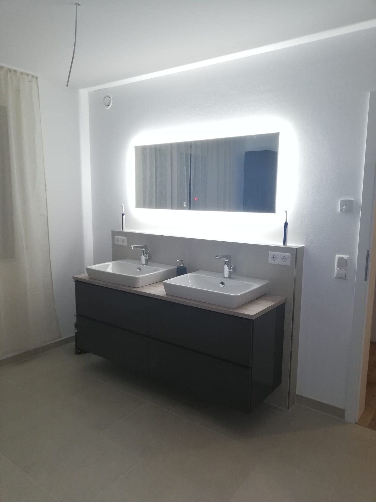

Prager91
16 Mar 2023 11:49
Alibert87 schrieb:
Photos afterward would be great. Thanks for the description.
I found one from back then – see attached.
Modern bathroom with double sink, dark vanity cabinet, and illuminated mirror.
