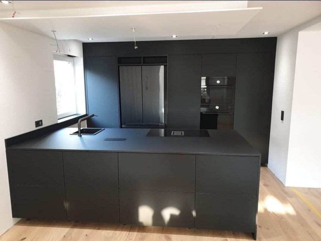

This image illustrates well how price differences can occur:
Same kitchen, same quality, same satisfaction, but not necessarily the same price.
For example, consider the visible doors on the island: are they doors with standard cabinets (two shelves) behind them?
Cost-neutral.
Or are there drawers behind? Four cabinets could add around €1000. Or are these actually pull-out drawers, which is hard to tell in the picture? If so, you should probably plan for a price difference of about €1500.
In the row of tall built-in cabinets, I can see a top panel about 20cm (8 inches) high. Is this just a cost-neutral filler panel? Or does the budget allow for flip-up doors to be installed there, creating additional storage space? You wouldn’t notice a difference of around €500, but the kitchen would have more storage capacity.
By the way, for me, the two compartments above the fridge are a no-go, especially considering the care taken with the cabinet row.
The sink appears quite narrow, which can be sufficient—especially if there is a larger utility sink in the laundry room. But some don’t have that, so you would need to pay extra for a larger sink.
Unlike thicker countertops, the narrow countertop also hides an additional cost factor. The right side panel costs extra, and in planning a more affordable kitchen, this would be omitted.
I believe a toe kick is also cheaper than stylish legs supporting the base cabinets.
A conservative kitchen planner who prefers wall cabinets with a crown molding, for example, would end up paying extra for the elaborate trims above and below the wall cabinets. Often, lighting is included by the kitchen manufacturer. In this example, the lighting is handled separately, which reduces the kitchen studio’s invoice.
Incidentally, once this kitchen is in use, the island will likely look cluttered, because sooner or later knife blocks, notes, oil and vinegar cruets, salt and pepper, small appliances, etc. will collect on the countertop—for me, an element is missing here.

With pull-outs behind? 4 cabinets could cost around 1000€.Two large drawers with an additional drawer behind cost an extra 65 euros. The 60cm (24 inches) cabinet costs 180-220 euros including the fronts. The top panel costs 60 euros.The entire island without appliances is about 1200 euros, maximum 1500.
And the advantage is transparency, not some kind of imaginary block calculation.
I estimate the kitchen would cost a maximum of 5000 euros for self-installation, excluding appliances.
