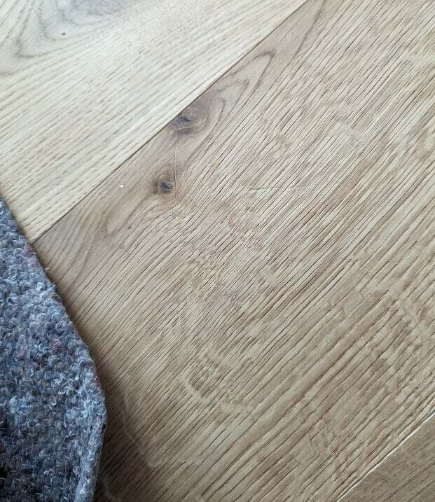

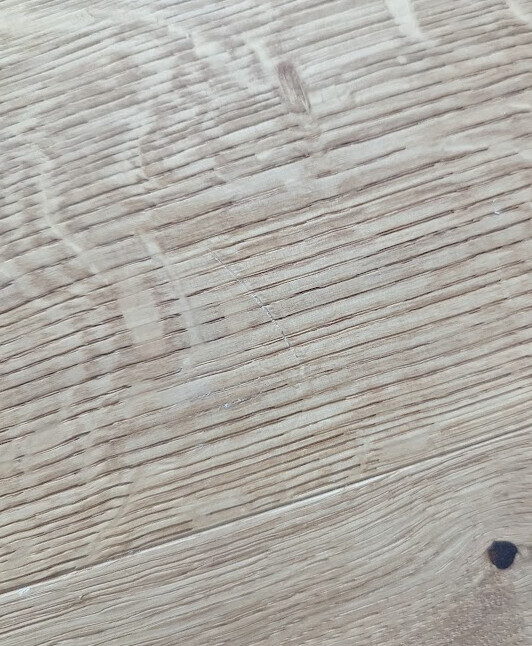

Despite all precautions and laying protective coverings, they managed to cause the first scratches on our floor within the first two hours.

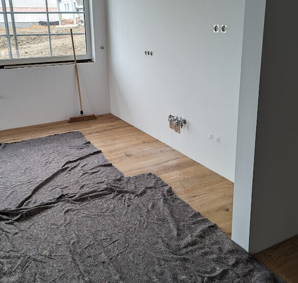

The kitchen installers said it was the plumbers—they had set the dishwasher connections 6cm (2.4 inches) too high during rough-in, so it didn’t fit in the end. They then had to quickly chip away some wall in a rush and replace the two angle valves with this interesting construction shown in photo 3.
I can somewhat accept the scratches on the floor; I’m sure they can be repaired somehow—plus, damage like this is inevitable. Soon, the house will be lived in, with kids, so a bit of wear and tear will happen faster than you can say “oops.”
I’m only worried about telling our builder. He will probably be angry—he specifically emphasized on the phone that “they should lay something down on the floor” and “they need to be careful.”
chand198627 Jul 2023 15:36Tolentino schrieb:
I actually don’t really get it either, but maybe the cutout in the cabinets is lower down? So, 6cm (2.4 inches) higher would really be the back panel?Then cutting out the cabinet would have been much easier…chand1986 schrieb:
Then cutting out the cabinet would have been much easier… The cabinet was cut out. The dishwashers are elevated and installed all the way to the back wall (they are XXL size). The connections need to go through the back panel of the cabinet below. This cabinet is designed to be cut into for that purpose, which is why it only has a shallow drawer.
However, the connections were positioned so high on the wall (41cm (16 inches) instead of 35cm (14 inches) above the finished floor level) that they were effectively located behind the dishwasher, rather than behind the cabinet.
