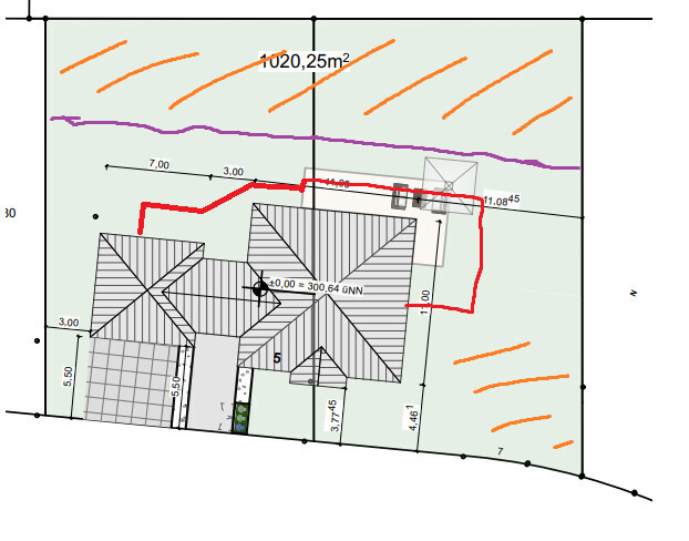

The only thing catching up with me is the outdoor area. Initially, I planned to just get by with it for "a few years," but now I’m tempted to invest a bit more in the outdoor space next year to avoid unfinished projects I might regret later.
I marked in red what has been paved – the terrace faces almost directly south.
Then we have a bit of flat area shown in purple in the picture. Everything toward the border—at the top of the picture—is unfortunately a very steep slope. Steep enough that I can’t easily walk on it. It has two rough terraces and is currently naturally vegetated, so rainwater doesn’t run off onto the neighbor’s property. However, I’m not very happy about this because I can’t really use most of my property. We are now considering how to stabilize this area somehow. For cost reasons, probably planter rings and doing the work ourselves. Along the 30-meter (98 feet) length, we want to raise it by about 2 to 3 meters (6.5 to 10 feet).
Would you rather build up as high as possible right at the border and let the rest slope gently down behind the flat area? Or would you prefer to create two levels, meaning hold back at the border at about 2 meters (6.5 feet), then add some more planter stones and a staircase along the current level, and create a second level below that, which would then be more or less flat?
If we only place planter stones along the border and fill in, it will be noticeably less steep than it is now but will still have a slope. It would be usable and also mowed.
