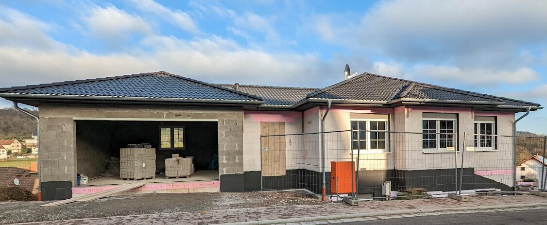

A quick progress update on our little house. =)
The large "wallbox" in the carport is finished. The smaller wallbox will be installed next to it. Pipes for the mechanical ventilation system run through the large one.
We are considering accepting the offer for the photovoltaic system and related equipment. Nothing else will be installed or changed after that, but investing in the buffer tank for the photovoltaic system makes more sense than in aesthetics – at least that pays off. 😉
The shower drain is in place. They have since cut and installed more insulation foam around it. To quote my partner: “I didn’t even know that there’s insulation foam inside a shower.”
The drywall partitions are now closed off in the bathroom and toilet.
There was almost a problematic bend in a pipe right in the living room – a mistake on my part, as I missed it in the planning documents. Neither the contractor nor my husband cared about how it looked. But I was very particular and absolutely did not want such an angled corner smack in the middle of the living room. I was nearly desperate when I saw it during construction. However, the contractor fixed it by moving the drywall forward by the thickness of the pipe. Behind that is also where the HVAC system enters the house. Additional insulation was added around the opening. Like everywhere else, it’s mounted to the ceiling with metal rails.
Now I have a straight wall, just as I wanted. Of course, I had to cover the costs, which will come to about 500€ for the materials. I don’t know if that’s cheap or expensive, but I’m glad it was possible to change it on such short notice.
View from the kitchen.
Probably just 2–3 more months to go. We can hardly wait. Hopefully, our little one will take her first steps in this living room.
