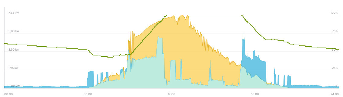

If with the 12 kWp system the 6 kW threshold is rarely exceeded, then pure surplus charging for the car battery probably makes more sense than using the storage.If you have the option, you should charge the car during midday. However, very few people have this possibility. Here is how it looks for me:
May 9, 2023, Bavaria
What can be seen:
The storage was not empty and is charging throughout the day.
I come home at 5 p.m. and charge my car.
Scenario:
The car can charge at 6.6 kW.
The storage can discharge at 3.3 kW.
The photovoltaic system generates 2 kW (falling).
Perfect (5 p.m.) would be:
Car = solar + storage + grid supply
6.6 kW = 2 kW + 3.3 kW + 1.1 kW
For example, I could charge at about 8 kW but limited my go-e charger to 4.5 kW.
I also want my car to “sit” at a maximum of 90% charge.
Reason: Significant extension of the car battery’s lifespan.
One downside: The electronics are under longer stress, which affects their lifespan. I accept this (inverter ~1500 € vs. car battery ~7000 €).
Example: If I still have power in the storage in the morning and the car is at 90%, I start charging again with the app. By the time I leave, 30 minutes later, the car is at 94%. At work, the car then sits at about 80% charge in the parking lot.
Normally, I say storage systems are too expensive at the moment, but around €8,000 for roughly 12 kWh storage? Take it! 🙂

Regards With a discount, we are actually closer to 6,500-7,000€ for the storage alone. We will probably take it, yes.
We are even lucky that we can charge the car during the day, as we work remotely. We want to charge only with surplus if possible. We rarely need the car fully charged. In daily use, 90% charge is enough since we seldom travel long distances.
Unfortunately, our car can only charge on AC up to 6.6 kW. With an 11 kW wallbox, we likely wouldn’t exceed 3.3 kW, as someone explained to me. I didn’t fully understand why exactly — something about single-phase vs. three-phase.
