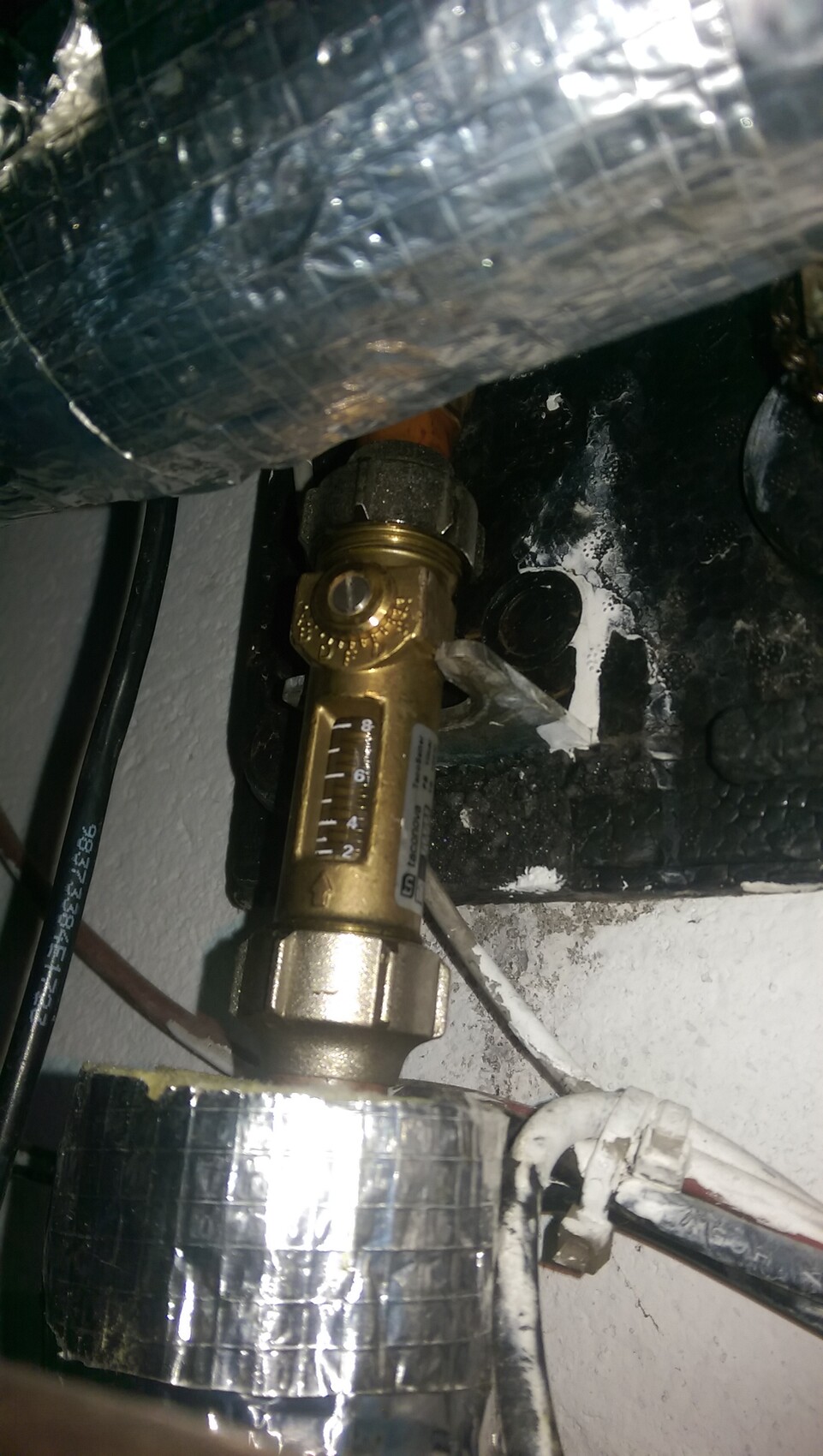

Over the weekend, my neighbor and I inspected the piping system and discovered a shut-off valve. Yesterday, I ran an experiment using this valve, which went as follows:
Yesterday at 9:30 PM, without any sunlight, the temperature on the collector’s upper sensor was 73°C (163°F). I closed the shut-off valve installed on the collector feed line. This morning at 6:00 AM, I checked again, and the upper sensor showed 16°C (61°F). I reopened the shut-off valve and went for breakfast.
After 30 minutes, before leaving for work, I checked again and, without any sunlight, the upper sensor suddenly showed 66°C (151°F), even though the pump was still off.
The pump normally only starts when there is a temperature difference of 5°C (9°F) between the lower and upper sensors.
Where do 50°C (90°F) come from in 30 minutes if not from the sun? It can only be coming from the storage tank. I don’t want to heat my collectors during winter, but I’m glad if 30°C (54°F) comes from above in winter so I don’t have to heat the full 75°C (167°F).
Does anyone know this problem?
Can anyone help me figure out how to solve it?
This is my first house, and I’m not a tradesman, but something is definitely wrong here—I have enough technical understanding to know that. I can only imagine this is caused by thermosiphoning, like in an old gravity heating system. When the fluid is warm enough, it rises on its own without the pump running and continuously cools down my storage tank.

kkk27272926 Jul 2018 14:16How does the solar system heat your buffer tank? Through a corrugated conduit?
A possible solution could be a gravity brake in the solar circuit, if one is not already installed.

So, from the collector on the roof to just before the pump, there is a corrugated pipe (supply and return lines are the same length). From the pump to the heat exchanger, copper piping is used.
Okay, what is the purpose of this gravity brake and how does it work?
I will pass this tip on to my installer.

Hello
The picture shows a flow meter, which is usually installed together with the pump on the return line to prevent damage caused by excessively high temperatures.
The pump typically also has a gravity brake installed above it.
Some solar stations have the option to deactivate the pump via the shut-off valve located above it.
Please take a photo of the entire pump station.
