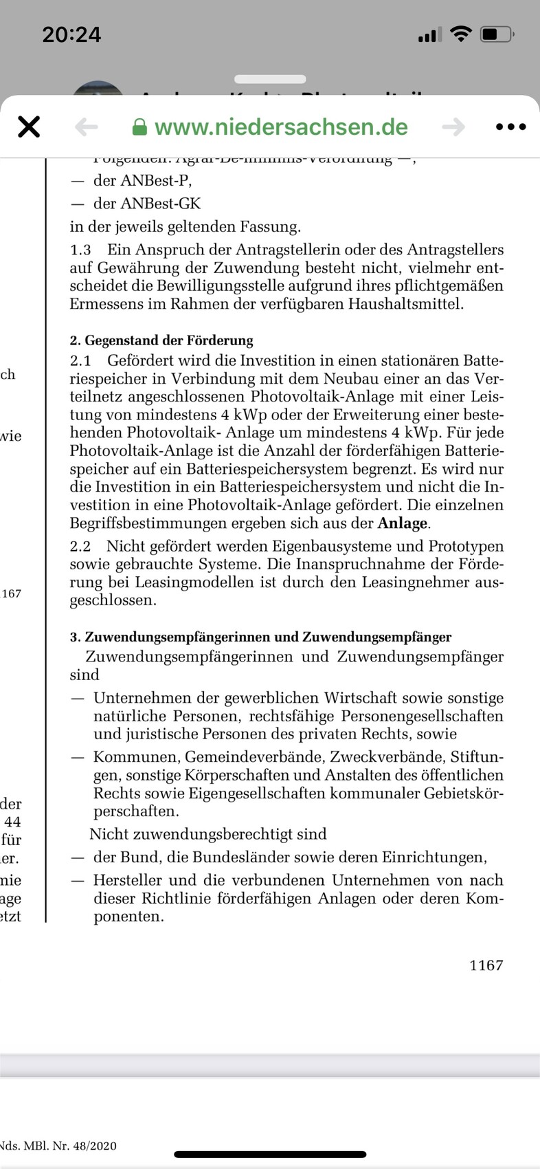

Apparently, a new funding program from the N-Bank is set to start at the end of the month.
In Lower Saxony, storage systems for photovoltaic (PV) installations with a minimum capacity of 4 kW are subsidized at 40%.
This almost makes you consider installing a small PV system on your roof just to take advantage of the funding.

Grobmutant29 Oct 2020 08:405.1 The grant is provided as a non-repayable subsidy in the form of co-financing to support the project.
The process is not entirely clear to me either. It would be necessary to inquire with the NBank about this. Perhaps they will publish further information soon. So far, I have not found anything about it on their website.

We currently have a 4.55 kWp system and, if the subsidy is approved, we would like to increase it to around 8 kWp and add storage.
I’m wondering what the best approach would be. I would like to change the solar installer; is it possible to get compatible modules from any other provider? The inverter will probably need to be replaced or maybe a second one added—I’m not sure which option makes more sense.

Grobmutant29 Oct 2020 09:51@kati1337 You would need to increase to at least 8.55 kWp, otherwise you won’t qualify for any subsidies.
The system can probably be expanded by any other solar installer. Why shouldn’t that be possible? Find a good solar installer and check with them what your current inverter can handle. Getting a new inverter just for an additional 4 kW doesn’t seem economical to me.
