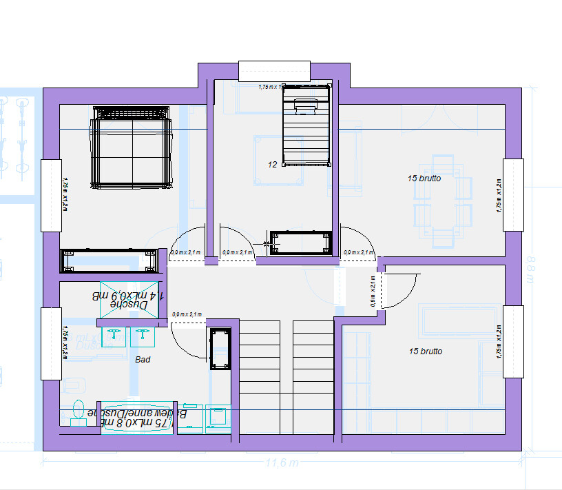

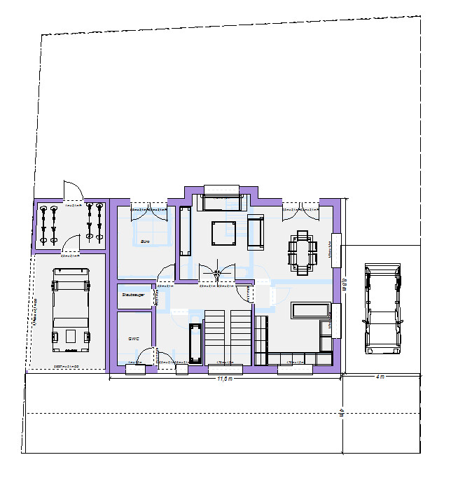

Hausbaurer
I couldn’t warm up to the east-facing orientation. The garden would be too fragmented for my taste. (But if that doesn’t matter, just rotate it.)
Attached is a sketch based on the original draft: south is at the bottom of the plan.
Do you have to build so many roads here? Yes! Otherwise, the carport on the west side would block too much light.
If you could warm up to the “I” shape of the open living area, the carport on the west side would be an option again.
Well, this is probably a complete disaster, because to quote the original poster:

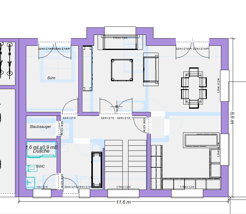

I am about 95% sure that the city will allow me to pave half of the plot. Our city is very focused on preventing soil sealing. While other cities are debating whether to add more parking spaces, here they are even discussing the possibility of having zero parking spaces.
Unfortunately, there are no interior dimensions included, but I would estimate that with our furniture (corner sofa – yes, the plan shows two because the software crashes when I try to design just one corner sofa, dining benches instead of chairs, etc.) it won’t work. Also, in our plans, all interior doors are 1 meter (3 ft 3 in) wide, and the walls with a door would then be 1.2 meters (4 ft) wide. I don’t think that’s actually specified anywhere.
Oh, and I wouldn’t go so far as to call it a catastrophe. There are definitely aspects of your proposal that I would never build, and others that I would. And that’s the point. If I told you that the upstairs bathroom is simply too large, or that I would never stack a washing machine like that, etc., etc., you might tell me I need it that way.
What is clear, though, is that the upper room doesn’t really benefit from the bay window. It simply doesn’t affect the use of the room, even if it is half a meter (around 1.5 ft) larger. BUT the living room definitely needs it, especially if you place the sofa there, because then you can walk past it. Does anyone have an idea what extra costs this would cause for timber frame houses?

I quite liked the layout of the carport by @RomeoZwo:
https://www.hausbau-forum.de/threads/grundriss-efh-mit-ca-150-qm-auf-hinterliegergrundstueck.45070/post-621499
However, I would make it at least 4m (13 feet) wide to allow space for the front door and to keep the turning radius large enough. I would use the west side only as a parking space and turning area.
The issue with the washing machine in the bathroom was probably a misunderstanding. I thought your laundry basket tower was a washing machine tower. The space in the bathroom could simply be swapped out for the laundry baskets, and a laundry chute would also make sense.
For the second bedroom, you could mention whether there will be a central mechanical ventilation system. At this size, it is mainly about the air quality for sleeping at night. The key point is CO2 levels. But I believe everyone understands that you would prefer a smaller room.

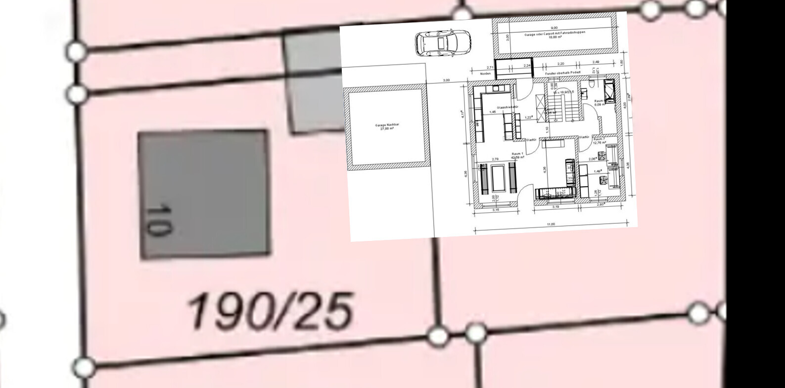

In this whole layout, the question still remains for me whether the neighbor’s garage will actually be built as planned. It was outlined in #38, and with 11m (36 feet) between the house and the property line, there is only about 5m (16 feet) left for maneuvering in and out. However, if the neighbor decides to build their garage differently, the “optimal” position of the carport will change, and with it, the position of the house as well. It’s not a simple situation. When is the neighbor planning to build their garage?
