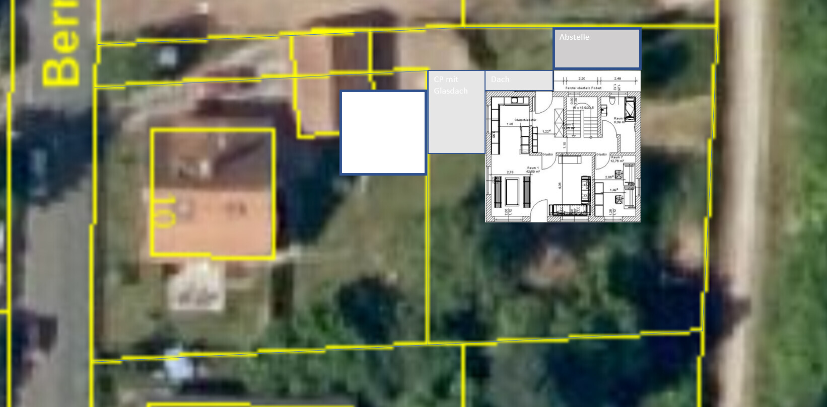

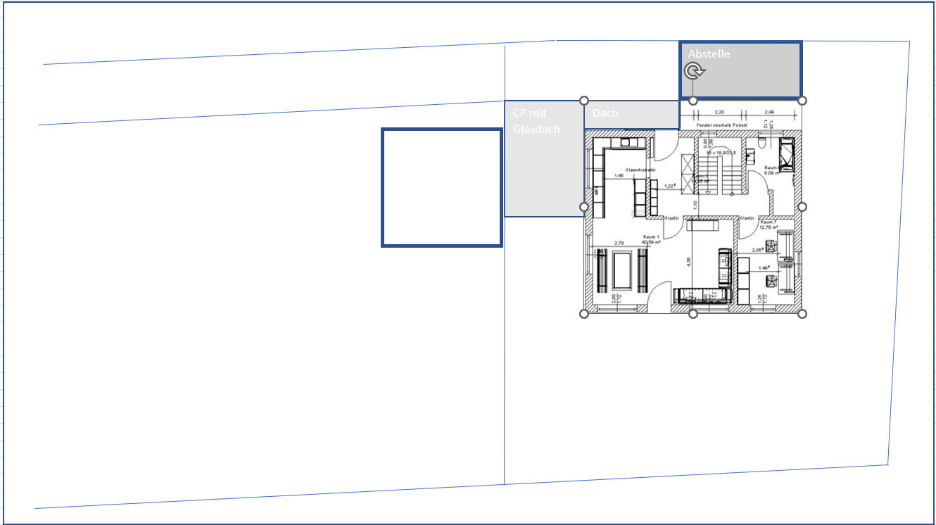

ᐅ Single-family house floor plan of approximately 150 square meters on a plot located behind other properties
Created on: 27 Feb 2023 08:24
Hausbaurer

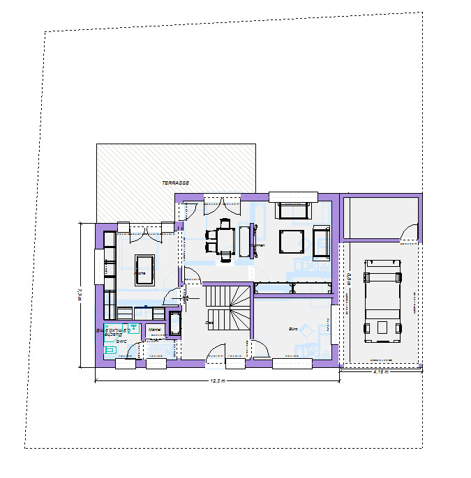

Hello housebuilding forum members,
I enjoy reading this forum and would like to share our planning for discussion. Our plot is designated as parcel number 173/6.
Plot size: 498 m² (driveway approx. 60 m² (645 sq ft))
Slope: No
Site coverage ratio: No development plan (§34 Building Code)
Floor area ratio: No development plan (§34 Building Code)
Building envelope, building line and boundary: 3 m (10 ft) from plot boundary according to Bavarian Building Regulations
Edge development: none
Number of parking spaces: 1
Number of floors: 1.5
Roof type: Gable roof with a pitch of 40-45°
Architectural style: Single-family house
Orientation: Ridge line East/West
Placement on the plot: Northwest
Maximum height / limits: approx. 9 m (30 ft) (§34 Building Code)
Immediate neighbors: North neighbor 1.5 floors with gable roof. South neighbor single floor with hip roof. West neighbor 1.5 floors with gable roof. Next-nearest neighbor south 1.5–2 floors with gable roof and knee wall >1.2 m (4 ft).
Owner’s requirements
Style, roof type, building type: Gable roof, knee wall 1.4 m (4.5 ft), single-family house
Basement, floors: Usable basement (concrete), ground floor, upper floor
Number of people, age: 4 (2 adults + 2 toddlers)
Room requirements on ground and upper floors: Ground floor (kitchen, living room, shower bath, wardrobe, office), upper floor (2 bedrooms, 2 children’s rooms, bathroom)
Office: Home office
Guest bedrooms per year: 0
Open or closed architecture: Tending rather closed
Conservative or modern construction: Modern
Open kitchen, kitchen island: Yes, no kitchen island
Number of dining seats: 6–8
Fireplace: No
Music/sound wall: No
Balcony, roof terrace: No
Garage, carport: Garage or carport
Additional wishes / special features / daily routine, also with reasons why some features are wanted or not:
Planner:
- Do-it-Yourself
What do you particularly like? Why?: Shower niches in the bathrooms, large children’s rooms facing west, L-shaped living-dining area instead of a narrow layout
What do you dislike? Why?: Upper floor bathroom, office located in the southeast instead of northwest
Cost estimate according to architect/planner: 580,000 EUR
Personal price limit for house including fittings:
Preferred heating technology: Air-to-water heat pump with underfloor heating.
If you had to give up, which details / extensions
- could you give up:
Office on ground floor (if replaced by usable basement space)
- could you not give up:
4 bedrooms
Requirements and many attempts with our furniture. As much garden as possible on the south and east sides.
How much clearance should be planned on the north side for the garage or carport? The passage should allow room for people and bicycles (bicycle shed planned behind the garage/carport). Is the overall design usable or have we overlooked something?

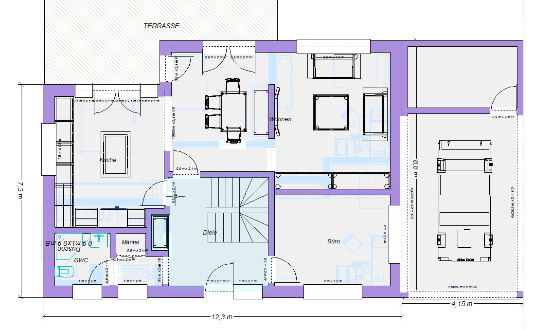

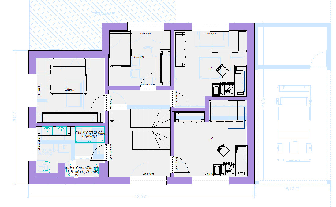

K a t j a schrieb:
You mean the kitchen door is better placed there?
Could you explain that again in more detail using your floor plan from #1? I’m referring to the one from 89. With the layout from 1, the staircase obviously doesn’t allow for a kitchen access there if that door is needed. So yes, you have to accept one compromise. That’s why the plan from 89 positions the cloakroom on the opposite side. The corner in the office isn’t ideal, but it’s measured so that our technical cabinet with the printer and so on fits there, which is great since we often print directly from our phones and just pop in quickly.
And yes, actually the kitchen door is better placed there. When moving around inside the house, it will probably be used less. It mainly serves as a quick access point to the sink and kitchen after grocery shopping. So when moving between the living areas, office, bathroom, basement, and upper floor, there’s no need to pass through there. Of course, you could close it off, but then you’d have to carry groceries through all the other rooms. I actually thought the sliding door was a pretty good idea.
hm, it’s nice that you’re trying to provide ideas, but:
The entrance simply doesn’t work for a (or our) family. Sometimes you can build entire sandcastles with the sand the kids bring in, and even without children around, we often come in with mud and dirt. It just doesn’t make sense to have to go through the entrance area to get to the bathroom or office. During the week from 7 a.m. to 5 p.m., this area, along with the kitchen, is probably the most frequently used space.
dieJulia schrieb:
Hm, it’s nice that you’re trying to provide ideas, but:
The entrance just isn’t suitable for a (or our) family. Don’t worry, I’m mostly doing this for fun and for readers who are genuinely interested.
dieJulia schrieb:
to then find their dream layout ...Thanks for the compliment—I think it’s nice too. And yes, it’s quite common for floor plans to suit other builders and their plots as well, unless you have to work around something very specific, like oak trees in Oakland.
By the way, we got a robot vacuum cleaner because our four-legged messy friends regularly dirtied the entire ground floor. It’s been like a relief ever since we got it. I can only recommend it.
