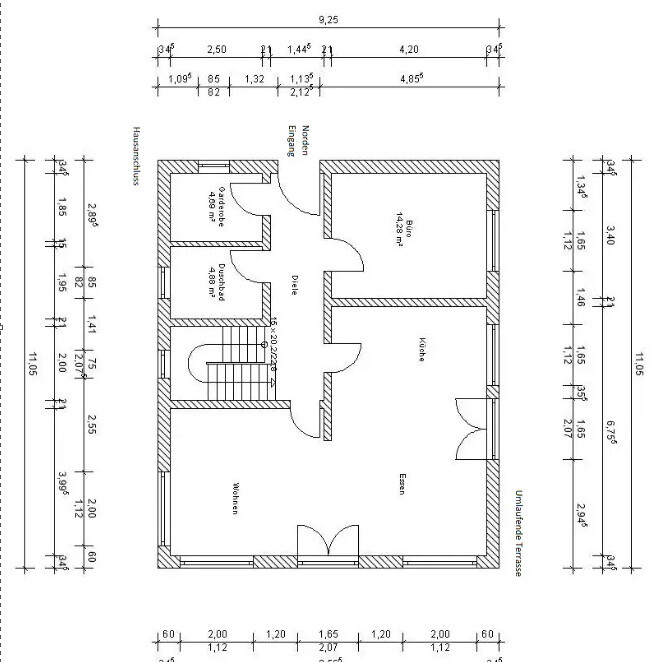

Hello housebuilding forum members,
I enjoy reading this forum and would like to share our planning for discussion. Our plot is designated as parcel number 173/6.
Plot size: 498 m² (driveway approx. 60 m² (645 sq ft))
Slope: No
Site coverage ratio: No development plan (§34 Building Code)
Floor area ratio: No development plan (§34 Building Code)
Building envelope, building line and boundary: 3 m (10 ft) from plot boundary according to Bavarian Building Regulations
Edge development: none
Number of parking spaces: 1
Number of floors: 1.5
Roof type: Gable roof with a pitch of 40-45°
Architectural style: Single-family house
Orientation: Ridge line East/West
Placement on the plot: Northwest
Maximum height / limits: approx. 9 m (30 ft) (§34 Building Code)
Immediate neighbors: North neighbor 1.5 floors with gable roof. South neighbor single floor with hip roof. West neighbor 1.5 floors with gable roof. Next-nearest neighbor south 1.5–2 floors with gable roof and knee wall >1.2 m (4 ft).
Owner’s requirements
Style, roof type, building type: Gable roof, knee wall 1.4 m (4.5 ft), single-family house
Basement, floors: Usable basement (concrete), ground floor, upper floor
Number of people, age: 4 (2 adults + 2 toddlers)
Room requirements on ground and upper floors: Ground floor (kitchen, living room, shower bath, wardrobe, office), upper floor (2 bedrooms, 2 children’s rooms, bathroom)
Office: Home office
Guest bedrooms per year: 0
Open or closed architecture: Tending rather closed
Conservative or modern construction: Modern
Open kitchen, kitchen island: Yes, no kitchen island
Number of dining seats: 6–8
Fireplace: No
Music/sound wall: No
Balcony, roof terrace: No
Garage, carport: Garage or carport
Additional wishes / special features / daily routine, also with reasons why some features are wanted or not:
Planner:
- Do-it-Yourself
What do you particularly like? Why?: Shower niches in the bathrooms, large children’s rooms facing west, L-shaped living-dining area instead of a narrow layout
What do you dislike? Why?: Upper floor bathroom, office located in the southeast instead of northwest
Cost estimate according to architect/planner: 580,000 EUR
Personal price limit for house including fittings:
Preferred heating technology: Air-to-water heat pump with underfloor heating.
If you had to give up, which details / extensions
- could you give up:
Office on ground floor (if replaced by usable basement space)
- could you not give up:
4 bedrooms
Requirements and many attempts with our furniture. As much garden as possible on the south and east sides.
How much clearance should be planned on the north side for the garage or carport? The passage should allow room for people and bicycles (bicycle shed planned behind the garage/carport). Is the overall design usable or have we overlooked something?
Hausbaurer
Site plan of the parcels with plot numbers and gray buildings on a pink layout
Floor plan of residential house with garage, carport, stairs, kitchen and living areas.
Floor plan of a residential house with multiple rooms, doors, stairs, furniture and dimensions.
Floor plan of a house with 4 bedrooms (Child 1, Child 2, Parents 1, Parents 2), bathroom, laundry room.
K a t j a8 Mar 2023 06:09
dieJulia schrieb:
No, I didn’t just make anything up on the spot. You’re simply ignoring it.
What exactly have I ignored? Please reread your original post. I have taken everything stated there into account. I even placed the office in the northwest, as requested. Besides that, there’s a smaller bathroom, a small second bedroom, the kitchen isn’t in a straight line with the living area, the guest toilet door isn’t located in the utility area (which it actually isn’t), orientation maximized for a south-facing garden, carport to the west, and the wardrobe is not next to the stairs — those were the main points. What’s missing?
What’s still unclear is which of your designs will actually be built? Is the one from ’89 the preferred option, or will it remain design #1? A site plan corresponding to each floor plan should be provided, and if trees are an important factor, it’s best to include them on the plan.

The tree stands on the south side near the western corner of the house and the neighbor’s fence and leans towards the northwest before growing straight up again. We already have to be careful ourselves not to make the space too narrow to be able to remove the tree. I measured the carport length of 4 meters (13.1 feet) and 9.25 meters (30.3 feet) this weekend, and it just about works. But there isn’t much clearance.
I mean this one
2D floor plan of a house with living room, kitchen, dining area, hallway, stairs, and terrace
Just without a door in the cloakroom.
But this topic is basically settled now because I find it really tedious. Many things are being discussed here that are common in standard catalogs. For example, #1: Of course I’m aware that bathrooms on the ground floor are usually located close to the entrance. But from my personal experience, I always thought that was rather inconvenient. However, I know that if the bathroom is tucked around the corner towards the back, like in our current apartment, it’s actually quite a good setup. I’m not inventing hypothetical situations that might arise; we are currently living with the bathroom only accessible from the front door via a 6.5-meter (21.3 feet) long straight hallway with a turn-off into a smaller hallway. In our old apartment, it was even further. Bringing up such hypothetical scenarios is just absurd.
And this shows the problem with the forum. Instead of simply accepting that the builders have already given some thought to their design, people rely on common practice because “everyone does it that way.” Instead of trying to understand the underlying concept and maybe offering a good idea for improvement, the idea is just to throw it out. I’m aware that these plans are not the ultimate solution; otherwise, they wouldn’t be here. But the solution can’t be to build something that doesn’t meet the requirements as well but is conventional.
I find it quite amusing because part of my work is to support clients when their own experienced professionals, through their standard approach, are no longer able to break their own patterns and thus implement requirements that come with new technologies. That’s exactly how some of these comments come across. Bathroom too small → Bad, build it bigger. Single-leaf patio door → not done in modern houses. Niches → not built. Floor-to-ceiling windows (which I personally find totally impractical) → needed nowadays. What a shame.
But, to say it again: there are good points among the comments, and I take those with me for our own plans.

K a t j a8 Mar 2023 14:19
Nobody who knows what they’re doing would keep tinkering with your designs and thereby make a bad plan even worse. Changing a few windows won’t enlarge the garden in design #89, and since there is no site plan, it seems from post #1 that it hasn’t even been realized that the neighbor’s garage or your own carport blocks light from the living areas.
The solution is therefore to "throw it away" and start over. That is exactly what was done, using the information provided in post #1 as a guide.
We have many discussions here where a professional plan or a well-thought-out self-design only needs minor adjustments, like rotating a door. In your case, considering the conditions and your own requirements, you are still quite far from that, in my opinion. The good news is that a general contractor will build you whatever you want, no matter how impractical it is. So just start building. To quote myself:
