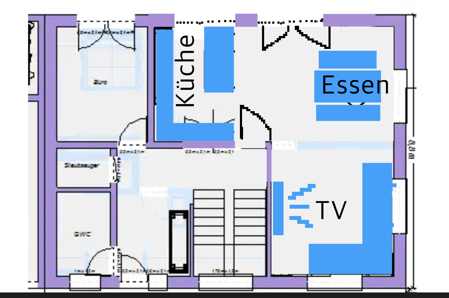

What can be clearly seen: the upper room doesn’t really benefit from the bay window. It simply doesn’t make a difference in how the room is used, even if there is half a meter (about 20 inches) more space. BUT the living room definitely benefits if you place the sofa there because then you have enough clearance to walk past.
I like Katja’s design!
This could also be an alternative, or did I miss this suggestion somewhere? It would be without the bay window.
You could also install a corner bench, which I think feels quite cozy.
Or put up a half partition wall to the living room and place the corner bench there, if you want some privacy from the living area.

I think placing the kitchen or the cloakroom, staircase, and guest toilet in the northwest corner is the most logical approach. In case there is no garage there, that’s fine. If there is, that’s fine too, as the car would be well parked there anyway, and we can easily access the house and bicycles from all sides.

#89 more or less. I like it too, maybe even better, but the living room is in the northwest. I’m a bit undecided about that.

dieJulia schrieb:
#89 kind of. I agree and even think it’s better, but with the living room in the northwest. I’m undecided about that.
Yes, that’s true, similar to #89, but I find the rest of the floor plan in Katja’s design better (so #103).
Hmm, I think I prefer a bright kitchen and dining area over having sunlight in the living room. You mostly spend time there in the evening anyway, when it’s usually already dark or the sun has gone down. That’s how I see it. So I don’t find it bad, actually I think it’s good.

Really? I would never place a door to the guest bathroom in the dirtiest part of the house. I also wouldn’t place the cabinets like that because, since the staircase is already positioned as it is, it makes sense to have it open or semi-open with a staggered wall.

Really? I would never place a door to the guest bathroom in the dirtiest spot of the house.
Do you mean the kitchen door would be better located there?
dieJulia schrieb:
I wouldn’t place the cabinets like that either, because if the staircase is already positioned like this, it makes sense to keep it open or semi-open with a staggered wall.
Could you please explain that again in more detail using your floor plan from post #1?
