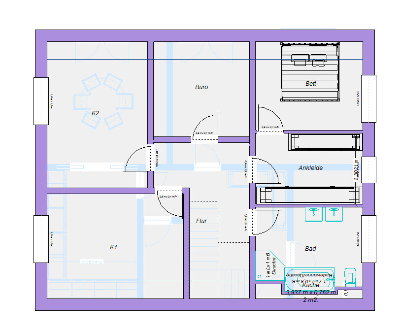

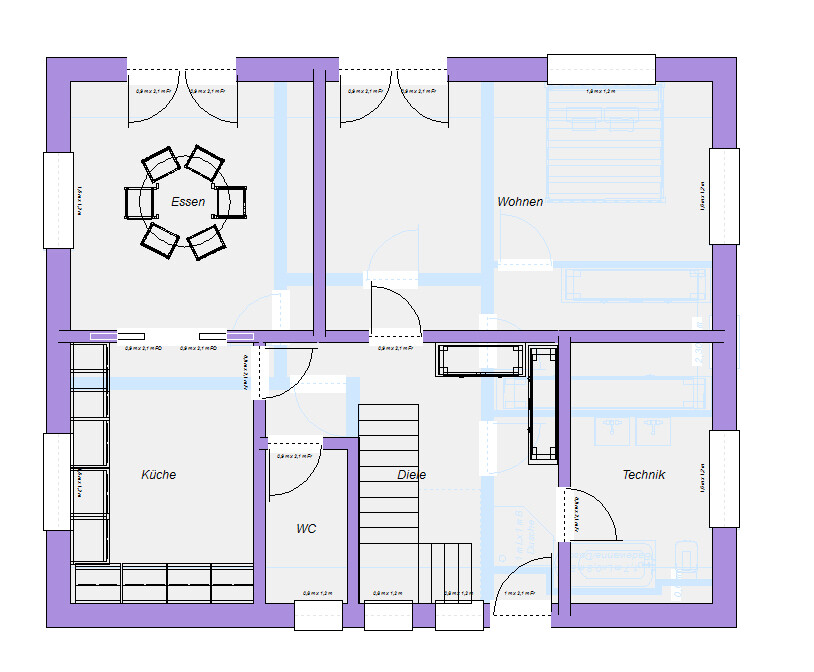

Ground floor: kitchen with natural light from three sides.
Upper floor: large children’s rooms, space for desks

Relatively narrow bathroom / utility room
Relatively narrow passage behind seating area in kitchen—will that work?

Is the staircase design feasible as shown without causing disruption? Are there bottlenecks or places for improvement?

What I find less successful is that the kitchen-dining area feels very narrow and tunnel-like. The living room, on the other hand, has plenty of space. I would consider shifting things around to give the dining area more room. Right now, it’s also difficult to access the terrace.
Upstairs, I feel a lot of space is wasted and the layout doesn’t quite come together. Attached is an alternative for the upper floor (stairs without a landing):

I have never understood the staircase at the entrance (for the reasons mentioned above), unless it is a genuine space-saving design or has to fit within 109sqm (1173 sq ft).
Basically, I find the nearly 40sqm (430 sq ft) hallway somewhat generously planned.
I don’t like the open-plan kitchen at all. It’s too narrow and too long. There is no room for a cabinet next to the table. In addition, the kitchen will be very dark. Light from the south and west windows won’t reach the work surfaces. The terrace door is blocked by furniture. If only one chair is occupied, people have to squeeze past.
The west-facing windows aren’t very useful in winter. Sure, the living room gets some brightness, but that’s not where you really need daylight.
I don’t find the bathroom too narrow. I’d rather have it this way than have an unpleasantly large, empty space.
The storage room, i.e. the utility room, at 9sqm (97 sq ft) is borderline too small for four people.

Regarding the staircase: Your point is valid and makes sense. At first glance, I couldn’t find an alternative to the current staircase. It would have to be rotated or in a U-shape. Maybe I’ll come up with something else.
Hello Katja: Thanks for the quick draft. The idea with the offset in the kitchen wall looks pretty good. We actually have some extra space in the living room, so we’ll give it a try.
Your upper floor draft with the separate office doesn’t quite match our expectations. Whether I have an office or a larger hallway with a desk and two cabinets, the space is the same. I’m hoping the sense of space will improve when you come upstairs and don’t just see doors.

I’m hoping that the sense of space improves a bit when you go upstairs and don’t just see doors. In that case, you’re looking at a workspace for four people – PC, printer, filing folders, and paperwork. Lots of cables, and so on.
Keeping a desk and its surrounding area tidy rarely works for most people.
Where is the vacuum cleaner supposed to be stored?
