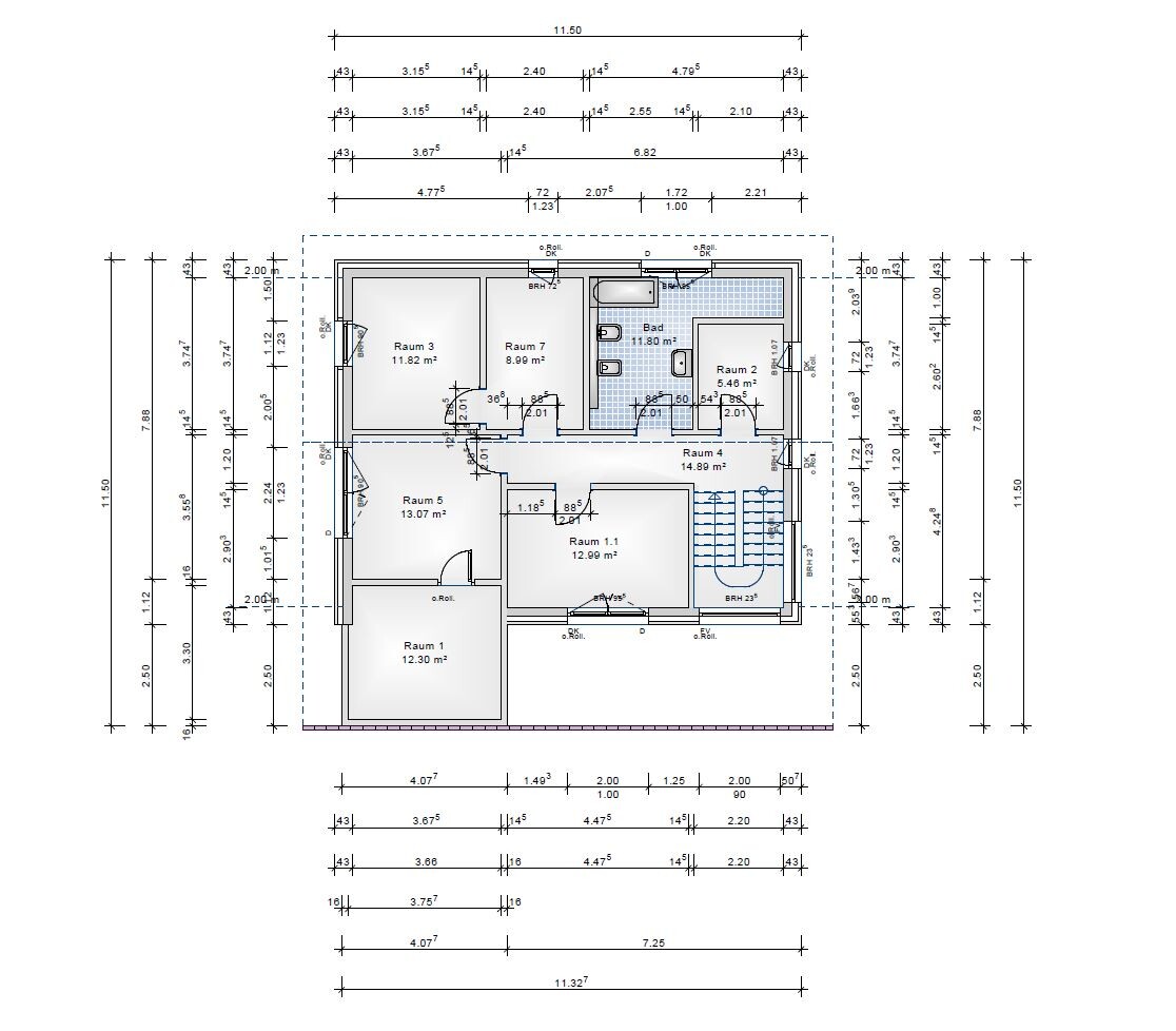

Upper floor bathroom is still very large; could be smaller

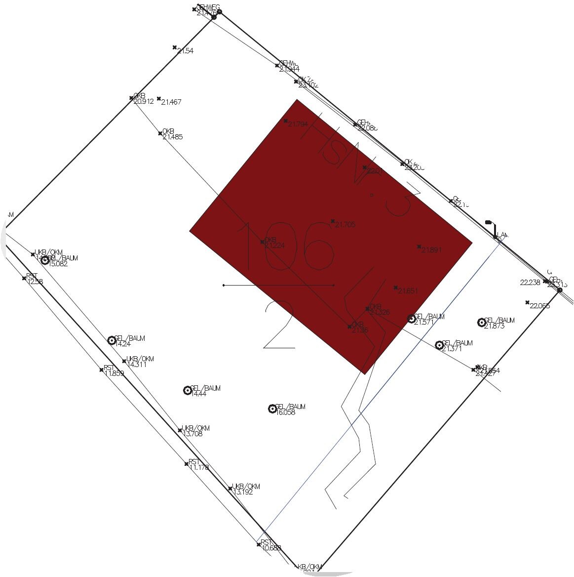

The plot has a towel-shaped plateau measuring 22 m (72 ft) wide and 7-10 m (23-33 ft) long. The house’s mass will be placed there. A seating area/garden is planned to the west with access from the kitchen via a few meters of wooden terrace. The slope on the south side drops steeply. The garage and a parking space at the driveway will be located on the east side.

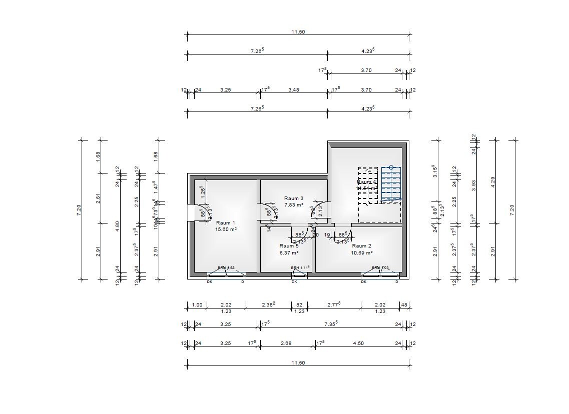

Site plan: red rotated square marks building area in the floor plan with measurement lines.

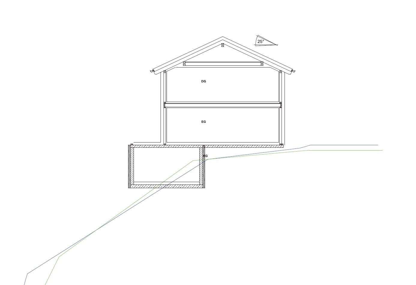

Cross-section of a house with basement, ground floor (GF), and attic floor (AF) on a slope, gable roof.
Floor plan: living room, dining area, kitchen, bathroom, bedroom, hallway, stairs, north arrow.
Floor plan of a house with three rooms (Room 1, Room 2, Room 3) and staircase.
Floor plan of a building with several rooms, staircase, bathroom, and measurements.

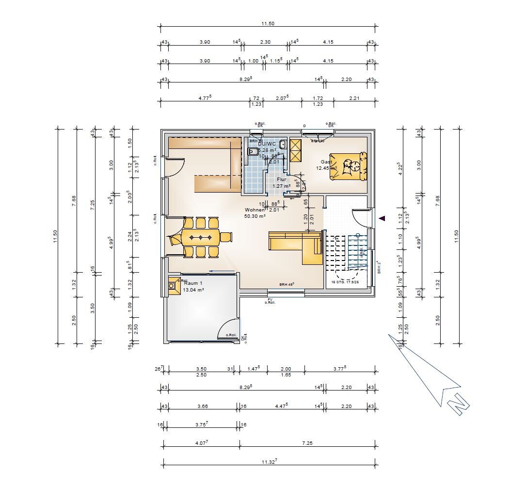

haydee schrieb:
The two entrances and the staircase take up a lot of space that you miss in the open-plan area. The wardrobe actually accounts for 1.5 m² (16 sq ft) of hallway, even if it is not officially designated as such.
In our previous design, we only had one main entrance; the only thing that benefited from that was the downstairs WC, which I have to say is perfectly sized for me.
So yes, we considered that option because it initially seemed obvious to us, but the position of the staircase in the center of the house provided the best access to the upper and lower floors in this layout, so we decided on this version.
haydee schrieb:
Make sure to properly draw all the furniture to scale and include the necessary circulation space.
I’ll do that later. We did it in an earlier draft, but not yet for this version—I'll get to it. I can say that we have already seen the floor plans furnished at full scale and made some small changes based on what bothered us, although we also realized that this arrangement offers significant flexibility on the upper and lower floors. Only the ground floor is fixed and can’t be changed much. That’s mostly due to the way the rooms are oriented relative to the cardinal directions and the slope of the site.
But designing the entire house around a lifestyle that is neither obvious nor flexible only leads to dissatisfaction.
For us, the compromise is not that big. Sure, you could add about 5 m² (54 sq ft) on the ground floor, but that space tends to get filled with things you don’t really need and that don’t improve your quality of life.
Maybe this thread can be concluded with the understanding that this house design won’t suit everyone’s taste, but for our budget, lifestyle, and preferences, it certainly isn’t a complete misdesign.

On the ground floor, you spend the most time.
You have assigned 42 sqm (about 452 sq ft) to living areas. Part of that is the unfurnished kitchen, and part is the cloakroom-hallway area. There is a 17 sqm (about 183 sq ft) hallway that is unfurnished. The reading area — a quiet zone — is located between the kitchen, dining, and hallway, meaning it is right in the busiest part of the house.
Putting aside the slope and the two-family house design for now, ground floors are often planned with the following considerations:
The kitchen should be as close to the terrace as possible.
A 4 m (13 ft) width for the living area is reasonable given the current TV sizes.
The staircase should not be next to the main entrance door. How often do you pass by the front door in less-than-ideal lighting? And sometimes it even has glass panels.
The cloakroom should be next to the entrance. With two doors and two storage areas, shoes and jackets always end up by the wrong door.
In the basement, you also have a lot of unused space. A large hallway, a dressing room with few wardrobes but a lot of circulation space, and a conservatory that will significantly heat up the sleeping area.
I would recommend reconsidering the room layout and not taking the two-family house concept into account for the staircase placement. That does not mean the staircase should be open to the living space.
haydee
21 Oct 2021 15:01
Plan a step-free path to the garden. A hand truck, wheelbarrow, etc., must be able to go down and back up with a load.
