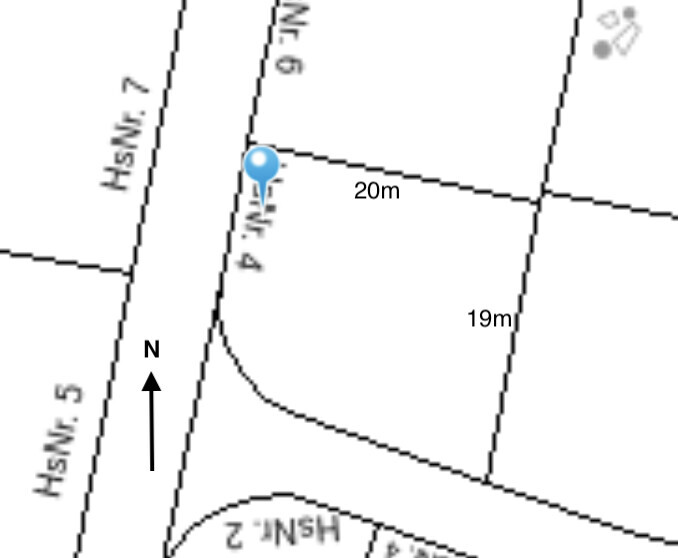

Building envelope, building line, and boundary – see image

Orientation – see image

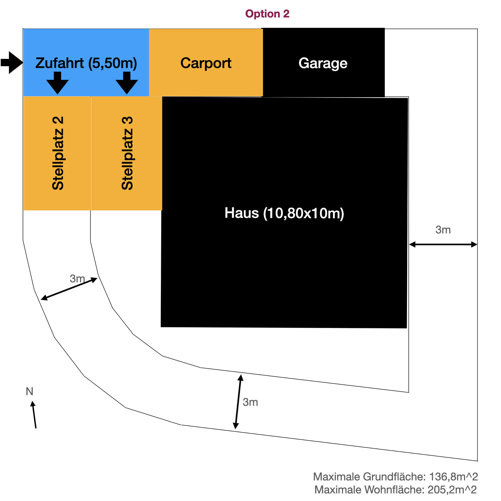

The house planning will start in the next days and weeks. Since no rooms are planned yet, I would first like to focus on the surroundings, especially the integration of the garage and parking spaces.
As a basis for discussion, you will find some initial options illustrated here. The house dimensions are still flexible at this stage. One idea is to combine a carport with the covered entrance area, positioning it directly in front of the garage. This carport, however, would not count as an official parking space, so the other two (if approved by the municipality) could also be used for turning on the property.
How would you arrange and design the parking spaces and house layout in a practical way?

First of all, thank you for the clear visual separation of the answers in the questionnaire. I am noticing several contradictions: no slope, but the living floor is on the upper level; "solid construction," yet the inspiration design (without the desired granny flat) comes from a timber frame panel builder.
The parking spaces will require an access width of about 8 meters (26 feet) in option 1, and very short cars with four-wheel steering in option 2.

A valid point regarding no slope but living area on the upper floor. Apart from it being uncommon, is there anything specific speaking against it? Of course, carrying groceries upstairs is clear.
The house floor plan will be discussed and developed with the building company starting next week.
Regarding the parking spaces in option 1, I initially see the driveway width as less critical; your concern about option 2 is justified.
Would you arrange the parking spaces differently here or plan the house dimensions to be more elongated or wider?

That is a lot of house on a small plot. In my opinion, the site is completely unsuitable for your project. But let’s take a closer look:
I also consider option 2 to be nonsense, as @11ant already pointed out. For option 1, the question is whether the driveway is too close to the curve. I would check that with the building authority, ideally before submitting the building permit / planning permission application, either as a brief preliminary inquiry or, even better, with a sketch in hand. The driveway being at least 8m (26 feet) wide wouldn’t bother me at first. What I do not see is a carport and garage in a row, because that quickly exceeds 9m (30 feet) of frontage development. This is generally the maximum allowed length for one boundary – unless your zoning plan or local building regulations say otherwise.
Aside from that, I see the parents living entirely on the ground floor, including utility and staircase areas, bedrooms and bathrooms on the first floor, and a common living area plus roof terrace as desired in the attic. If there is still budget left, a basement could be added. However, the budget has been kept secret again, so I assume that’s not feasible.
I would try to avoid having the front door inside the driveway leading to the garage. Even the smallest doorstep for the front door would be completely in the way. Also, the car often ends up parked right in front of the door, which is annoying.
In the end, you shouldn’t expect space for children to play in any kind of "garden," or even to sit on a lawn yourself, unless the parents invite you onto their (probably built-over) terrace. As we can clearly see, there is no room left for a terrace. By the way, this counts towards the floor area ratio and is usually not allowed in the setback zone (unless your zoning plan or state building code says otherwise).
