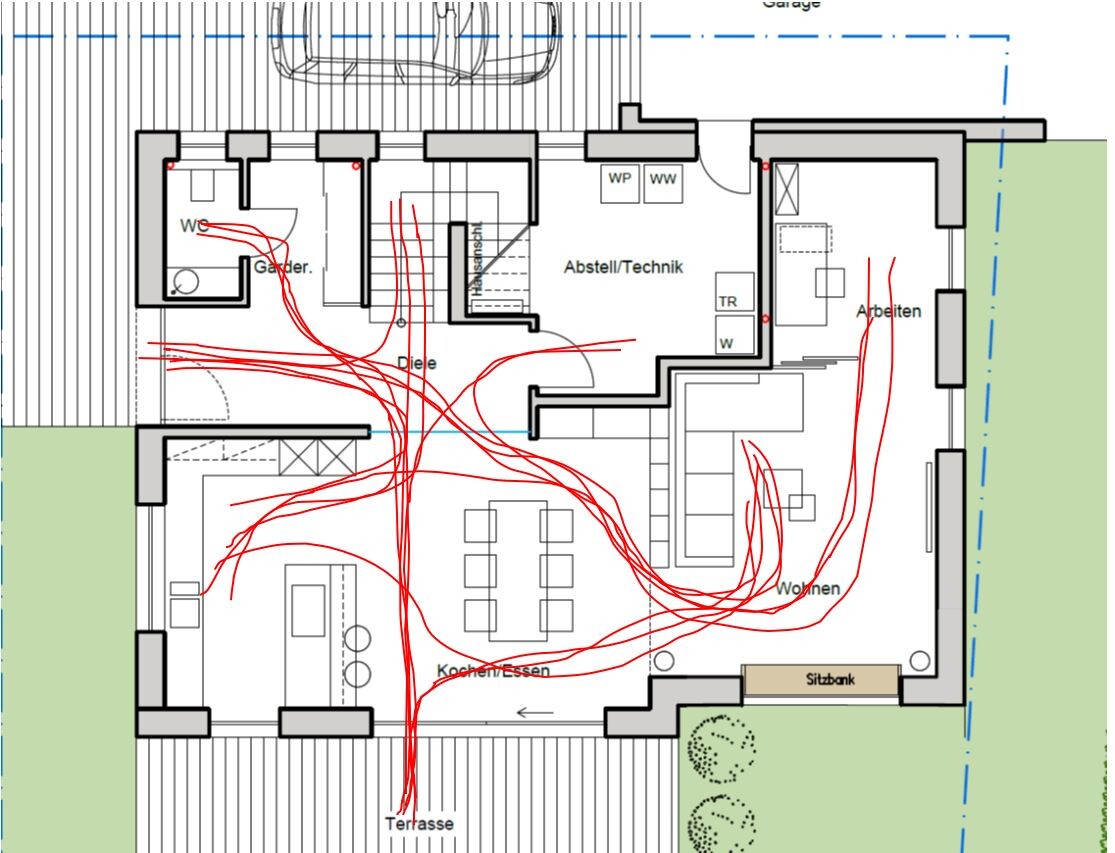

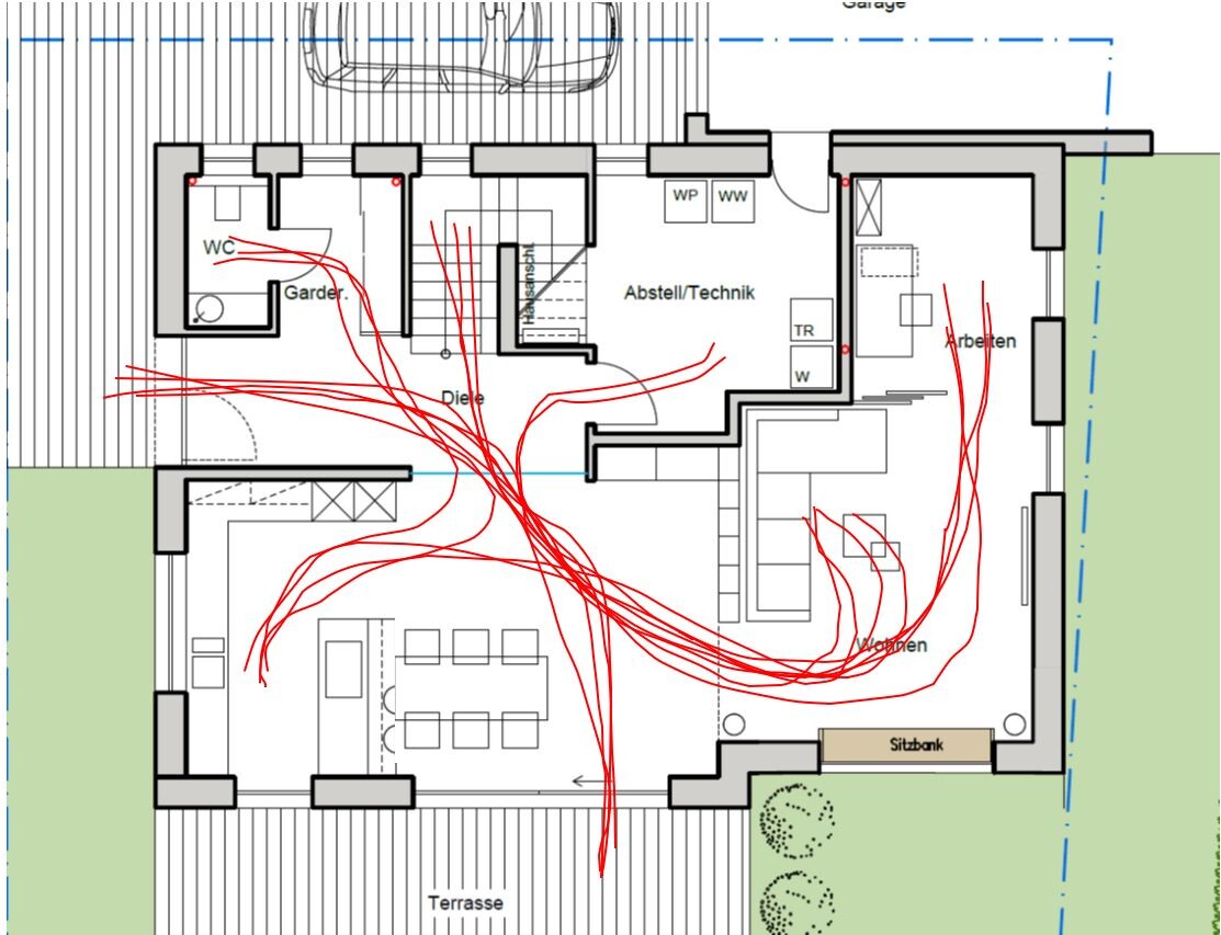

Well, in this case, the table is placed right across the door...
So far, we have only roughly outlined the attic floor. To the west, there is a children's room; to the east, a study; and in between a small storage/utility room with the mechanical ventilation system for controlled indoor air quality.
askforafriend6 Feb 2022 00:27
Personally, I would never push the dining table against the island—unless you really have space issues! Limited access to the island (drawers, etc.) combined with losing a seat at the end is not a good deal, but at best a compromise due to lack of space.
V
Varrader
6 Feb 2022 07:51
@askforafriend I would rather see it this way, as the position allows me to have an extendable table. You’re right about the drawers, in case the space is needed.
Ultimately, I’m concerned about the traffic flow, having to walk all the way around the table. But maybe I’m overthinking it...
This would determine whether the sliding door opens to the left or right. Of course, that also affects how you can or want to arrange your seating area on the terrace.

K a t j a6 Feb 2022 08:11
I don’t see any issues with the walkways here. The important thing is that they are there and not obstructed. Personally, I wouldn’t attach the dining table unless it provides significant space advantages. You lose the working area on the other side of the island. Of course, some people swear by sitting right next to the cook so that mom can serve breakfast plates directly from the front. I think it’s all a matter of personal preference.
