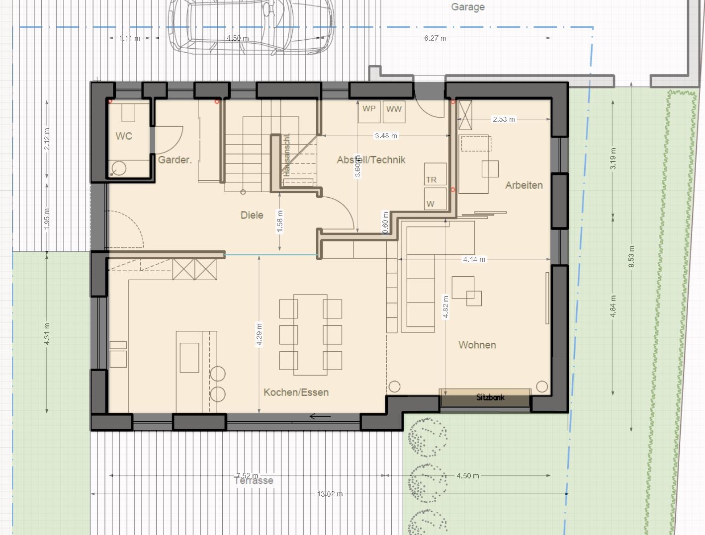

The arrangement of the south-facing rooms on the ground floor and the small study, which can feel connected to the living area when the door is open.
We also like that the staircase on the ground floor faces the living areas rather than the front door.
What do you dislike? Why?
We want to enjoy as much of our garden as possible, so our basic desire was to build a narrow but long house. In this design, however, the current platform staircase is very large and feels overwhelming in the hallway area.
On the practical side, this staircase also allows direct access to the attic with the same stair flight.
Price estimate according to architect/planner: €500,000
Personal price limit for the house, including fittings: €550,000
Preferred heating technology: geothermal heat pump
If you have to give up anything, which details/finishes
- can you do without:
- can you not do without:
Which wishes from the architect have been implemented: spatial plan discussed with the architect
We are worried about missing a good idea; we sometimes lack the creative input to find solutions that are a bit outside the box.

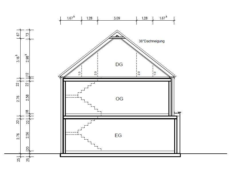

The arrangement of the staircase and the spatial feeling when entering the house are our main concerns. The staircase shapes the entire concept upstairs.

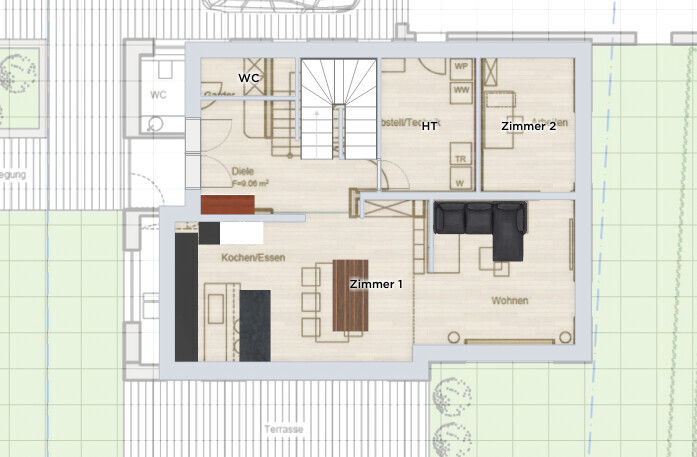

I’ve attached an alternative ground floor plan, where we try to reach the upper floor with an L-shaped staircase. However, this requires a second stair flight to access the attic, which also takes up space...
We look forward to your critique and suggestions!

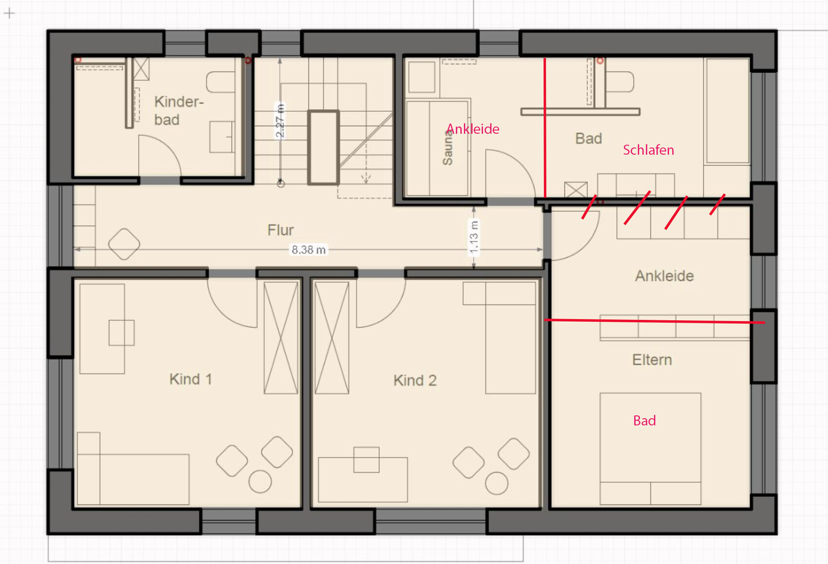

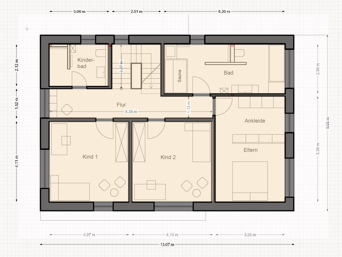

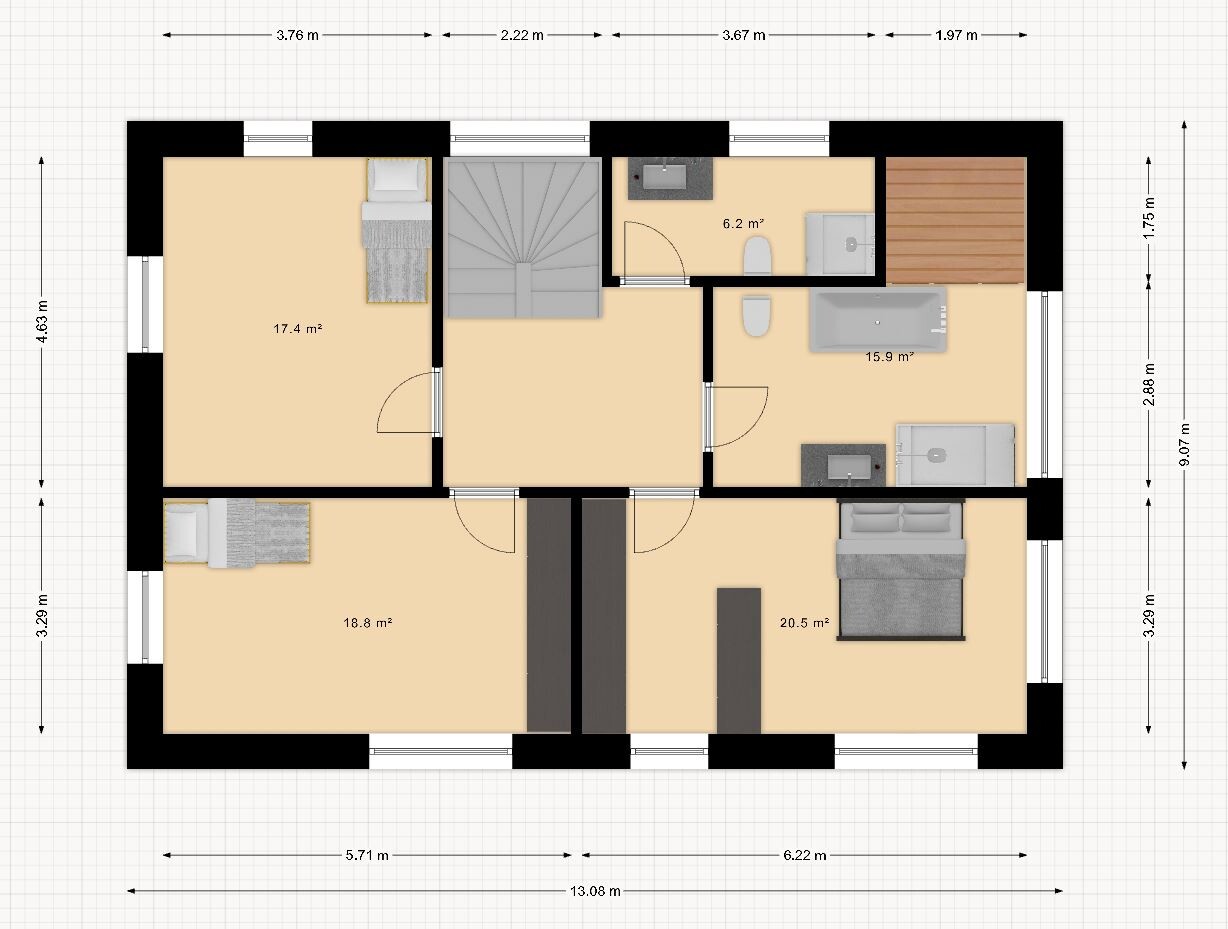

@SoL Yes, we are considering it. The ultimate solution would be something discreet from the hallway so the kids can easily access it. Currently, we even have a laundry chute from the bathroom to the utility room, but we don’t use it at all. We find it inconvenient to sort the laundry only downstairs in the utility room. We sort it in the upper floor beforehand, using a simple 4-cube Kallax with 4 fabric bins where we separate colored, white, and heavily soiled laundry (plus a bonus compartment).
I had planned to wait for our architect, but that's easier said than done...
Using the space to the left of the staircase is somewhat tricky. It’s too small for a regular room but too large to be efficient as the children's bathroom. In the latest version, the staircase at the bottom is narrower and shifted slightly to the right (which the ground floor layout allows). This could make room for a child's bedroom there.
Of course, this would make the hallway feel much less open, and the window facing west would be lost. Perhaps some light could still be brought in through skylights above the bathroom doors.
The bedroom’s current south-facing position is actually not ideal; a child’s room would benefit more from this location. The master bathroom is now quite spacious; there would even be room for a sauna.
Alternatively, the children's bathroom could be moved to the right, and the hallway extended northward to reach a window.
(Note: Yes, I know the architect’s upper floor design looks much better overall. But I’m really bothered by the small master bathroom. 😀)

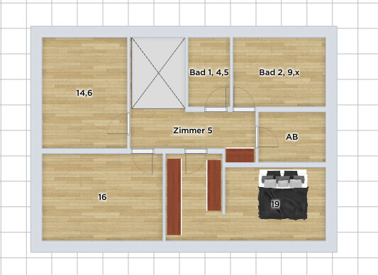

Myrna_Loy4 Feb 2022 11:20Varrader schrieb:
So, a new attempt from the architect.
Unfortunately, it still doesn’t feel like a “wow, this is how we do it” moment. And why not? What bothers you?
Off the top of my head, I would do it like this:
