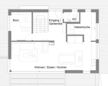

I’ve attached an alternative ground floor plan, where we try to reach the upper floor with an L-shaped staircase. However, this requires a second stair flight to access the attic, which also takes up space...
We look forward to your critique and suggestions!

Alessandro4 Feb 2022 11:25The only thing that would bother me is that the master area is directly adjacent to a child's bedroom.
I would also arrange the sink in a T-shape, but apart from that, I like it.
I don't find it very balanced either. In my opinion, these zigzag walls don’t create a sense of zoning yet but just make the space feel unsettled. The recess in the living room also seems more like a desperate attempt. Considering the terrace location, I would rather extend forward than back.
Basically, we feel that the layout of the living area on the ground floor still doesn’t quite work. The kitchen is generously sized, but the space around the dining table feels rather small, and the path to the study at the back, past the sofa, could also be tight. The circulation routes go all around the dining table on every side.
@K a t j a already pointed this out correctly... Regarding the recess in the living room: so far, we see it more as a projection in the kitchen/dining area 😀. However, we also see it as (a necessary?!) cost factor to make the area around the dining table wider. As mentioned, the kitchen does not need to be that large for us. We also view the island more as a room divider rather than an absolutely necessary workspace.
In contrast, the upper floor seems very generous in terms of room sizes. A walk-in closet in the master bedroom is not important to us, and the master bathroom is now extremely large. A sauna is really not necessary, especially considering the rising construction costs.
@Myrna_Loy We’re not too fond of having the bathroom directly adjacent to the bedroom as an enclosed space; if anything, we would prefer at least a walk-in closet as a “buffer” in between. And in that case, I would find the walk to the bathroom quite long, only to find out that it’s occupied 😀.
Overall, I somehow find the architect’s previous floor plan better, except for the master bathroom being too small—I’m just not entirely sure why.
The attic floor doesn’t seem to be properly integrated into the design. Yes, we plan to use it as an extra office, space for the mechanical ventilation system, and a child’s bedroom, but it still offers about 50m² (approx. 540 sq ft) of living space (roof slopes correctly accounted for). We just feel that with clever planning, everything could fit into an 8x12m (26x39 ft) footprint instead of 9x13m (30x43 ft)—probably the truth lies somewhere in between.

pagoni20204 Feb 2022 16:11I’m not sure if I’m assessing this correctly, but the focus seems to be on the TV. If, for example, the TV could be moved into the adjacent study, the living room could be designed completely differently and with more windows. Maybe also place the sofa against the wall, facing into the room. Is there a reason why there are so few windows in the living room? Do you already have living room furniture or know how you want it arranged? Currently, the living room is practically a walkthrough room to the study, and the recess makes the living room unnecessarily tight in that area.
Regarding the dining table location and the tight space around it: maybe you plan the kitchen so that the dining table is directly next to the island, which would bring it closer to the kitchen. We arranged ours like this, for example. The table can be a bit longer to accommodate enough people and would then be placed across the room, with the long side parallel to the window. Try sketching this out on paper — for us, this decision freed up space in many areas.
Depending on its use, I wouldn’t install a sliding door between the living room and study. If anything, a regular, nice door would be better. Good-quality sliding doors are expensive and are usually left open anyway, so I would just keep this option in mind. Over time, you’ll notice how the space is actually used and how it feels. Some habits and preferences can’t really be predicted in advance — we’ve just realized that again ourselves.
But overall, it’s a nice floor plan. Now you just need to fine-tune it a bit and add your individual preferences.
Bertram1004 Feb 2022 16:20If you don’t really need an island in the kitchen, I would go for a nice L-shaped kitchen with a large table in the middle. Like the traditional farmhouse kitchens, but without the rustic style (for those who don’t like that). This way, you sit in the kitchen, it feels cozy, and there is plenty of space around the table.
Then you could separate the space from the living room with a half-height shelf, an attractive piece of furniture, or a partial wall. That would leave a lot of open space between the kitchen and living room, but I wouldn’t find that a problem. The space can also be nicely decorated with plants using a room divider. 🙂
@pagoni2020 Honestly, TV is not important to us at all. Just relaxing in the evening to watch a series from the sofa, or some kids’ shows on the weekend.
We currently have a 55" device at a viewing distance of 3.8m (12.5 ft), which is enough for us. If I consider a 65" for the future, that puts me at just under 1.5m (5 ft).
We have a south-facing corner seating window, which we see both as a usable extension of the seating area when we have more guests, and also as a way to enjoy a nice view of the garden.
We have living room furniture, but not a single piece takes up even half a square meter of living space—if it fits, great; if not, no big deal.
I really like your idea of placing the dining table near the kitchen island. If we did that now, it would just mean walking straight from the hallway into the table, or looking up from the table into the hallway. If we were to do it, we’d probably have to swap the kitchen and the sofa area (I’ve attached what I think is a great floor plan from Baufritz (Musterhaus Heimat) that shows this setup, except for the entrance coming from the “wrong” direction). Apart from that, Baufritz really has some amazing floor plans—nice clean lines, yet very cozy, and we often really like their style.
@Bertram100 We’ve thought about it too, but we find it rather uncomfortable to be “boxed in” by the kitchen like that.
