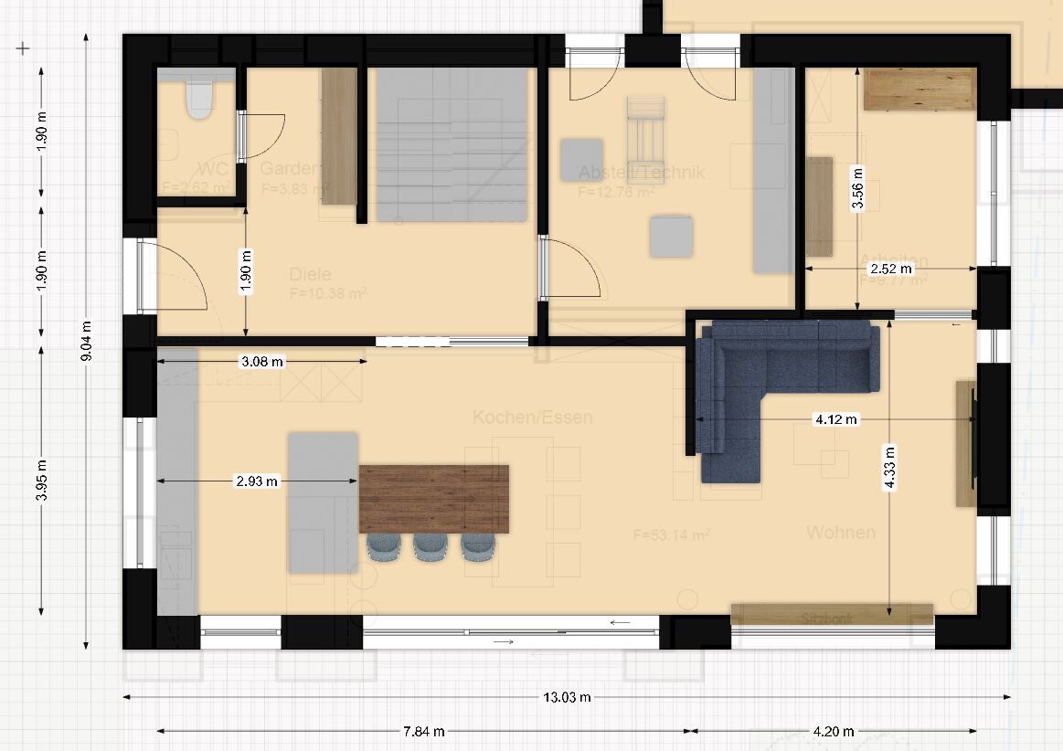

K a t j a schrieb:
In my opinion, these zigzag walls don’t create a zoning effect yet; they just appear restless.No zigzag wall without a piano! – right, @chrisw81?https://www.instagram.com/11antgmxde/

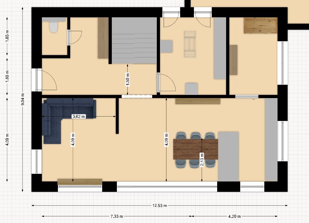

@K a t j a Thank you very much for your work. Seeing the basic dimensions planned so differently is really helpful.
We really like the solution for the upper floor.
On the ground floor, we find it uncomfortable that you enter the kitchen immediately after the front door. The guest toilet and office could be significantly smaller, and we would omit the partition from the living room. With the sofa arrangement shown there, we would wonder where to place a TV on the wall; we would definitely have a large south-facing window overlooking the garden.
Regarding a straight staircase, that would mean long walking distances to the upper floor for us; in our view, a half-turn staircase or a staircase with a landing is clearly more advantageous.
We tried docking the dining table to the kitchen. In the current floor plan (we removed the recess in the dining area and slightly reduced the hallway towards the top of the plan).
In our opinion, this benefits the room layout very well; however, you no longer approach the window from the hallway, but the dining table instead. And people sitting with their backs to the window now face the hallway.
Alternatively, there is the Baufritz version where the sofa is placed on the left. The “problem” with the walking path from the hallway toward the window is solved here, but the staircase must be moved further to the right so that when coming down the stairs, you enter the living room and not face a wall.
The room divider by the sofa should be half-height and provide space for the TV.
