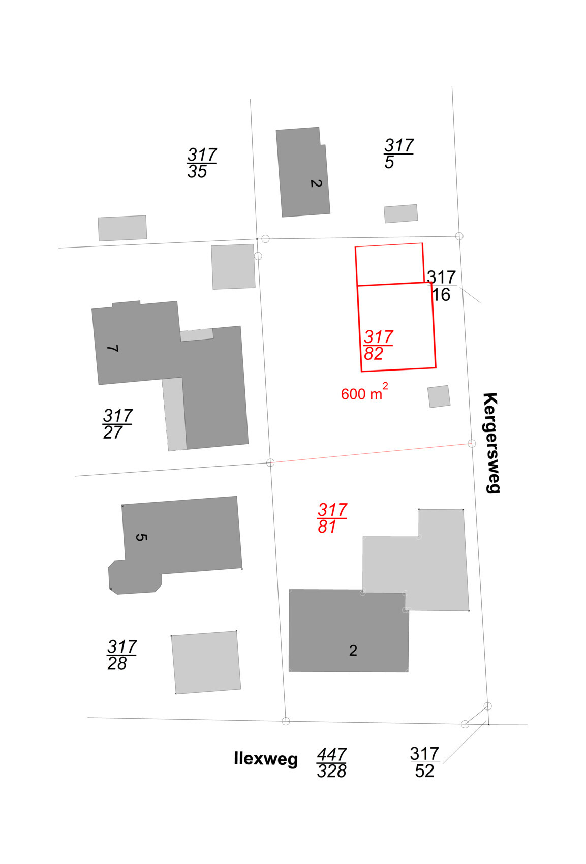

Currently, my wife and I are planning a single-family house on a 600m² (approximately 6,458 sq ft) plot and are working with the architect to finalize a design for a building permit / planning permission application.
Plot size: roughly 600m² (approximately 6,458 sq ft)

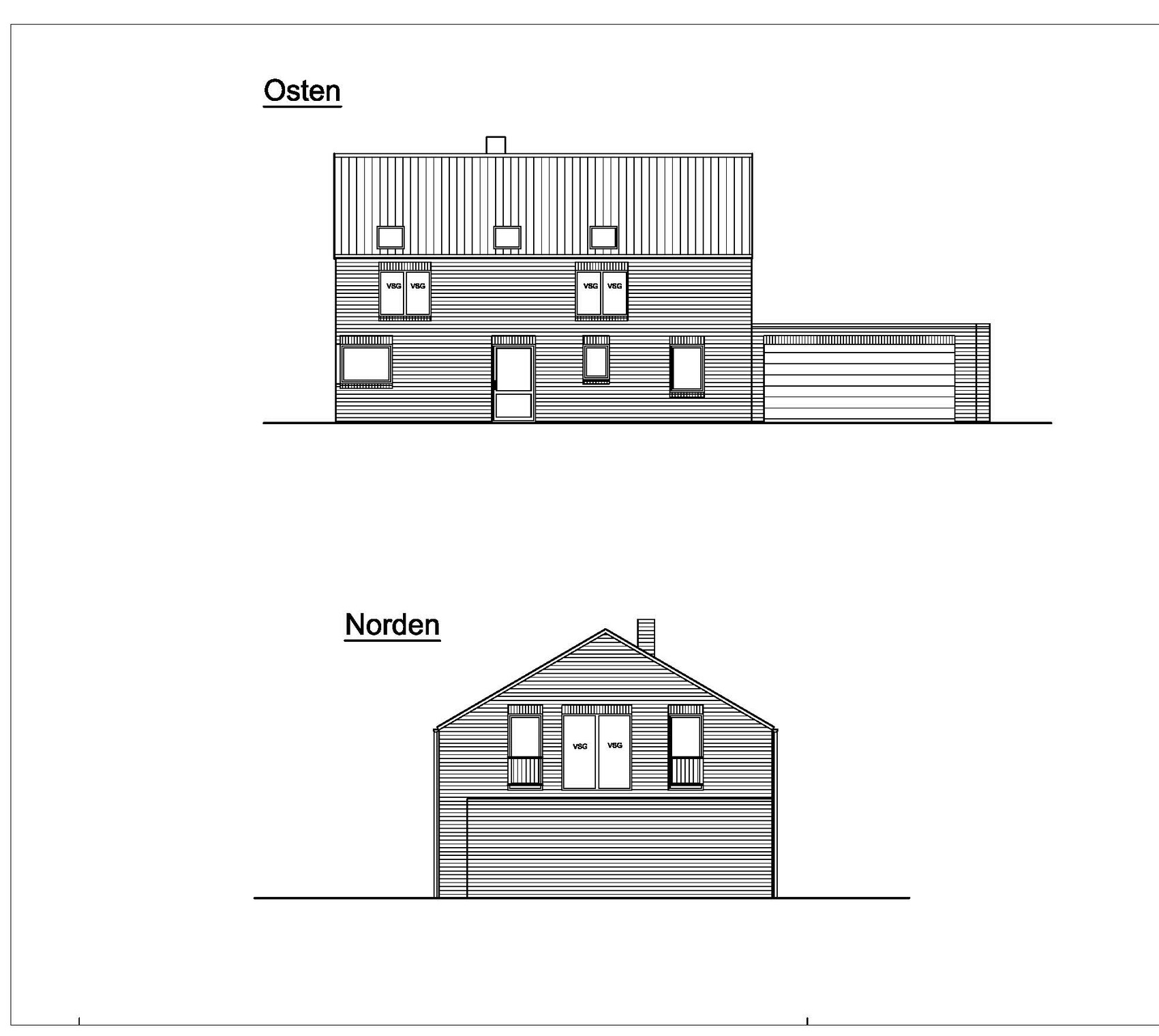

pagoni202016 Dec 2020 20:48Ruksson schrieb:
The TV isn’t meant to be on the chimney wall, but on the office wall.Can’t you move the TV into the office and do exactly what you like there? Then the living room can be a nice living room with a view outside, rather than the other way around, and not a room overloaded with TV + special staircase + small fireplace + favorite huge window. Often, rooms are overcrowded with purposes, and that’s exactly what I see here. As @Alessandro already mentioned, the fireplace will become significantly larger; you’ll need fireplace tools and accessories, and some wood should be stored nearby. Depending on the fireplace and personal preferences, the fire might then be too close or produce too much heat, etc.I still think you have too much depth and not enough width. There is empty space between the sofa and window, as well as between the seemingly endless kitchen cabinetry / island and the window. That kind of space is missing elsewhere, and in real life, a few centimeters can be crucial.
I see you’ve now rotated the sofa, but it’s directly in front of the built-in shelves with their back facing the wall; at the dining table, the fireplace will heat your back.
You really should consider gas fireplaces, but only high-quality models. These days, they have excellent heating performance, and you could extend more lengthwise AND – very important – control the flame/heat individually. This is no longer cheap stuff; check how they are used commercially, e.g., in hotels. If I had chosen gas, a long tunnel gas fireplace would be my first choice; however, I already have a stylish wood fireplace from Monolith here, so that one will be installed in the house.
I would place a fireplace rather on the wall panel between the two glass areas. There’s space there, and you can see it from everywhere. A fireplace in the spot you suggested won’t bring you joy in the long run; it will cause problems instead.
You then won’t have a proper TV area and end up with a compromise—and that keeps happening until it becomes a jack-of-all-trades, master-of-none.
I strongly recommend loosening these fixed ideas (5m (16 feet) window must be here, staircase must be like this, etc.) and really examining your habits. You are building a house and enjoy watching TV but have a mediocre solution... better to let go of a few things and implement fewer aspects really well. That’s my credo.
First plan the usage, then place the windows in the right spots, clarify living room use, and so on.
You do have the possibilities for this.

I’m wondering about what @pagoni2020 mentioned regarding planning 5 meters as two elements. Do you know how heavy 5 square meters (54 square feet) of glass is? Does that even exist? Here, we have 5 meters (16 feet) divided into two elements (wood-aluminum), which is already quite heavy. You need to be aware of that in advance. Anything other than lift-and-slide would have been out of the question for us. It’s simply fantastic to be able to open the entire area.Also – just like @ypg – the staircase starting in the open-plan living area. With kids, I would never ever do that! It looks nice (in our opinion), but it’s also noisy! Perfect for two people, and I would do it again anytime, but not with children!
And say goodbye to that cold hallway where you first have to walk to the stairs. In a house like this, nothing is cold anymore, and the hallway is just as comfortable as the open living area.
Fireplace… well. Whoever sits at the table with their back to the fireplace will quickly move away from there. It’s too close! Also, you feel like you’re running directly in front of it when coming from the hallway. By the way, the dining table’s positioning looks like “an afterthought”: it’s as if it was just squeezed in somewhere because the table needs a place. This should be planned carefully together with the kitchen and the large door! Unfortunately, it doesn’t look that way here.
I often read “my wife thinks it’s nice,” “my wife would like,” “my wife wishes”… but unfortunately, she often wishes for many things that are quite impractical.
I’d strongly recommend reconsidering the orientation of the TV setup on the office wall – also because of the incoming light! The seating position is uncomfortable (this has already been mentioned several times).
The storage space on the upper floor is a mess in that spot, but that has also been mentioned several times.
Try to let go (or get your wife to let go) of conventional ideas!

In addition, despite having large windows, I would install a regular door leading outside, not just lift-and-slide doors, as in my opinion these tend to become harder to operate.Yes, the five-meter (16.4 feet) section should not be designed as a lift-and-slide door but as a folding door system. Ideally, with a mullion and a hinged door as the kitchen exit.https://www.instagram.com/11antgmxde/
thank you again to everyone for your opinions and suggestions.
As the saying goes, tastes vary. I am very grateful to everyone who shared their views here for the valuable input.
In the end, we have decided on a floor plan similar to the one I posted. We are aware of the advantages and disadvantages as well as possible given our situation, and we are very curious about the feedback from the building authority regarding the application.
According to the application documents, our planning should comply with the zoning plan (single-story).
Whether we ultimately like the living room, whether the fireplace will feel too close behind us, if the hallway has too many doorways, or how the large window element will be implemented, will become clear over the next few months.
