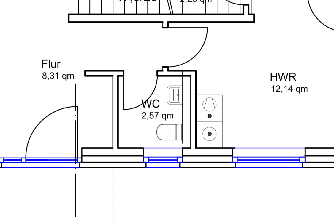

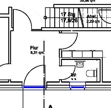

I’m happy to keep interested parties updated and will share updates in the thread from time to time.Gladly, it will surely be a very nice house. Regarding the toilet and utility room, I have a suggestion that could provide you with additional large shelving space in the utility room (instead of just a passage) and free the hallway from this extension – now it is nicely symmetrical and square-shaped. A smaller toilet is also sufficient. matte1987 schrieb:

Additional large shelving space was created in the utility room (instead of just a passage) and the hallway was freed from this extension – now it is nicely symmetrical and square. A small bathroom is sufficient as well.
![1611227330422.png"]56400[/ATTACH] </blockquote> <br />
<br />
Thanks for the suggestion, I also think it’s a good idea, I’ll discuss it with my wife. <br />
Currently, we were thinking of it in this form. One consideration was to use the wall next to the staircase and, if necessary, make the door to the hallway slightly narrower in order to fit a slim shoe cabinet or something similar behind it. But so far these are just rough thoughts/ideas. <br />
<br />
[ATTACH type="full" alt="Floor plan section: Hallway, WC (2.57 sqm) and utility room (12.14 sqm) with doors.](/attachments/56402/)
