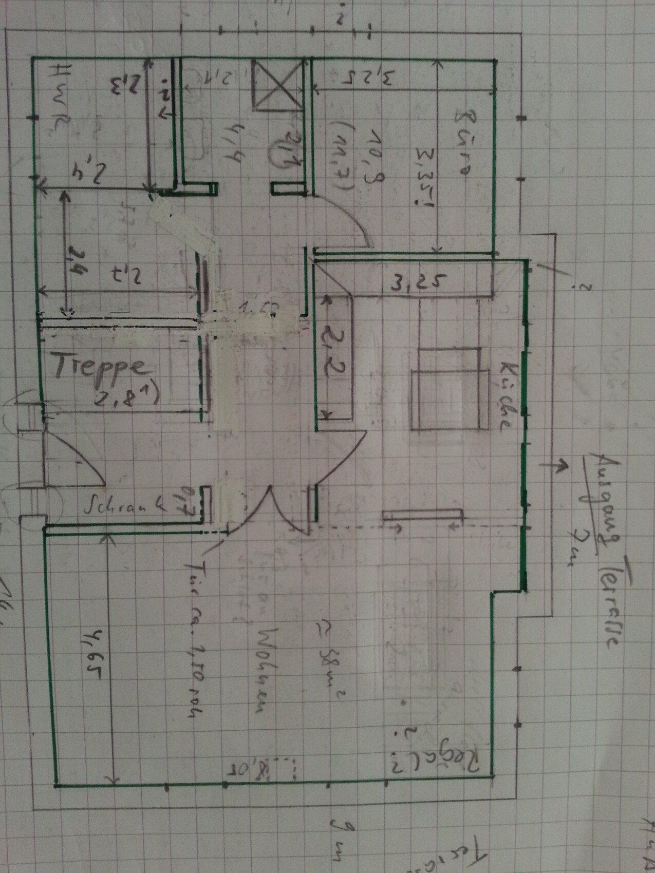

I have attached the floor plan with the kitchen island variants. It’s a bit rough with pencil marks but the result of extended considerations.

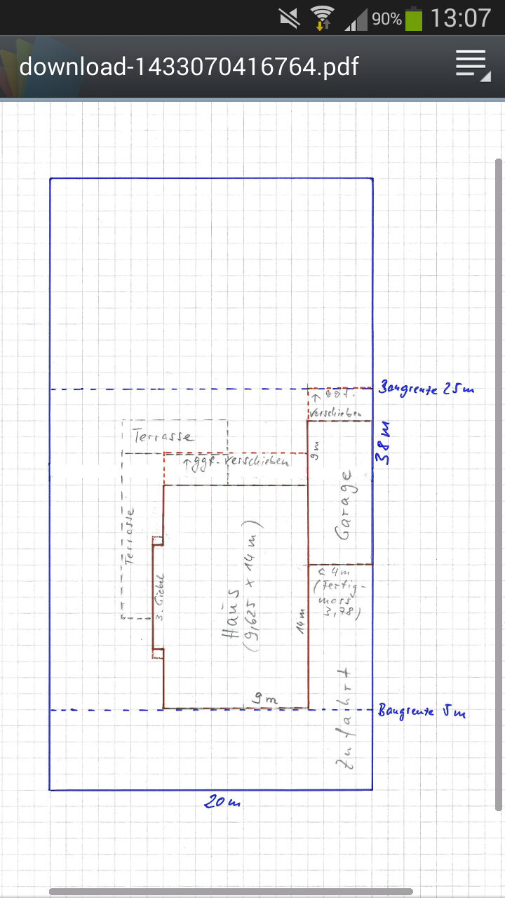

Attached is a photo of the building. The north line runs from the bottom left to the top right (DIN A4 sheet), so slightly diagonal.
It would often be much easier if the drawings included the north arrow right away... instead of it being described somewhere in the text that you always have to search for.
Otherwise, in your plan, the kitchen actually has about 200 cm (80 inches) of the 325 cm (128 inches) width as clear traffic space, because it’s difficult to arrange furniture there.
About one meter (39 inches) above and below the imagined partition wall. That amounts to 6 square meters (65 square feet).
With a width of 325 cm (128 inches), the island can only be a maximum of, counted from the left: 60 cm (24 inches) countertop, 90 cm (35 inches) walkway, 95 cm (37 inches) island, 80 cm (31 inches) walkway... it's possible, but measured from the shell construction. And next to it, there is the 6 square meters (65 square feet) of free space.

@kbt09 has already nicely pointed out that you are wasting some space with your wall section.
You could initially leave this wall section out of the planning and later consider where it could be placed.
Two harmonious double windows would give you direct access from the kitchen to the terrace, with the counter running along the dividing wall. It’s actually so that you don’t always work straight at the counter but move from right to left or vice versa (e.g., chopping and then putting the food into the pot next to you). So, you don’t look directly out of a window but your view shifts about 60 degrees left or right.
For me, it was also a priority to have a view into the garden, but I rarely had a design where the counter was wastefully positioned directly in front of a window. Everything within an angle up to 90 degrees and about 4 meters (13 feet) is doable without compromising quality when cooking and enjoying. Then draw a visual axis to see where the view from the counter through a window wanders, and let a scene grow in the garden there.
Apart from that, I would probably try flipping the hallway and stairs so that the corridor door moves further upward on the plan...
*the same applies to the living-dining area
