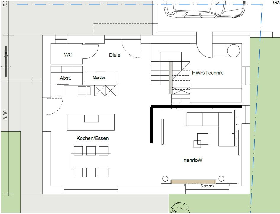

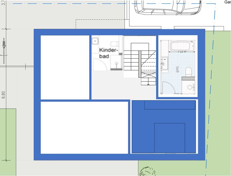

12 Nov 2022 10:00
I once installed the landing stairs asymmetrically. Access to the utility room is located under the stairs (the height should just be enough, right?).
We would definitely prefer the upper floor this way.
The downside is that a proper separation between the living area and the hallway wouldn’t be fully possible here, although it is very close.

K a t j a12 Nov 2022 10:16
Varrader schrieb:
(should just barely fit in terms of height?!).
The nice thing about stairs is that you can calculate everything quite precisely once you know the key measurements. So, what is the floor-to-floor height, the rise and tread depth of the stairs, and the height of your doors? Plus the exact dimensions of the hallway, and you’ll know where adjustments need to be made.
