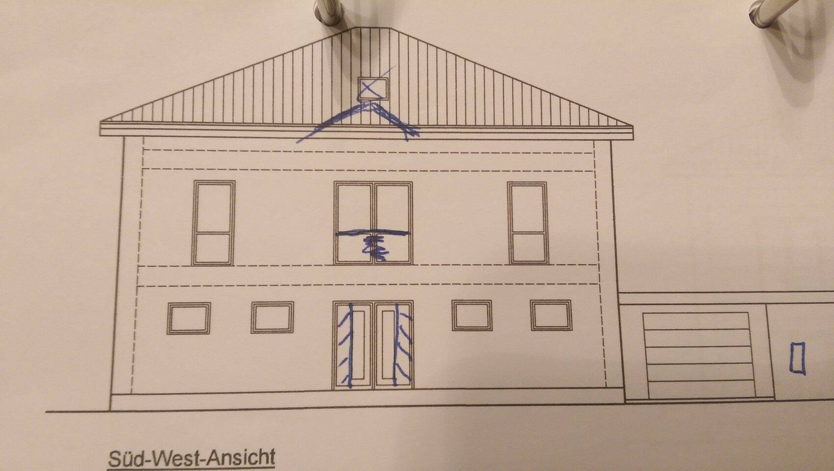

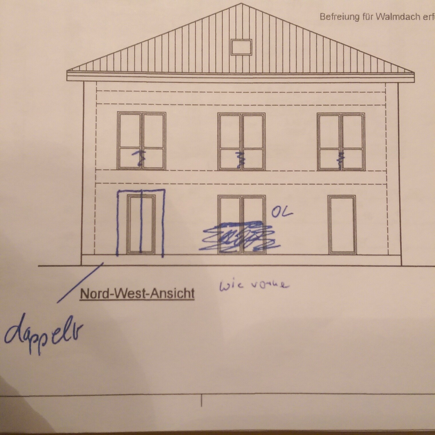

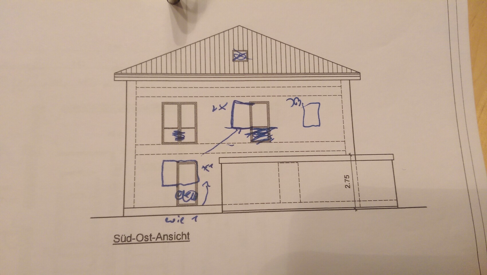

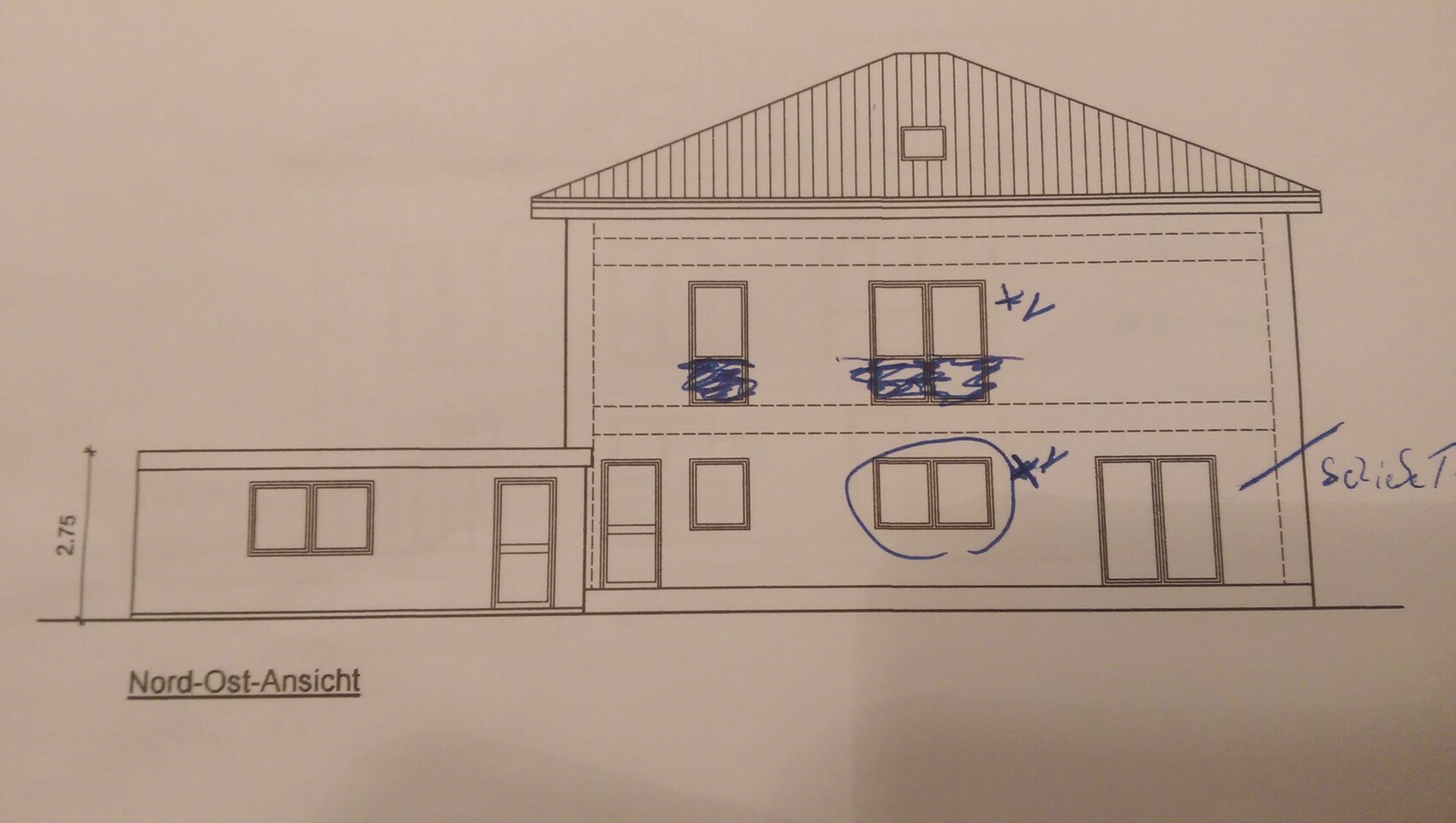

I have attached a picture of the window changes that have been made. They still need to be drawn.
The cloakroom is primarily intended for guests and a few of our belongings since we will often enter through the garage because of the car or the children's bikes after school.
The wall between the dining and living rooms is meant to provide some spatial separation without fully closing off the area and to allow for the placement of the TV. The fireplace is also our tricky spot, so it will probably be on the back side of the TV partition wall to have space to pass on both the left and right sides.

I don’t like the exterior views with the window arrangements, for example, the one in the dressing room.
