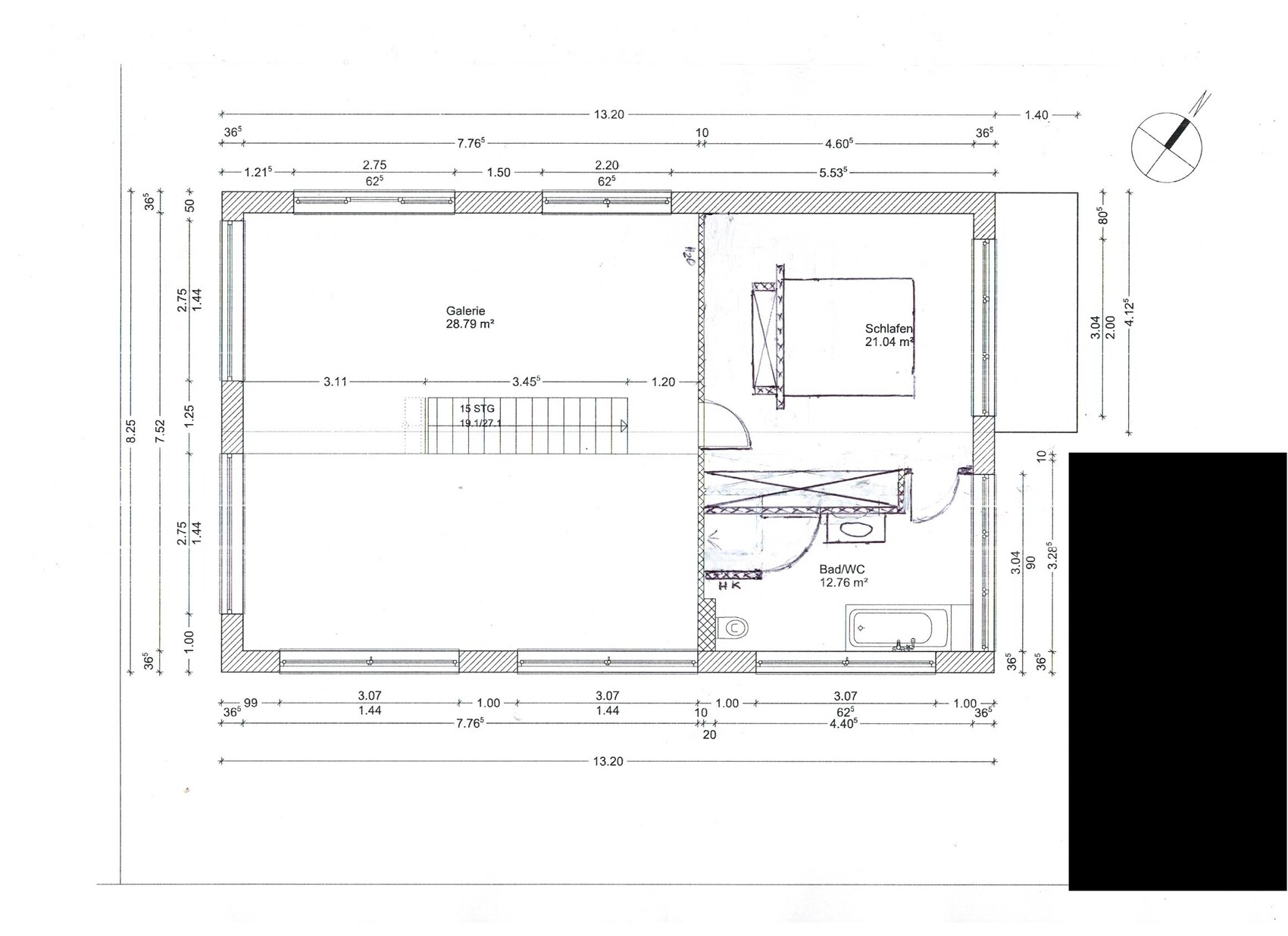

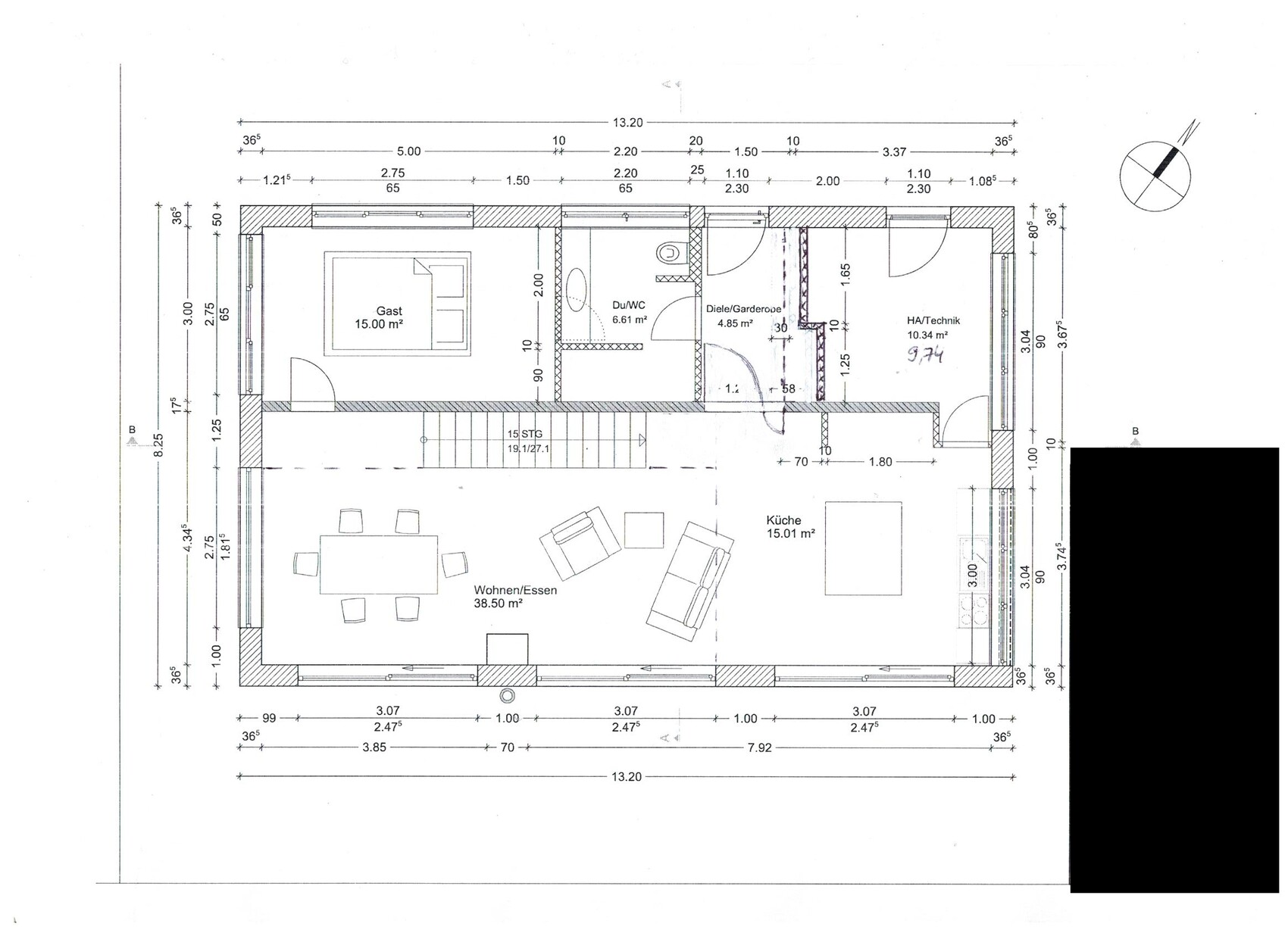

Nida35a6 Jul 2020 10:14
@pagoni2020
Your floor plan keeps bothering me.
We also have bedrooms with built-in wardrobes on the ground floor, it works well.
Place the door next to the stairs, not partially underneath, to avoid head bumps.
Upstairs, where the narrow bathroom is, create a gallery corridor leading to the guest room; in front, on the outside, have the bathroom with a separate door, possibly with a dormer for standing height.
I’m not satisfied with the image of the long wall at the edge of the gallery.
The top window in the house, designed to tilt with a motor (for us, the triangular windows), is invaluable in summer—cool air comes in from the park at night below, and warm air escapes at the top.
kbt09
12 Jul 2020 22:22
Just reading this now... I generally like the redesign very much... but I still have to criticize the refrigerator placement.
If I’m seeing it correctly, there are now almost three living areas? Downstairs... very spacious, upstairs, and a TV corner upstairs?
The guest area has become very tight, especially since a bunk bed is planned there and the bathroom is very narrow. I think this needs to be reconsidered.

Ground Floor:
- Staircase to the upper floor rotated, so no more passing by the gallery area, making it quieter there
- Living room moved upstairs, which has freed up quite some space; the living room is used less frequently anyway
- TV area now in the guest/elderly/whatever room (second TV/projector in the upstairs living room?)
- Guest room extended by 1m (3 feet), now 15sqm (160 sq ft); staircase and main entrance shifted accordingly
- Utility/technical room sized according to technical requirements, possibly divided (pantry/utility)
- Small living area or lounge corner with a reclining chair by the fireplace / furnishing, but laid out differently
- Dining room located where the living room used to be (can be furnished the other way around depending on mood)
- Glass surfaces modified, two wall panels for the fireplace/wood storage, and either open or made of sand-lime bricks
- Bathroom adjusted to comfortable dimensions for us (size of shower etc.)
- Glass roof on the terrace in front of the kitchen area
Upper Floor:
- Wall between bedroom and bathroom shifted further towards the bathroom
- Current living room furniture fits perfectly in front of the now large window
- Half-height room dividers planned in front of the emerging office corner
- Bedroom furnishings will be different, bed placed in the center, away from the wall
- Shower remains as is or possibly 1m x 1m (3 ft x 3 ft) or slightly larger, but then with a door

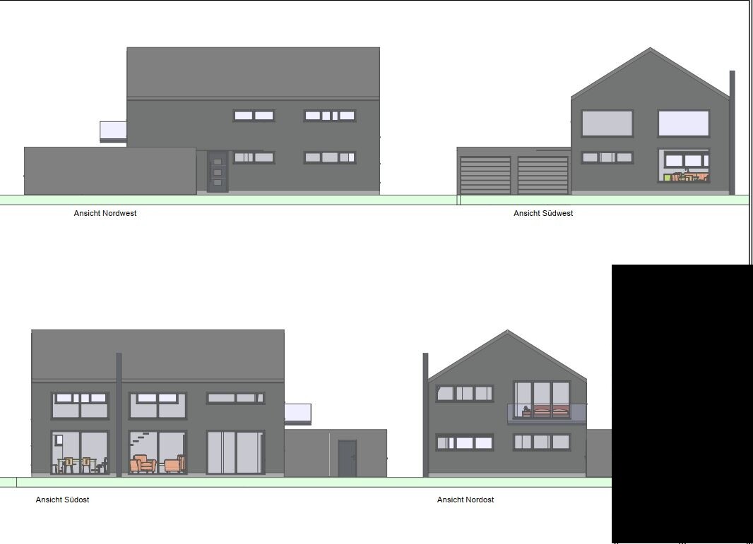

Windows throughout the house have been adjusted/changed, with blinds (raffstore) on the south and west sides

I just noticed that I uploaded a different image for the upper floor. The bedroom layout is currently planned as shown in the image, but the bathroom design is not final yet. It may be walk-in without a door (my preference) or similar to the image, but then with a glass door.
