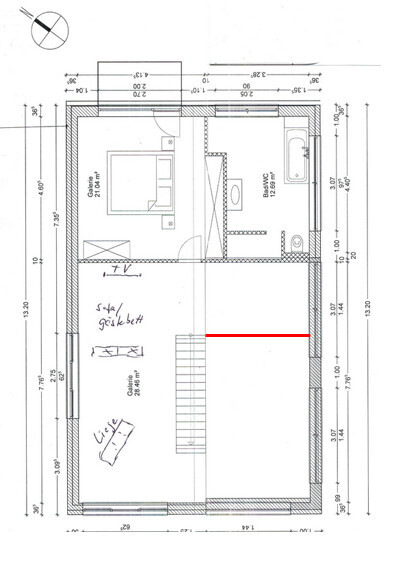

pagoni20203 Jul 2020 14:04tomtom79 schrieb:
Very nice from the outside.
At first glance, the interior shows a very long living room that is simply too narrow.If I had been allowed to decide........we wanted to end up with about 150sqm (1600 sq ft) and cut back in some areas......bigger would have been nicer, but unfortunately that applies to other areas as well. Then I’m back to my 200sqm (2150 sq ft), which I don’t want anymore.Hmm.....
Alessandro3 Jul 2020 14:28I don’t quite understand the upper floor...
Does the staircase lead to a large open space? Is the bed placed in the middle of the bedroom without a headboard?
Where is the access to the bathroom?

pagoni20203 Jul 2020 14:42Oops... sorry.
Something has not been fully added or only partially described.
The area above the dining and living room is an open space; you go to the right after the stairs.
There, we divide the space with our mobile USM-Haller furniture into a lounge area and TV area, including the corresponding TV sofa that also serves as a guest bed. It’s a nice piece from RUF with a foldable aluminum table, which will be used both as a TV table and as a guest bed (for grandchildren, etc.).
Access to the bathroom is done with HILTI. No, that’s missing as well. The entrance is from the bedroom at the back near the window.
Bathroom planning is changing daily...
There is nothing drawn behind the bed yet, but a Ytong wall or suitable furniture will be placed there. Basically, we have recreated that from here. The furniture is included.
Sorry again, we have it all in mind, but not everything has made it onto the plan yet until we know for sure how it will be.

Alessandro3 Jul 2020 14:54All clear.
I like it and can definitely imagine it for 2 people.

pagoni20203 Jul 2020 14:58Well, that reassures me......Seriously, I can see that you have good taste, and despite my advanced age combined with stubbornness, I’m always happy to listen to other opinions. We are still at the planning stage and can make changes. So.....bring it on if you notice anything or come up with any ideas.
Alessandro3 Jul 2020 15:11The only thing that would bother me is that there is no space for a TV in the living room.
I would also reduce the size of the gallery to create a cozier appearance.
Then you would have a small hallway upstairs for a chest of drawers, a workspace, or you could even rearrange the bedroom and bathroom.
