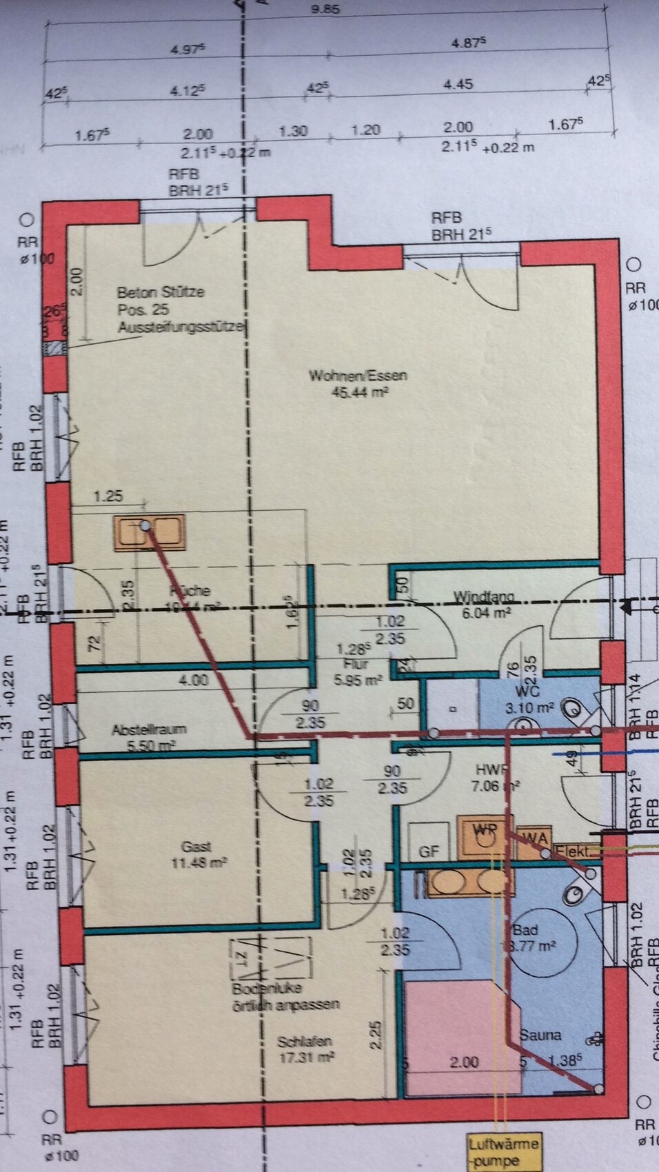

So – now I’m presenting our “House Project for Two” expecting your honest and maybe harsh feedback. Don’t hold back, as I can only benefit from it.
The building permit / planning permission application is currently being submitted, and preliminary information suggests it should be approved. We deliberately avoided too many deviations from the very old development plan.
We like a modern, minimalist architectural style. The floor plan is a mix of our own living habits, our existing furniture including the kitchen, and the budget, since at this stage of life we don’t want to take on risky debt.
Our current condominium is very stylish and was just recently customized by ourselves, but life changes; besides, we want to be able to have a small fire in our own garden again.
We are now building with a general contractor (GC) who has a good reputation and has already allowed us to change many things without stress – so far. Ideally, we would have built with an independent architect or our friend who is an interior architect, which would have given us more freedom in choosing trades, but this time we want to focus more on details and avoid the running around that happened the first time, 30 years ago. No, this time I won’t be digging foundations or pouring the basement myself until my family doesn’t recognize me anymore.
Whether it will be a garage, carport, or parking space depends on the costs, as does the attached balcony, which would then be a so-called standing balcony; initially, it just needs to be approved. There will also be a larger garden house with an outdoor sauna.
The plot is quite large and has a nice view of greenery. Unfortunately, only to the north, about 500 m (1600 ft) away and at a lower level, there is a beautiful lake. For this reason alone, we decided not to build a bungalow, since having a lake view and not using it was out of the question (hence the “emergency balcony” at the bedroom). Originally, a house with a bend was planned, but it always looked ugly in the end.
HOUSE FOR TWO
Plot size: 1400 sqm (15,000 sq ft)
Slope: No
Number of floors: 1.5
Roof type: Gable roof
Architectural style: modern-minimalist
Client requirements
Style, roof type, building type: clean lines
Basement, floors: no basement
Number of occupants, age: 2 (one of them still works a bit more…)
Guest stays per year: quite often, alternating
Conservative or modern construction: modern, open plan
Number of dining seats: 4
Fireplace: yes/no/undecided, possibly also gas fireplace
Balcony, roof terrace: possibly a balcony at the bedroom for lake view
Garage, carport: yes, depending on price
Additional wishes, etc.:
Separate guest area, possibly as a bedroom in old age, then guests upstairs
Custom furniture and kitchen integrated
Separate TV area from the gallery, next to it a separate relaxation area with recliner
Kitchen with 120 cm (47 inch) side-by-side refrigerator or 70 cm (28 inch) refrigerator by the window side
Monolithic Rock XL1 wood stove available, chimney planned outside for lower costs, appearance, and less space inside
Ground floor window areas separated by masonry walls due to chimney, possibly refrigerator placement but especially due to manufacturer’s limited width (according to GC)
Original idea was continuous window surfaces up to the eaves in living/dining area, now separated at ceiling height by masonry strip
Some parts in the plan/floor plan not labeled correctly yet (GC design implementation)
House design, who designed it: by the clients + partial coordination with interior architect, currently executed by a builder’s planner
What do you like most and why?
Simple architectural style, gallery, spacious window surfaces, external blinds, open layout
What don’t you like and why? I’m sure I’ll read about it here
Estimated price according to architect/planner: -
Features: The goal is to invest selectively and sensibly but consistently omit unnecessary, cost-driving frills (in my opinion)
Preferred heating system: undecided, unfortunately no gas connection available
If you had to skip something, which details or extensions could you do without? Maybe the fireplace… I’m still unsure about the location, I would like a built-in gas fireplace under the stairs, but only for that would we get a liquefied gas tank?
Why is the design the way it is? For example:
Own life circumstances, existing furniture, individual living habits
I welcome direct and constructive assessments. The building shape and location of carport/garage are fixed. The focus of questions is on layout details and usage/design options.
There will be a glass roof or slatted shading in front of the kitchen area.
The plot is almost flat, and the outdoor area will be simple and user-friendly, with a larger garden house including outdoor sauna, storage for gadgets, tools, etc.

In a senior living residence, you don’t need to buy in. Many people remain active until a very old age, while others face challenges at a younger age. This has affected our circle of friends significantly.
@hampshire made a good point. You have a lot of flexibility. A family of four or five can’t have that on the same space. Well-designed rooms, a cable here, some reinforcement there, and you’re prepared.
A lot of this initially costs nothing but some careful planning.
A basic optimum layout for the guest area (excluding my current suggestion with the bedroom switch):
The room’s width is not sufficient for a wardrobe at the foot of the bed. Placing the bed under a window is also questionable.
Rotate the bed 180 degrees so the headboard is against the interior wall. Install a built-in wardrobe on the wall between the guest room and the bathroom. Move the bathroom door closer to the window side. Then swap the shower and the washbasin positions. This way, the washbasin will be on the window side, and the shower will have its entrance on the logical front side without obstructing the toilet.
pagoni20204 Jul 2020 10:25@kbt09 Sorry for the late reply, but I wanted to take a closer look. Swapping the living room on the ground floor with the bedroom upstairs is really interesting; for us, the TV is usually moved away from the living room. Not too keen on an open space above the kitchen. Guest room and bathroom upstairs have been mentioned several times already; good idea.
Changing the stair orientation has already been considered; so far it works better when switching the living room, but the other way around—yes.
The idea of having the bedroom on the ground floor is already under consideration.
Access from the garage to the utility room is not necessarily required. Possibly there will be access to the utility room from the hallway anyway, so an extra door from the utility room might be unnecessary.
The fridge might seem out of place, but for some reason we like or have something similar. I always had a large side-by-side refrigerator standing alone in the dining room and I’ve always liked it that way. We’ll see…
Sleeping together on the ground floor for guests?? Oh… that’s a different idea.
My two brain cells are moving… Many thanks for your effort and ideas.
Yes, a side-by-side refrigerator can stand on its own, but it should also be connected to the sink/cooking/preparation area.
The living room across the entire top width could easily be divided into two zones... more like a TV area and a relaxation area.
Why not place the gallery above the cooking/dining area? It could also be separated with glass panels at the top.
