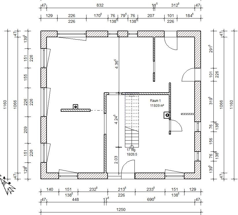

Hello dear forum community,
we are planning to build for the second time. The first time, five years ago, we built 175 sqm (1885 sq ft). Now we are moving and want to start the adventure again.
We have already looked at several options and have decided on this design. We are a family of six. Now we would like to hear what others think, because after about the tenth change, you don’t see everything so clearly anymore. The windows in this design are also not yet exactly how we want them and are currently being adjusted by the draftsman, but overall, it fits quite well.
It will be a KfW 55 standard house, equipped with an air-to-water heat pump (geothermal energy is not possible due to the water protection zone, and there is no gas supply in the building area), as well as photovoltaics with a storage system, a central ventilation system, and possibly a hydronic fireplace (wood or pellets).
We are curious and wish you all a happy Easter.

Hello Yvonne,
Do you mean all views in general or a specific one? What exactly should be changed there?
Hello kbt09,
Yes, I meant the door in the utility room—hand washing, grilling items, anything that shouldn’t go into the kitchen.
A fold-down ironing board on the wall.
What can I say about the staircase—it turned out that way, so to speak, in the drawings. The staircase in the attic remains unchanged.
Living room, hmm, considering placing the sofa along the interior wall and the TV between two large windows, even though that doesn’t align with the upper floor because of the middle window and the wall. At the front then two skylights matching the right side, so bathroom and home office...?...?..

MKoni schrieb:
Hello Yvonne,
Are you referring to all views in general or a specific one? What exactly should be changed?I really don’t like the so-called “light strips” — they are too short to be called that and also protrude beyond the intended vertical lines. They create visual disturbance.
On the kitchen side, the middle window on the exterior view bothers me.
What I just noticed is that I don’t like the room orientations: guest/office room to the south, front door to the west (SW)… I would rotate the entire house so the entrance faces the garages or mirror the entire building section.

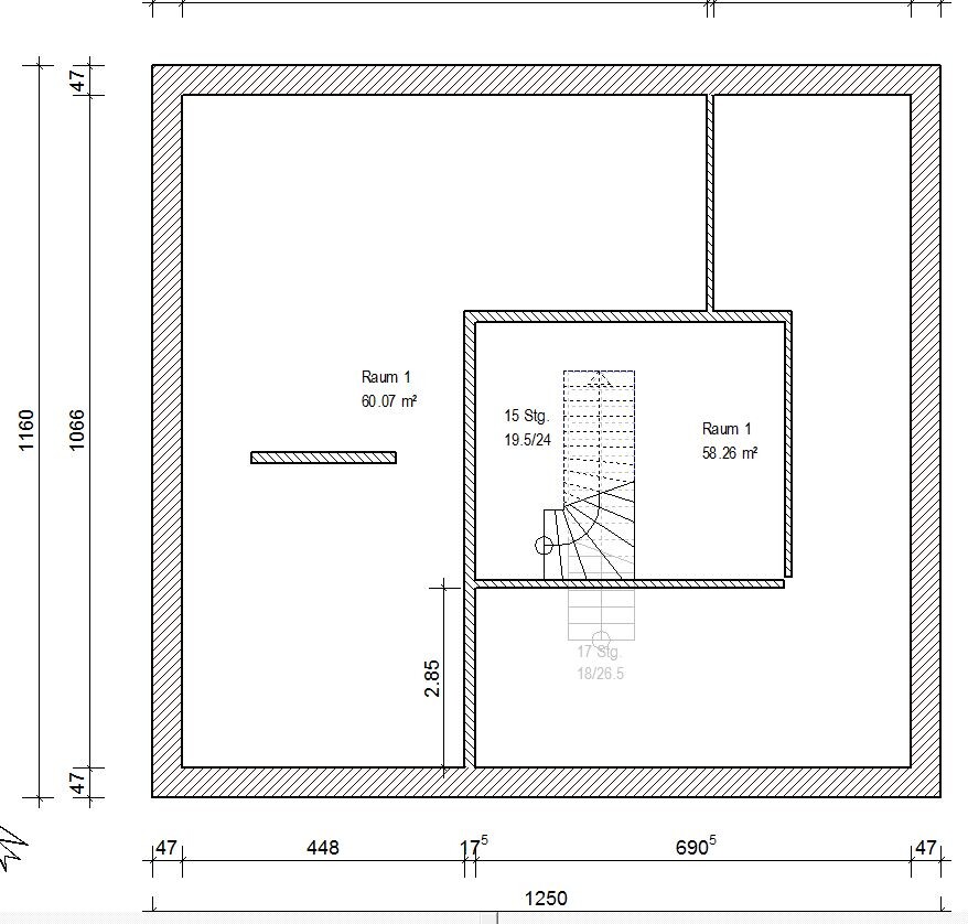

@MKoni, something doesn’t seem right here.
If you take the ground floor plan, the distance from the start of the stairs to the exterior wall with the entrance door is 201 cm (79 inches). On the upper floor, the distance from the stair wall to the exterior wall is 285 cm (112 inches) plus the 11.5 cm (4.5 inches) wall thickness. Sure, there can be some overlap, but around 95 cm (37 inches)?
I’ve sketched this with the key measurements and attached the relevant section, because the staircase is not shown in the upper floor drawing you posted.

So, this cross-section looks quite clear already. If you agree, I would like to share this excerpt with the draftsman and see what they think.
