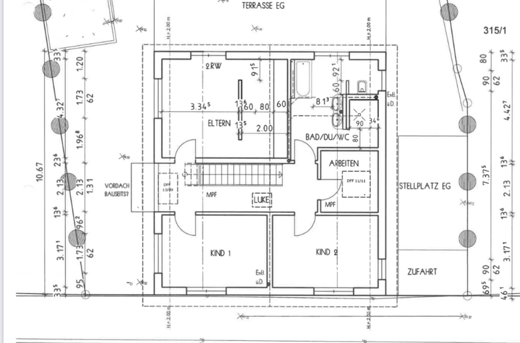

At the moment, we have planned a straight staircase. The ceiling height is 2.65 meters (8 ft 8 in). Please also see the house sketch.
The hallway upstairs and downstairs is the same width. I am wondering if it would be possible to create an L-shaped staircase that would allow access to the bedroom through the walk-in closet, as marked in red. Without having to change the width of the hallway? The L-shaped staircase could, of course, be positioned further forward, and hopefully, when I reach the top, there would be enough space for the door to the walk-in closet/bedroom. Would this be possible?
Thanks in advance
Technische Zeichnung eines kleinen Holzhauses mit Dachstuhl, Maßlinien und Grundrissanzeige.
Grundrissplan: Elternzimmer, Bad/DU/WC, Arbeitsbereich, Treppe, Luke, Stellplatz.
11ant30 Jun 2023 00:08
s_mhofma schrieb:
I’m wondering if it’s possible to create access to the bedroom through the dressing room using an L-shaped staircase, as marked in red. Without having to change the width of the hallway? The L-shaped staircase could then be moved further forward, and hopefully, when I reach the top, there would be enough space directly for the door into the dressing room/bedroom. Would that be possible?
[First of all, for clarification, here is the original house planning thread: https://www.hausbau-forum.de/threads/grundriss-175qm-satteldach-ohne-keller.45056/] What is the motivation behind this major redesign?
Keep in mind that such a change more or less represents a complete transformation of the floor plan. The shape of the staircase is more than just a cosmetic change in a house design.
kbt09
30 Jun 2023 06:36
The hallway is too narrow... and when redesigning the staircase, the layout of both floors always needs to be considered. By the way, the ceiling height to be overcome is 308 cm (10 feet 1 inch).
Looking at the floor plan... what exactly is that narrow shaft in the bathroom?

s_mhofma
30 Jun 2023 13:56
This definitely has something to do with laundry: laundry column or shaft. Crazy! Who would want to squeeze into such a dark space? I would always plan something wider than a shower, because you have to turn around holding something, so it’s an activity that may require bending.
There’s also a window by the shower… unbelievable.
This is not the finished bathroom. The layout in the bathroom is not yet finalized. Of course, there will not be that “narrow corridor.” But my question was not about the bathroom either.
As described above, the idea was to move the door to the bedroom. At the moment, you have to walk all the way around the staircase to get to the bedroom.
And I’m aware that a staircase changes a lot. That’s why I asked if it would be possible at all with the current hallway. That way, the changes would be minimal.
So that no one has to worry about the narrow space or the window in the shower anymore, here is the current bathroom plan:
House floor plan: master and two children’s bedrooms, bathroom, staircase, terrace.
mayglow30 Jun 2023 16:49
Where exactly is the L-shaped staircase supposed to bend? I don’t quite understand. Or do you mean the bend is in the lower section and you actually want to step out straight on the upper floor? If so, isn’t the ground floor plan missing somehow?
