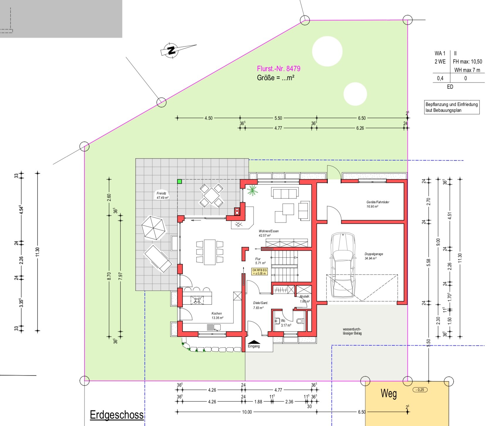

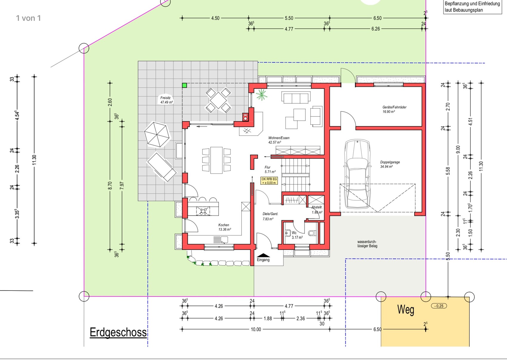

ᐅ Single-family home, approximately 160 m², Bauhaus style; first design draft based on our requirements
Created on: 23 Aug 2019 22:03
Notstrom
we've been looking forward to this for a long time, and now we can finally share our first draft floor plan/design for discussion. We’re very curious to hear your feedback.
Those of you who have seen my thread before (https://www.hausbau-forum.de/threads/efh-Bauhausstil-Wohnfläche-180m-mit-Doppelgarage.31853/) know what to expect, and here comes the gem.
Plot size: 530m² (about 5,700 sq ft)
Slope: No
Site coverage ratio (Grundflächenzahl): see screenshot
Floor area ratio (Geschossflächenzahl): see screenshot
Building envelope, building line, and boundaries: see screenshot
Edge development: see screenshot
Number of parking spaces: double garage
Number of floors: 2
Roof style: flat roof
Architectural style: Bauhaus
Orientation
Maximum height/limitations
Other requirements
The green highlighted area represents our plot => Parcel 8479
Homeowner Requirements
Style, roof type, building type: Bauhaus style, flat roof
Basement, floors: Basement yes, ground floor, upper floor
Number of residents, ages: 3 people, potentially 4: 33, 30, 2 years old
Space requirements on ground and upper floors: Initially planned 180 m² (about 1,940 sq ft) on two stories, now reduced to 160 m² (about 1,720 sq ft) after feedback, with the ground floor slightly larger than the upper floor, around 75–85 m² (810–915 sq ft)
Office: Family use or home office? Yes, in the basement (guest room <-> office)
Overnight guests per year: Hard to say, probably about 10 times per year with 2–5 guests each time
Open or closed architecture: Rather open
Conservative or modern construction: Rather modern
Open kitchen, cooking island: Island
Number of dining spaces: 1
Fireplace: Yes
Music/sound system wall: Our soundbar is sufficient
Balcony, roof terrace: Maybe, undecided (Architect’s comment: How often do you really go out for a beer on the balcony/roof terrace instead of the nice terrace on the ground floor?)
Garage, carport: Double garage, possibly single garage with carport
Kitchen garden, greenhouse: Small but nice (a few tomatoes, cucumbers, zucchinis…)
Planning by: Architect
What do you particularly like? Why? We like the architecture with the two offset rectangles, though we wonder if the extra cost (no price estimate yet) justifies this. We believe it is structurally more challenging than a simple "cube."
What don’t you like? Why? The size of the bedroom/walk-in closet/children’s room. It feels like the bedroom is missing 2–5 m² (about 20–55 sq ft), as is the second children’s room.
Price estimate according to architect/planner: The initial draft was around 550,000 EUR
Personal price limit for the house, including fixtures: 620,000 EUR
Preferred heating technology: Indifferent, but tendency toward heat pump.
If you had to give up something, which details/finishes
- You can give up: the current shape (nice but a cube would also do)
- You cannot give up: space
Why is the design the way it is now? For example:
Standard design from the planner? This is the second design resulting from last week’s discussion with us, and we find it very successful.
Which wishes were implemented by the architect? Absolutely, plus the idea he had to move the kitchen during development. The guest room has now moved to the basement, allowing more space on the ground floor (beforehand, it felt quite cramped and “squeezed”).
What makes it especially good or bad in your opinion? The architecture
...and now I’ll leave you alone with our house
Upper floor plan:

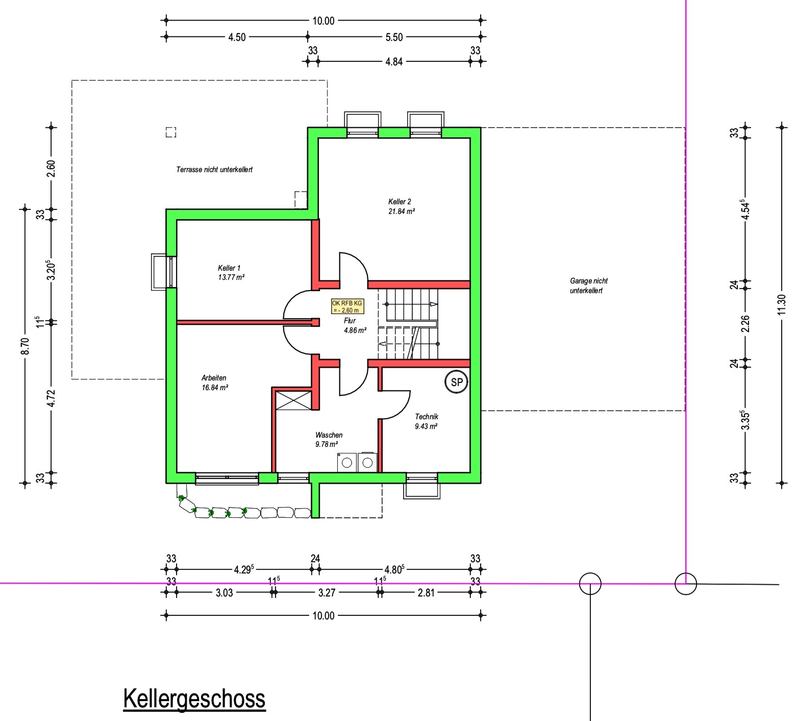

Basement:

Notstrom schrieb:
c) that the floor plans here were so much better than those of the architect.They really weren’t. They were just different (equally rough draft designs) and also needed adjustments. Of course, after all the negative feedback about the architect’s design, these seem better – but one should not forget: we laypeople judge without background knowledge about setbacks, structural integrity, and so on. The professional still has many other considerations in mind that the design must meet.
Without wanting to step on anyone’s toes (I hope @kaho674 and @ivenh0 understand what I mean here),
in post #37 the kitchen would be positioned in a way that wouldn’t be practical to work in; in #104 the kitchen is closed off (the architect simulated having both open and closed options); in #117 the living room would be far too dark and somewhere your design included a staircase with a landing, which wouldn’t fit in @ivenh0’s layout either.
I thought #46 (your absolute favorite a few days ago) was a very good starting point: open the kitchen, adjust the staircase and windows as well as the bathroom fittings (as mentioned), fine-tune some measurements here and there, give it a few weeks to settle. @11ant thought the bedroom/walk-in closet was really bad, but with some conceptual changes (which I haven’t mentioned here) I find it a great solution… finally something different and a cozy pleasure for the lady, as there’s definitely room to create a makeup nook, etc. And what do you do? You terminate the architect.
Notstrom schrieb:
More change requests from us are:
- The fireplace on the ground floor will be moved next to the dining/living area so we can have a passage from the hallway to the living room (the wall will be adjusted accordingly…)
- The wall in the kitchen will be removed to realize an island kitchen
- The wrap-around terrace will be extended to the window front of the living room to create an exit there (sliding door!)
- South of the dining table we want to replace the sliding door with a glass panel (possibly including a balcony door)
- Possibly replace the spiral staircase with a staircase with a landing. Architect’s note: That requires space
- Possibly tweak the floor area (currently about 148m² (1600 sq ft))
- Enlarge the window on the stairwell on the upper floor
Open points:
- Bathroom size. Finding space for a closet or similar is difficult because of the two entrances to the bathroom; might need to reconsider
- Simulation of a hipped roof on the existing house
- Possibly adjust some windows again in certain places (e.g. stairwell, see north elevation; floor-to-ceiling in children’s room likewise on north elevation; light strip in kitchen, see south elevation)

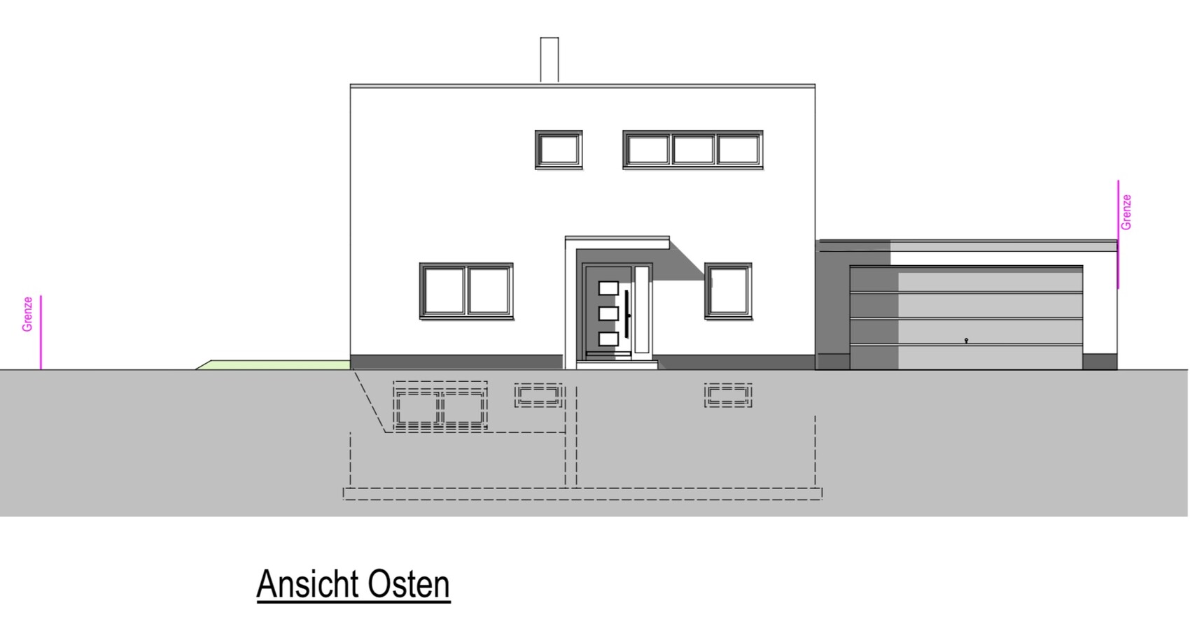

- We find the front of the house (east elevation) a bit dull, but we will get to that later; for now, the floor plan has absolute priority These requested changes are purely fine-tuning...
I would say: go to a general contractor if you want a customized Rensch house. Or give a freelance architect free rein and time to develop something.
Or take "#46, Rensch house, ivenh0, Katja floor plan" and have that refined.

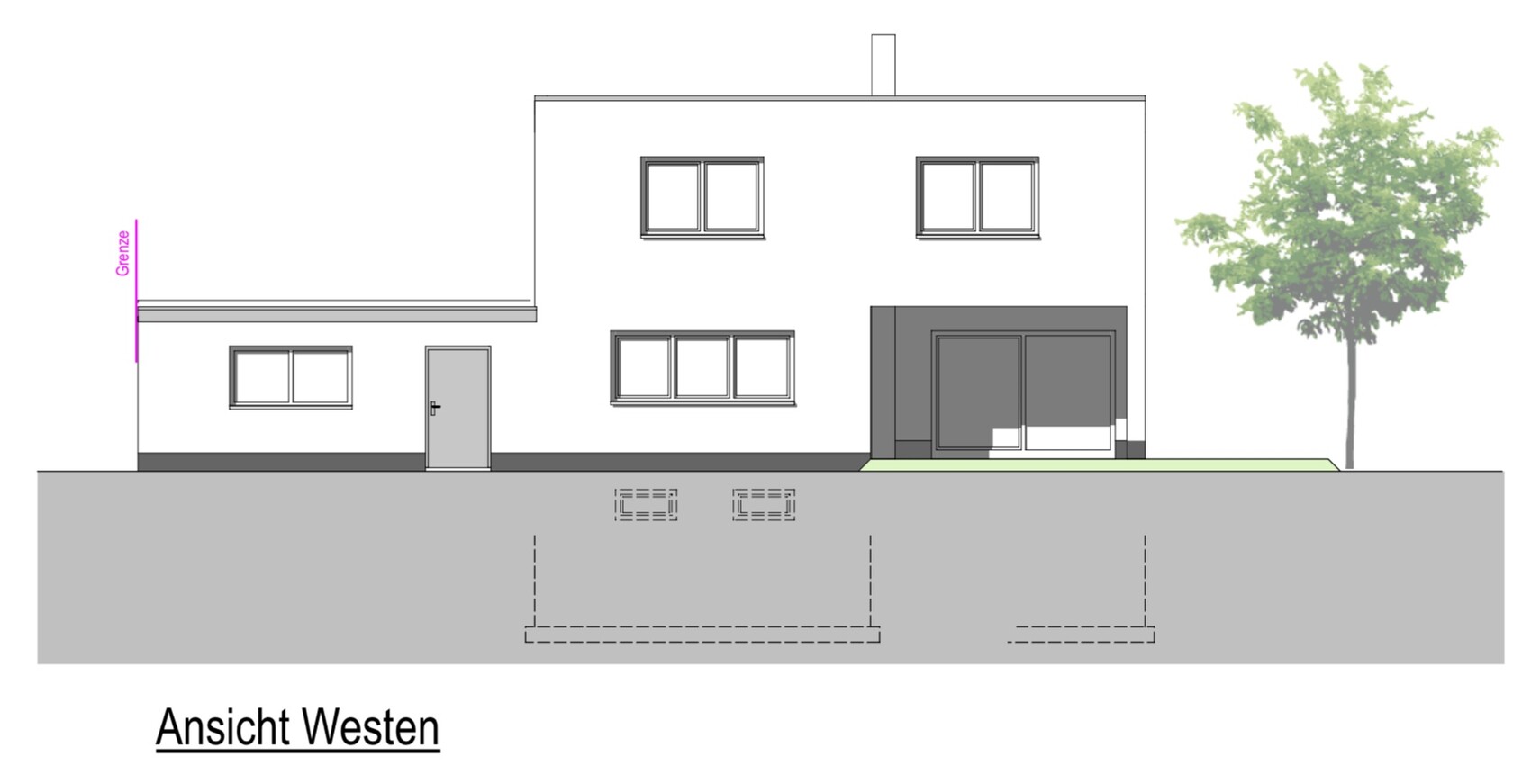

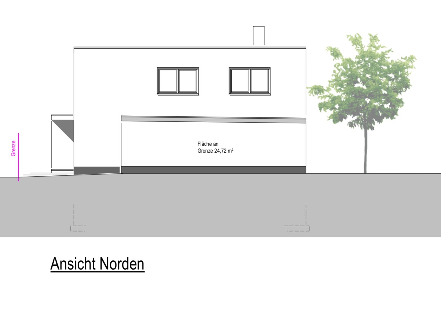

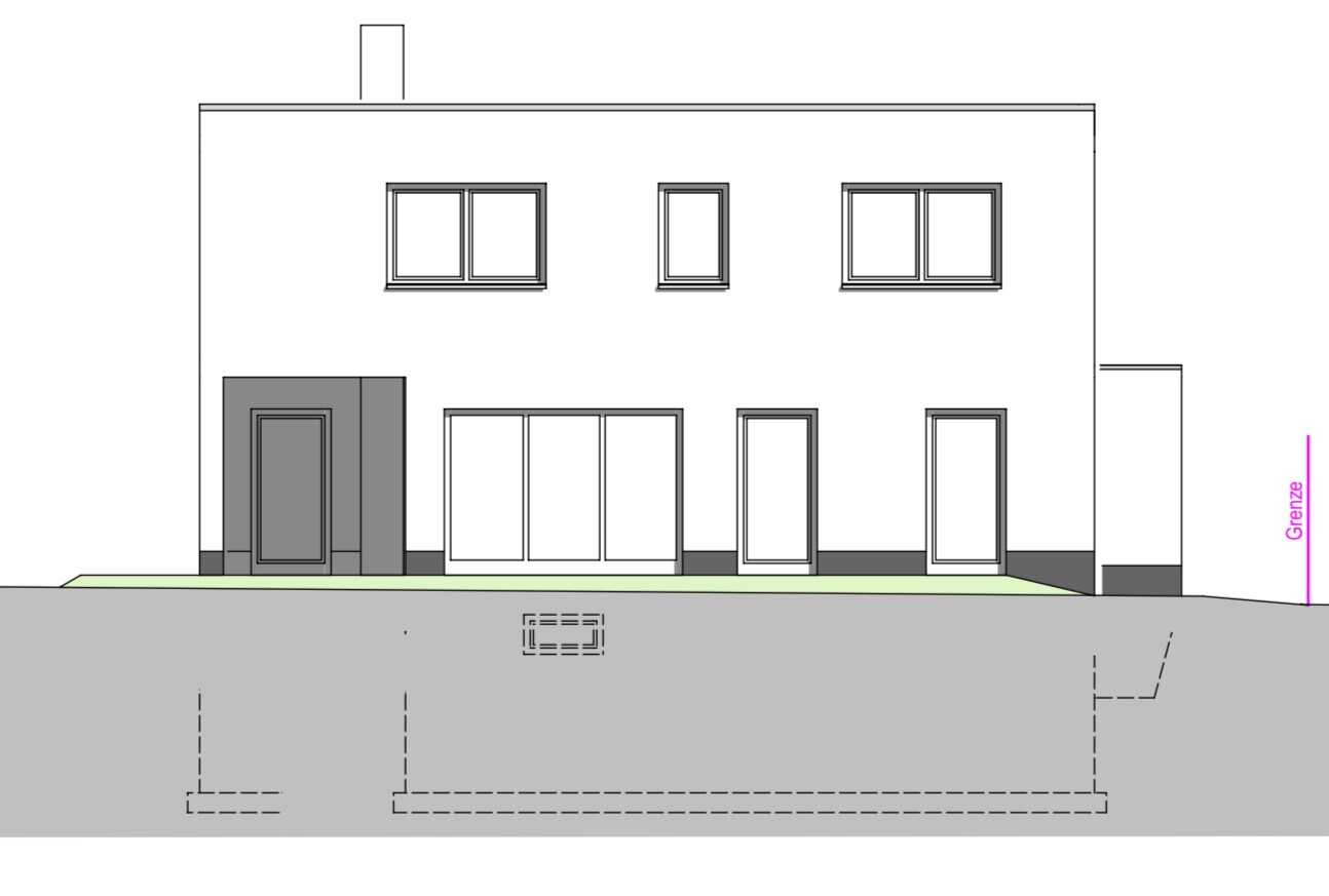

Dear forum members,
Disclaimer: Please only post constructive and relevant comments. No further pro-architect or pro-technical discussion. We are currently expanding this project significantly, learning from it, gaining experience, and simply want to create something nice.
Attached is our latest draft for our house-building project. If anyone notices similarities to the previous version: that’s intentional. Why? The south/west sides automatically determine the terrace location; the garage therefore has to be positioned on the north side to fully utilize the terrace and garden area (boundary construction).
We still have a few ideas but look forward to your feedback. Below are our change requests / ideas / notes which we will also discuss again with the architect:
- Guest toilet missing a shower
- Remove door between hallway and wardrobe
- Window front in living/dining area to have one instead of three sections
- Width of the wardrobe? Is it really “usable” like this?
- Check width of passage between living and dining area -> stove! It seems a bit narrow to us...
- Is the wall of the dining room (not the corner piece, but the extension from the hallway to the corridor) into the corridor necessary?
- Freestanding kitchen island?
- Kitchen: create space for built-in cabinets
- Kitchen: optimize window (either move the sink or the window...)
- Plan a window element in the stairwell -> so far only one window, would like it elongated downward
