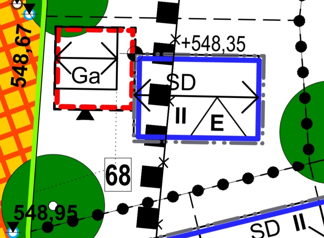

Building window, building lines and boundaries: 3 meters (10 feet) from the boundary

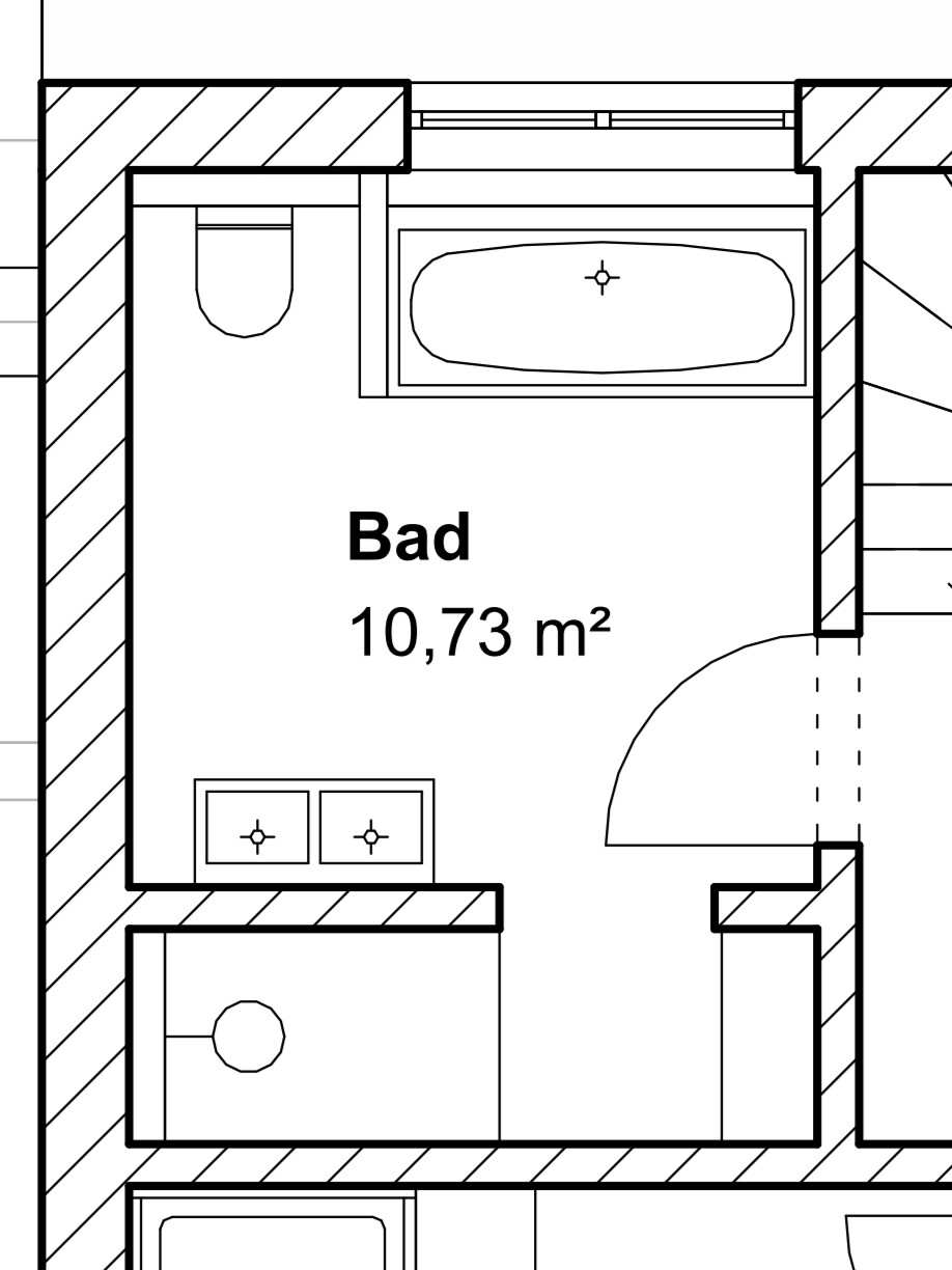

The living-dining area may be a bit tight. We are considering rearranging the TV and sofa to create a more open living feel. The bathroom layout on the upper floor could be improved. We have tried several variants but have not decided yet.

How can the floor plan still be optimized? Windows and doors can be adjusted. Exterior dimensions are fixed. Which bathroom layout makes the most sense?

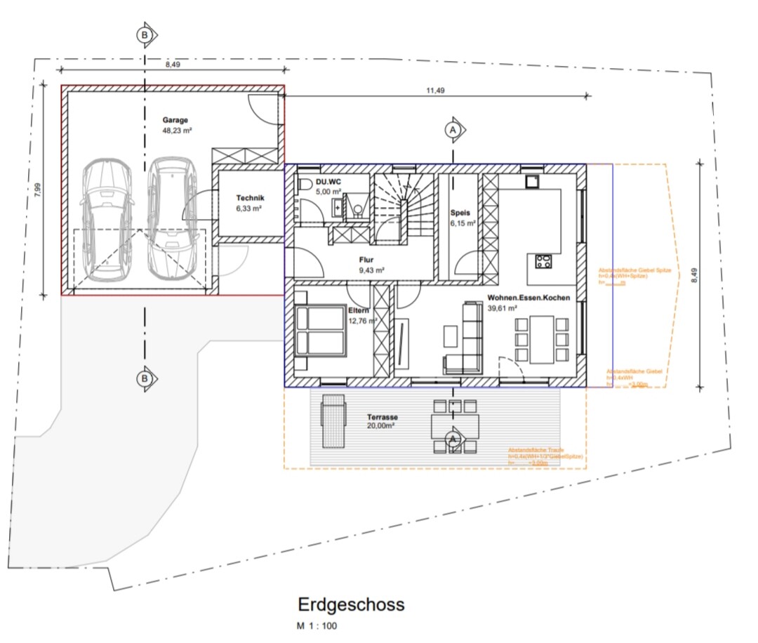

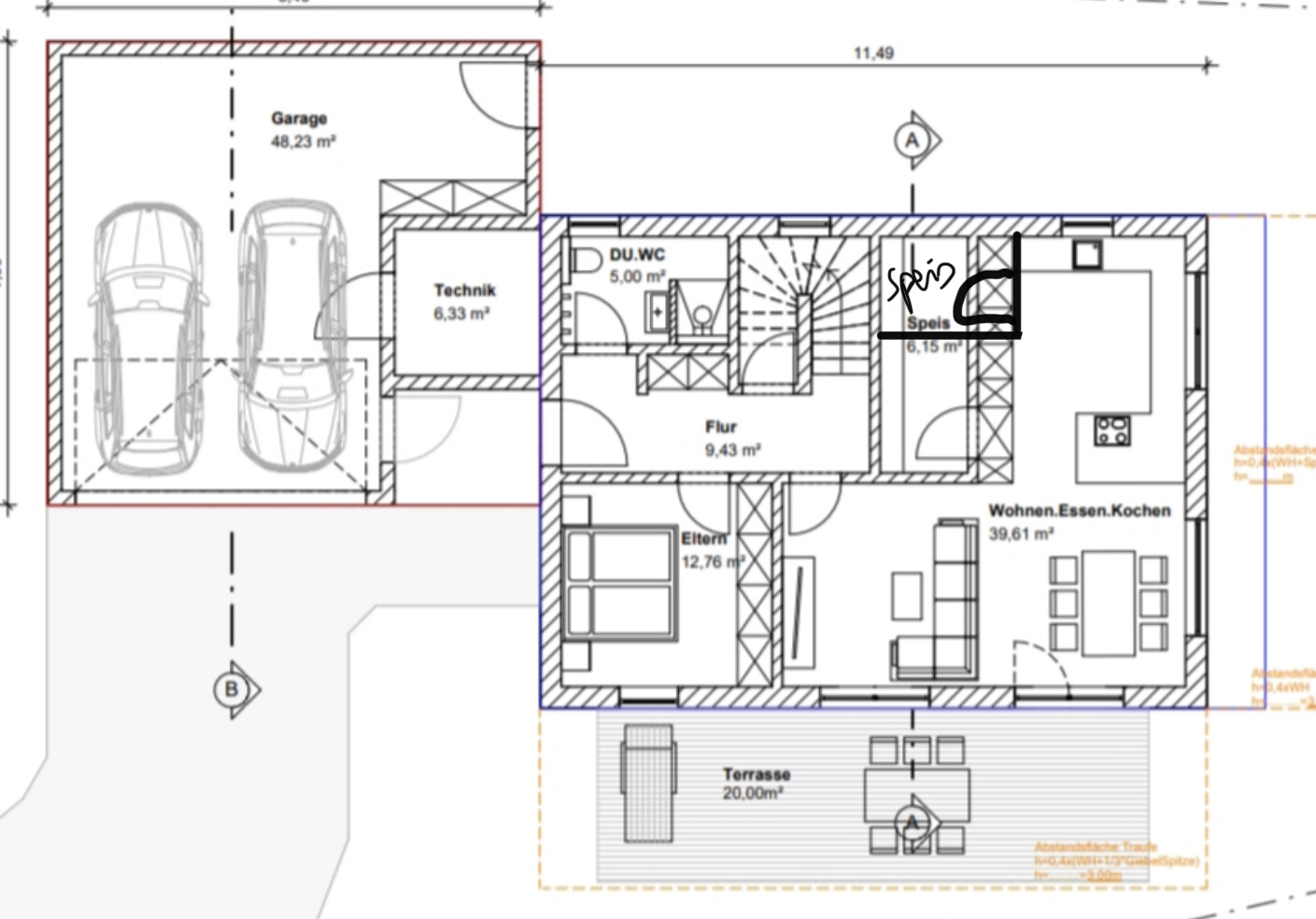

Ground floor floor plan: garage, technical room, hallway, shower/WC, master bedroom, pantry, living/dining/kitchen, terrace

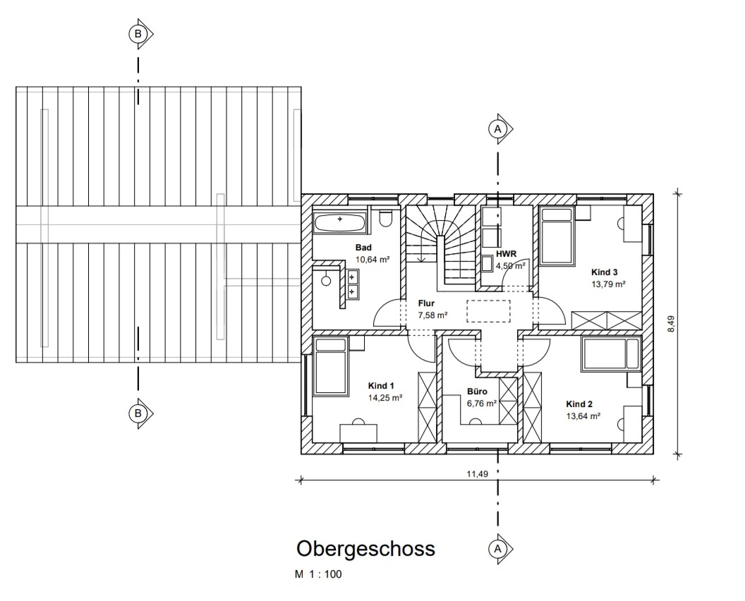

Upper floor of a house with hallway, bathroom, utility room and three children’s rooms plus office, floor plan

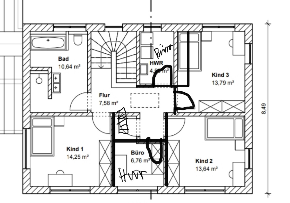

Good evening,
you definitely have a nice, compact floor plan that brings together your wishes on a small footprint, probably also due to building costs. However, the office upstairs seems a bit too small to me (it effectively has only about 4 m2 (43 sq ft) because of the corner for entering). I’m attaching some of my ideas below. I would move the office into the slightly larger utility room and put the utility room where the office currently is. This way, you avoid the unnecessary niche (where you can’t really place anything) and gain a bit more space in the hallway. I also find the floor plan downstairs a bit narrow, especially in the living area. That’s why I’d simply reduce and rotate the pantry. This would give you a spacious open-plan living area. Otherwise, it’s a good layout that makes the most out of the available space. I would build it without hesitation. Wishing you much success with your project!
Grundriss eines Hauses: Garage, Technik, Flur, Wohnzimmer/Essen/Kochen, Elternzimmer, Terrasse.
Grundriss eines Hauses mit Bad, Flur, Büro, HWR und drei Kinderzimmer (Kind 1-3).

Sorry, I have my doubts whether a professional was really involved here. There are several mistakes that a professional would never plan or should avoid.

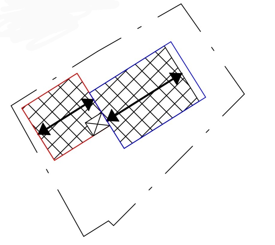

I do find the section of the development plan interesting though. What are the maximum exterior dimensions allowed for the house? Are they already fully used in terms of depth? What about for the garage?

I agree with @K a t j a.
The floor plan is a patchwork. In other words, the layout has been rotated just to fit all the customer requests. Even the door to the utility room is problematic. Without reason, it opens to the left side of the plan toward the cars, instead of opening up or down on the plan.
The pantry is also a great example: it uses a lot of space but offers very little storage.
This can be done much better.
I would redesign the plan by moving the staircase slightly to the right on the plan, directly next to the children’s room, which would create a better layout upstairs.
From there, you can plan the ground floor accordingly.

I am familiar with the program. However, dimension chains are possible, and some measurements are missing here.
If the thermal insulation thickness (TI) is 6.3, then the garage is too narrow to park two cars.
The TI must be included within the building’s thermal envelope. The open-plan living area is completely flawed, and with the location of the pantry (blocking access to the kitchen) and access through the quiet zone, it is not suitable for family living.
Upstairs, the utility room could, if necessary, be accessed through the bathroom, located at the bottom left of the plan. This would adjust the room layout accordingly and improve the office space.

It also bothers me that you have to go through the utility area from the master bedroom to reach the bathroom; later on, the young ones will be walking past there at night.
