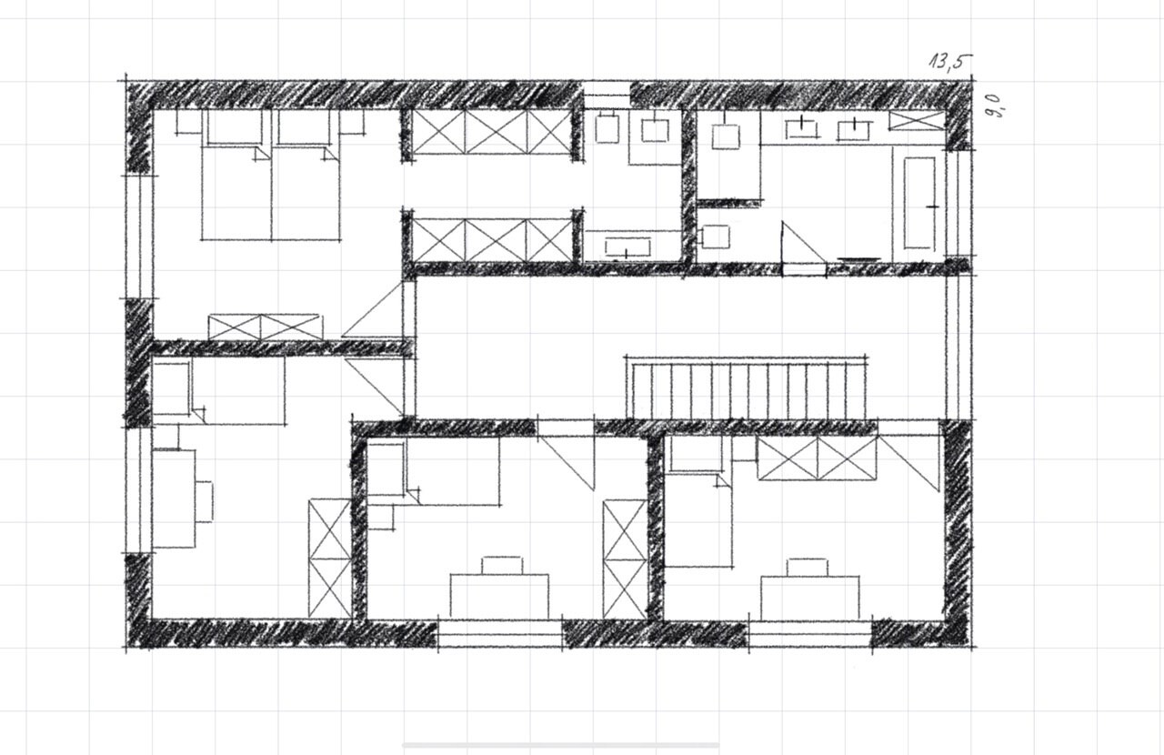

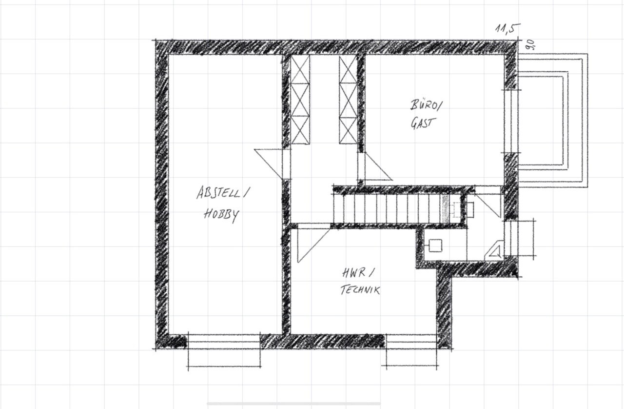

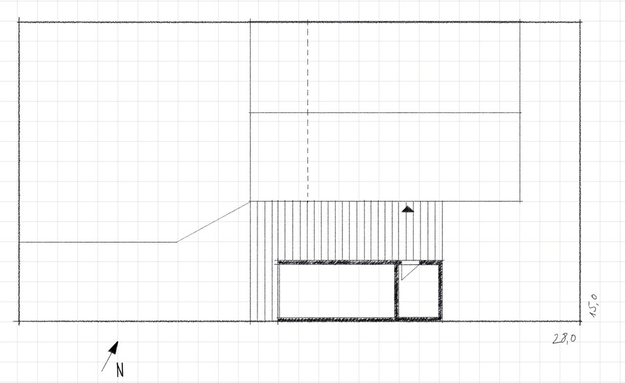

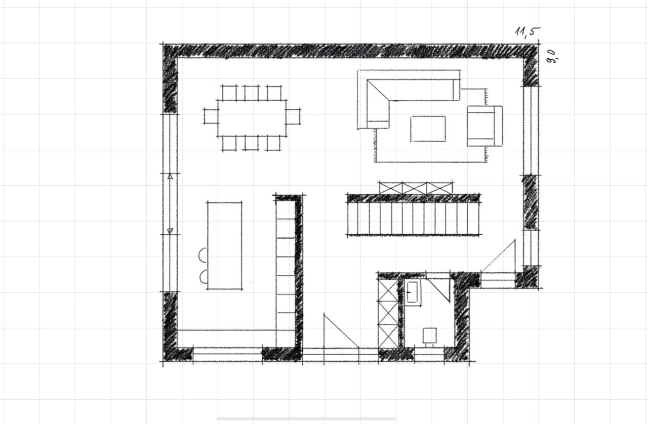

Hello everyone.
After following the discussions for a long time, I would now like to ask for your feedback.
As you can see from the questionnaire, the current design was created solely by me.
I can provide detailed dimensions later if the grid drawing is insufficient for clarity.
Preliminary notes:
- 1 square equals 1 x 1 meter (3.3 x 3.3 feet)
- The northern wall is on the boundary line and must be built as a fire protection wall.
- The walk-in closet does not require a window.
- The small master bathroom could either have a fire protection window, as shown, opaque due to neighbor regulations above the toilet, or a strip window installed at a height of 1.8 m (5 feet 11 inches) across the entire width of the room.
- Lightwell in the office is planned larger, but the window is not floor-to-ceiling.
- Upper floor windows are not floor-to-ceiling.
- An additional door after the cloakroom could serve as a "windbreak," but this could certainly be added later.
I look forward to your feedback.

The staircase you designed is unfortunately not in the same location on the upper floor as it is on the ground floor.
The problem is: If I move the staircase further towards the top of the plan to give the children’s rooms more width, the living room becomes smaller.
Currently, I have a width of 3m (10 feet) in the two children’s rooms and 4m (13 feet) in the living room. Both are still acceptable, but what do you think?
Additionally, you took away my access to the so far unmentioned "morning coffee spot."
So, the idea was to enjoy the morning sun in the lower right corner next to the WC.
Is the staircase planned on the left or right side?
The staircase itself should be a bit wider: 1 meter (3.3 ft) for the stairs plus 20 cm (8 inches) for the wall (a load-bearing structure is probably unavoidable, so at least 17.5 cm (7 inches) plus plaster on both sides). This will make the passage quite narrow, so it’s better to reduce the size of the bathroom and the corner by about 20 cm (8 inches) downward.
I would suggest adding a separate exit to the bedroom/dressing area and installing a sliding door for the dressing room, so after dressing you can go straight into the hallway without waking up the person still sleeping with light and noise.

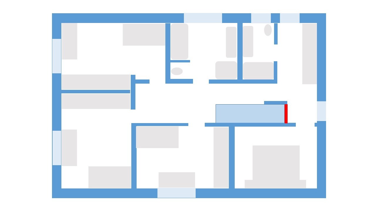

I actually find the plan quite ideal. I would only "reverse" the direction of the staircase at the top. This provides more circulation space at the "landing" and directly accesses 3 out of 4 doors. In the current layout, you reach one door quickly but have to walk around to get to the other rooms.
Basti2709 schrieb:
I also like the floor plan itself, but the staircase takes up too much space. A half-turn staircase would work much better here. That way, for example, the children's rooms could be slightly larger. However, for children, a staircase with uniform rectangular steps is much better and easier to manage early on... Especially if a third child is expected, it’s important that the older ones can use the stairs independently. (Being three on a staircase where the steps are narrower on one side is much harder.)
I think my children would love being able to enter the living room from both sides and would probably run around in circles all the time. The hallway is actually the preferred play area anyway. Not the children's rooms. Definitely not alone in their rooms. So having an extra square meter there is not really necessary.
