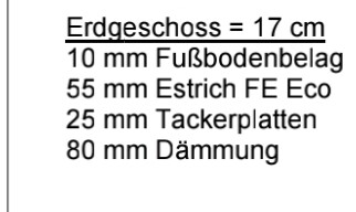

We have 130 mm (5 inches) of insulation under the screed, consisting of 2 layers of 50 mm (2 inches) insulation with a thermal conductivity of 0.032 W/mK and a 30 mm (1 inch) fixing mat. First, a complete insulation layer of 50 mm (2 inches) was installed, then the plumbing and heating installations were laid on top. The second insulation layer was installed crosswise. This means all hot water pipes are surrounded by the pipe insulation (single layer) plus at least 50 mm (2 inches) of insulation layers around them. This is the floor construction. According to the external site supervision (2 people with a total of more than 60 years of experience), everything is excellent.
Hausbau 5528 Apr 2022 20:30Neubau2022 schrieb:
This is the floor structure. According to the external construction supervision (2 people with a combined experience of over 60 years), everything is perfectly fine.I can only repeat myself. Surely, everything will be done correctly. But actually, it can be done significantly better with simple means. Can you please already provide some information about the underfloor heating? Has a room-by-room heating load calculation been carried out? What are the spacing intervals for the underfloor heating? What is the capacity of your heat pump?

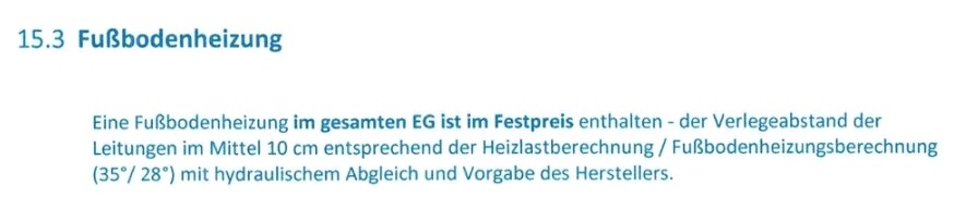

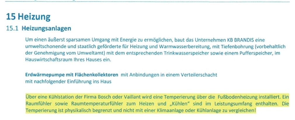

Could you please already share some details about the underfloor heating? Has a room-by-room heat load calculation been done? What are the pipe spacing for the underfloor heating? What capacity does your heat pump have? Here are the details from the construction specifications regarding the installation and the heat pump. It will be the Bosch model: Bosch Compress i7800 LWM.
Hausbau 5528 Apr 2022 21:52Neubau2022 schrieb:
Here are the details from the construction specification regarding the installation and the heat pump. It will be the Bosch model: Bosch Compress i7800 LWM.I strongly suspect that you have not yet familiarized yourself with this subject. After your response, you will receive a standard underfloor heating system. Why? Because you did not answer a single question from my last inquiry. You are relying on 60 years of professional experience.N
Neubau202228 Apr 2022 21:55Hausbau 55 schrieb:
I strongly suspect that you haven’t yet familiarized yourself with this topic. Based on your answer, you’ll end up with a standard floor heating system. Why? Because you didn’t answer any of the questions from my last post. You should trust 60 years of professional experience. Have you already read the attachments? They include the pipe spacing, mention that there will be a heating load calculation and hydraulic balancing.
We’ve also discussed this topic many times in the forum. I’ve actually been here for several years 😎
Furthermore, the company’s managing director is actively involved in development and teaching about heat pumps at universities. No, I don’t only know this because he told me. On this subject, I trust him.
Hausbau 5528 Apr 2022 22:03Neubau2022 schrieb:
Have you already read the attachments? They include the installation spacing, and that there will be a heating load calculation and hydraulic balancing.
Also, we have discussed this topic many times in the forum. I have been here for several years already 😎
Furthermore, the managing director of the company is involved in research and teaching about heat pumps at universities. No, I don’t only know this because he told me. I trust him on this topic. I have not seen a heating load calculation. There were only two excerpts from the scope of work specifications.
