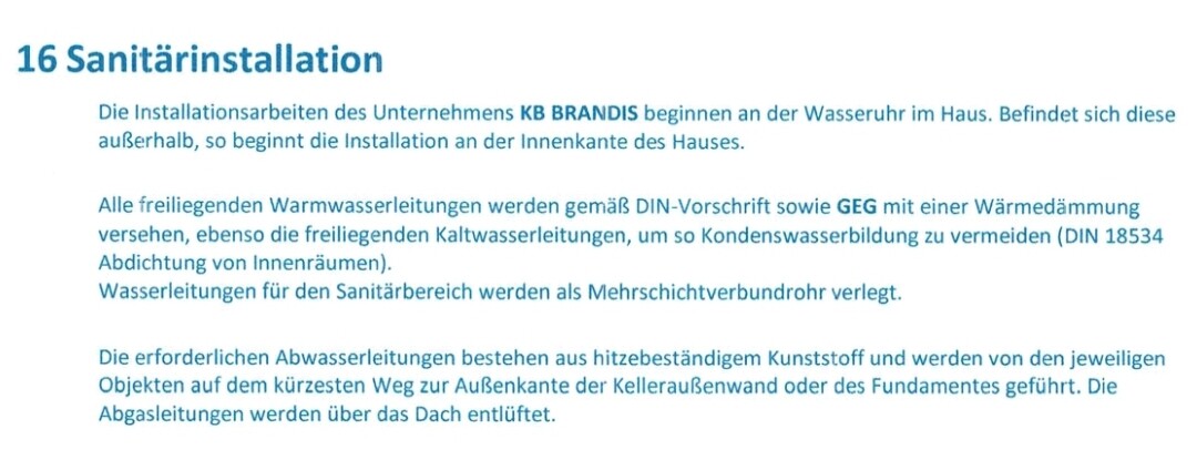

What insulation thickness do your hot water pipes and the supply and return lines have? I don’t think installing them directly on the concrete slab is ideal concerning heat loss.Regarding this, I found the following in the scope of work description.
Hausbau 5528 Apr 2022 20:07According to the building energy regulations, everything might be installed correctly, but I can’t assess the details. However, it can be done better than just the standard.
We have 130 mm (5 inches) of insulation under the screed, consisting of 2 layers of 50 mm (2 inches) 0.032 insulation and a 30 mm (1 inch) stapling roll. First, a complete 50 mm (2 inch) insulation layer was installed, and only then were the plumbing and heating installations laid on top. The second insulation layer was installed crosswise. This means all hot water pipes are within the pipe insulation (single layer) and additionally surrounded by at least 50 mm (2 inches) of insulation layers.
