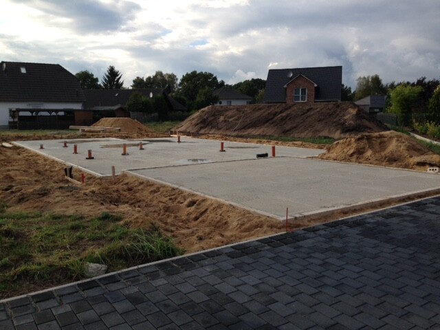

Attached is a photo showing the overall view.
The design was done by a freelance architect working for the company. The construction is carried out turnkey by a local building company. The site manager from the company is responsible for acceptance. Unfortunately, there is no independent expert on site.
