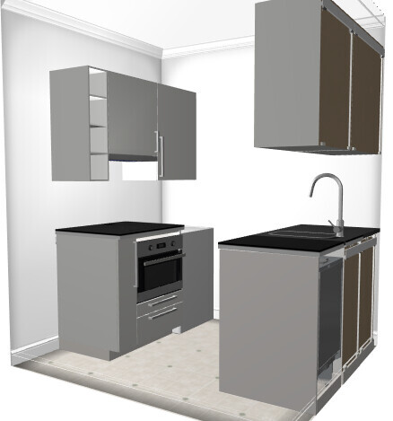

I’ve been a long-time IKEA fan but I’m new to the forum. I’m currently moving and planning my first kitchen. Naturally, I would prefer one from IKEA. However, I have realized that there doesn’t seem to be a solution for my problem. I’ll try to explain briefly.
I really don’t have much space for the kitchen. The longer side is 206cm (81 inches) and the shorter side is 140cm (55 inches). The connections for the sink are on the longer side in the corner. The problem is that the stove connections are on the very end of the shorter side. So basically, I end up hitting my back on the edge of the stove when I’m standing in the narrow gap at the sink (an architectural masterpiece!).
My idea: a 90x90cm (35x35 inches) corner solution with a corner base cabinet and a matching worktop for the sink. Then, directly attached in an L-shape, a 50cm (20 inches) wide free-standing stove. So not a corner with two 60cm (24 inches) deep countertops coming to a point, but a 90x90cm (35x35 inches) worktop with a straight “standing area” at the front (specifically for corner base cabinets with sinks). That might just work! On the long side, there would still be space for the fridge (50cm/20 inches wide) and a dishwasher (45cm/18 inches wide).
However, I haven’t found any 90x90cm (35x35 inches) corner base cabinets at IKEA, nor any option to order a matching worktop cut to size. Did I miss something? Other IKEA-compatible solutions for this issue would also be welcome!
Thank you very much!

IKEA-Experte29 Jun 2015 15:48Is there a window? (Height of the bottom edge?)
Does the fourth wall connect directly to the doors?
Are there any appliances besides the dishwasher?
Can the dishwasher be stored in the basement or attic?
About 80 cm (31 inches) in front of the stove is not much space, but do you want to move around while cooking?
Should it be a standalone refrigerator?
Do you cook large turkeys, or is a 45 cm (18 inches) high oven sufficient?
For cooking, you need pots and pans. Your plan doesn’t seem to include space for them.
P.S. With the camera, you should be able to set macro/close-up mode; then you can take clear photos of nearby objects.

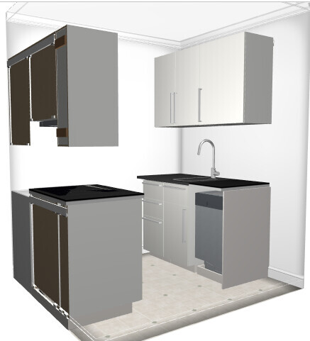

Lolalotte29 Jun 2015 21:22Hello Robi,
I really like your design! It would solve all the problems at once! I’m just not familiar with the connections needed for a kitchen. If the wiring and everything works out, that could be a great option!

By the way, the photo is NOT my design. That’s how the kitchen looks right now – with very old, ugly cabinets. I’ve agreed to renovate it when I move in. It’s just not acceptable as it is now!
And yes, that’s true! The camera has such a setting. I rarely use it and didn’t even think about it.
Many thanks to everyone here for the ideas and help!!!

IKEA-Experte29 Jun 2015 23:43L
Lolalotte30 Jun 2015 06:50Hello IKEA expert,
Thank you very much for this idea!
It also gave me the idea to maybe build around the corner after all – but without a corner cabinet, more like a “dead corner” (only using the countertop above as a storage surface) and placing the refrigerator where the stove is now...
Regarding your question: Unfortunately, there is no separate living room. There is only a combined living and bedroom of about 16m² (170 sq ft). If I squeeze the dining area in there, I would basically be eating in the bedroom right next to the bed.
