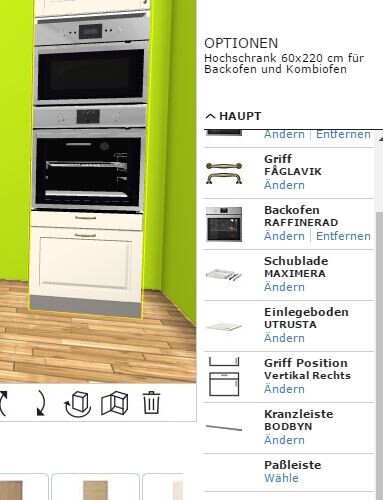

Hmm, I’m currently planning an IKEA kitchen as well, and it shows me the items when I select the tall cabinet for the ovens. If I click on filler strip, it places a small piece on the gaps next to the oven.
Okay... let’s take a closer look... I’ll have this situation soon too... I took a picture... there’s a gap above the oven. The parts list includes such a filler strip... but I still have a gap at the top. Probably the same for you as well.

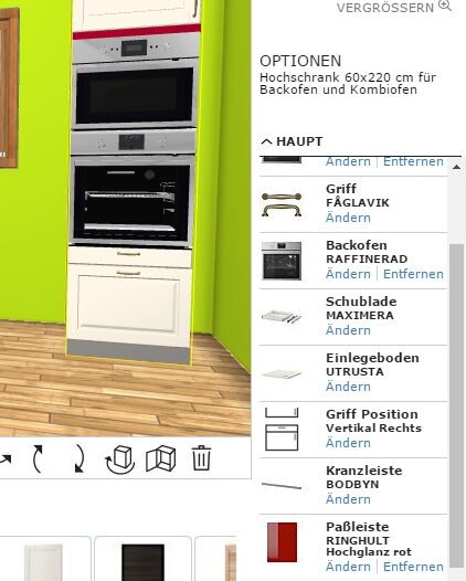

Now I selected the filler strip and intentionally chose glossy red. You can see on the second picture where the planner places it. The parts list says – Ringhult drawer front in gloss red.
So I assume that small plastic piece is only for smaller gaps or to cover the edge between appliances… or, as you said, for cut edges and similar situations. If the gap is bigger, you’ll need a matching 10 cm (4 inch) drawer front panel.

IKEA-Experte3 May 2016 23:09The compact ovens have a height of 4555 cm (1780 inches), so the HELANDE panel is too tall to fit into the gap. Therefore, the 10 cm (4 inch) drawer front is cut down to the appropriate height and then fitted with the Förbättra cover strip (another IKEA term that no one else uses). The assembly instructions explain this well.
