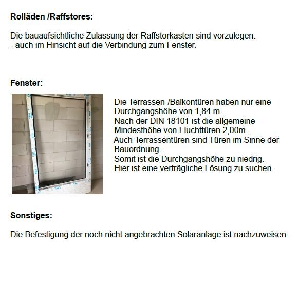

Today, the expert report arrived. Considering the hourly rate for the whole process, the report does not seem professional to me, nor truly helpful enough for me to work further with it... there are very few references to standards.
Honestly, I can't make much use of it. What do you think of the report? Or am I being too critical?

In our case, the report was more detailed.
The identification of defects and deviations was also justified with reference to DIN standards.
At the end, there was a list specifying who must provide what and by when.
Company X must provide proof of ...,
Company Y must carry out the specified corrections,
Proof must be submitted with photos,
Company Z is responsible for certain changes, with a scheduled acceptance inspection date.
I understand that you wouldn’t be satisfied with the report either. We used an expert witness approved by the court, and no one contested their findings. They also have a good reputation.
