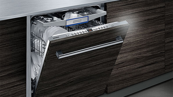

kindgottes924 Feb 2016 18:43This one would work without any tricks:
Siemens SX63D002EU
It is an extra-large appliance with a variable hinge, allowing fronts up to 800mm (31.5 inches).
Its price is still reasonable as well.
Siemens SX63D002EU
